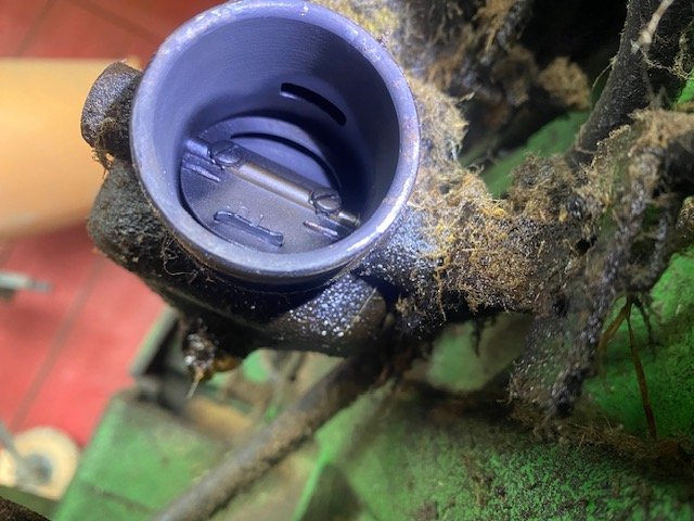

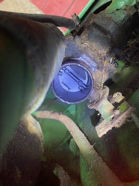

I took a look at the exposed choke in both the tractor that starts hard cold as well as the good one. The pinched-paper test worked fine on the bad tractor, and that little relief plate inserted in the butterfly is indeed present, is spring-loaded such that it returns to closed position but can be pushed open. This is the same on the 'good' tractor except that relief plate seems to move with less resistance and return to closed more readily than the 'good' tractor. I have attached two photos for comparison, although it is difficult to get a good picture. The 'bad' tractor had not been started since last September so I expected a challenge today. When I tried starting it with the choke out I got the normal hard start. However, I decided to manually 'choke' the air intake by removing the cover and blocking the tube with my hand. The tractor started immediately upon cranking. I am really mystified here as it is clearly a lean start problem but for the life of me the 'bad' tractor choke seems to be operating fine.

The choke is not closing completely as that’s what I see in the above photo. Not gonna start good like that. Get the choke adjusted properly.

If I'm looking at his photos correctly the tractor that starts "good" has the "loose" choke, WTH?

If he would separate them photos and tell us which is which would help a lot. Ya now I see it says good tractor with loose choke in the photo. Who knows.
so correct me if I'm wrong but the relief plate on the good one returns easier? id probably start there new choke plate. or even switch the carbs quick see if it moves to the other tractor that's the best thing about twins.

You are correct. The one that starts well is the one without the choke totally closed. I had that same question myself but there is zero doubt about that. The photos are labelled correctly. I assume that you would want the choke fully closed when the knob is fully pulled out so the 'good' tractor is not properly adjusted, yes, but starts fine from dead cold after 7 months.
I also believe that the 'good' tractor photo is slightly misleading as the angle of the photo is lower than the throat of the intake and makes it look like the butterfly is more open than it is. When I manually inspected the 'good' tractor butterfly valve it looked quite closed with the knob fully out.
