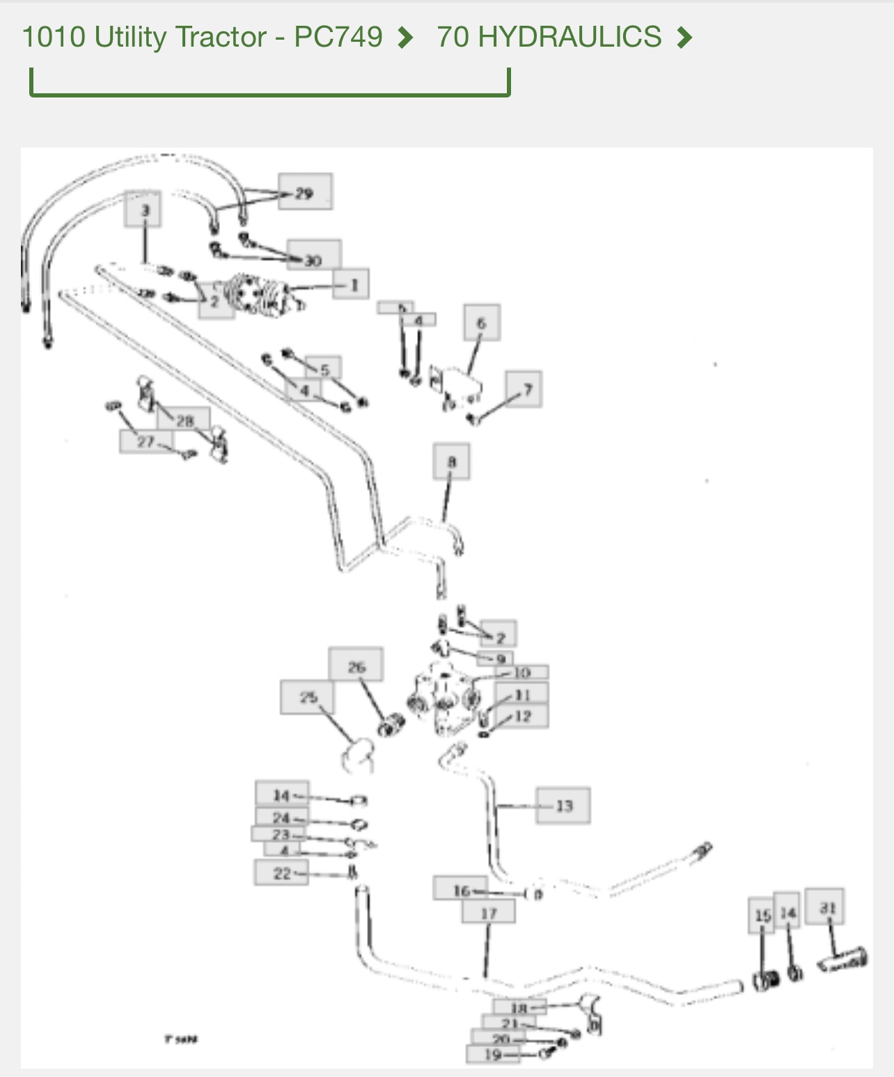

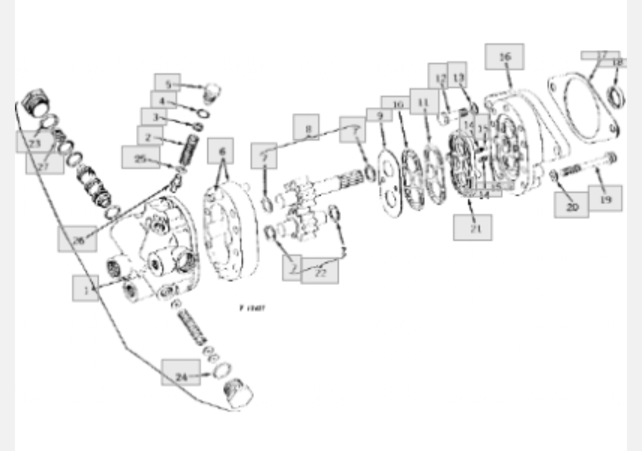

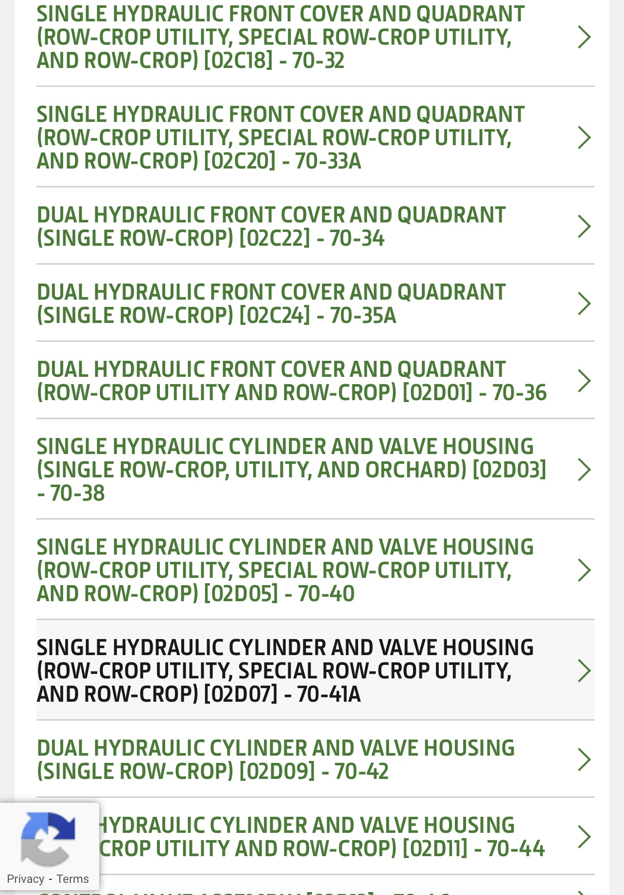

I am adding a model 36 loader to my John Deere 1010 and it does not have remotes . I need to know where I can pipe in for the pressure and return . It looks like I can under the seat but I am not sure which fittings to use . I see in the forum that some one had done this and would send pictures of what they had done. This would be very helpful . Thanks, Rub1979

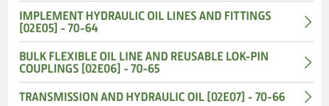

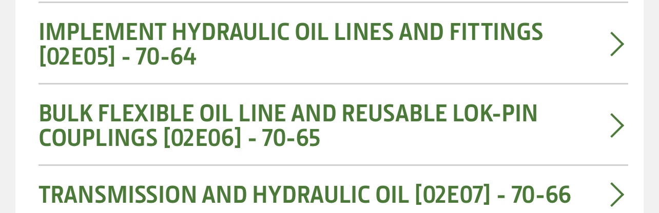

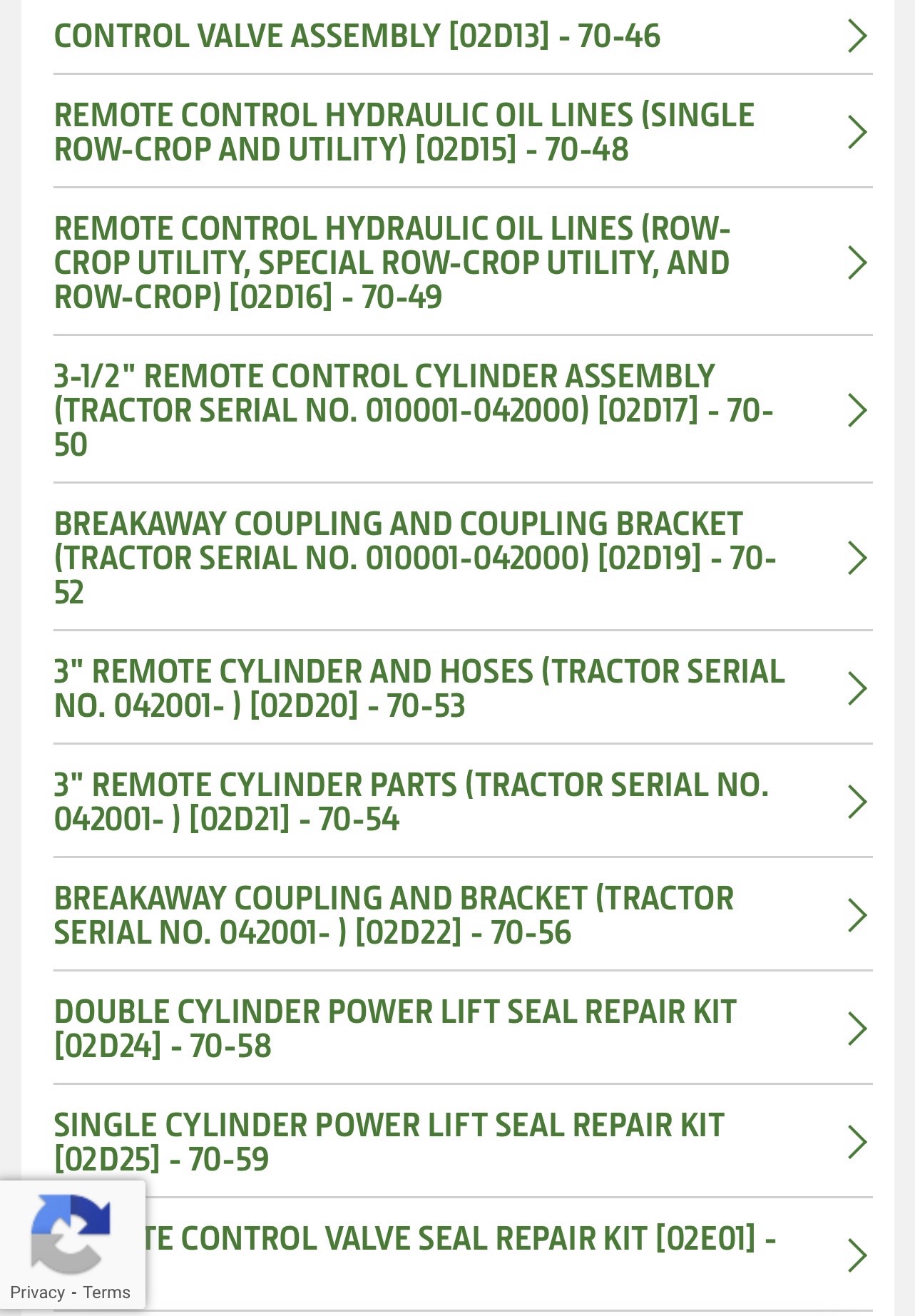

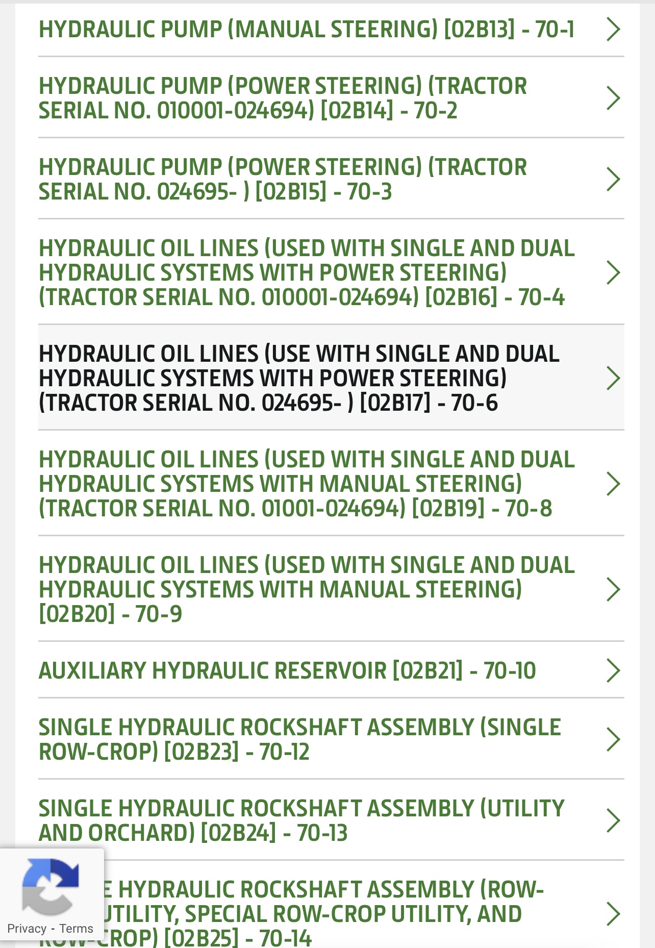

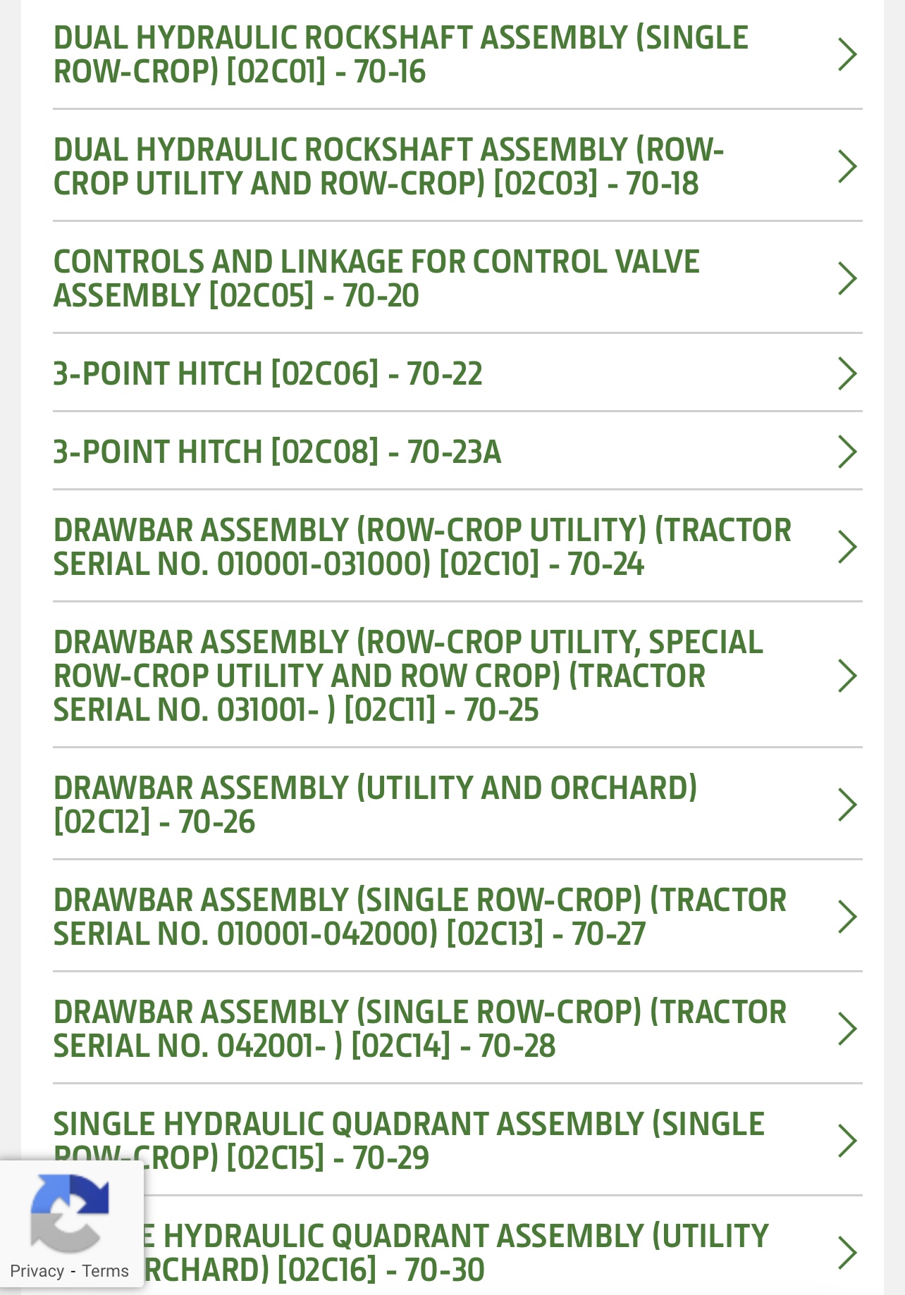

Here is a link to figure out which chassis and basic tractor info .
Also a list of a various different chapters in the hydraulic section of the parts book .
Odds are as long as a relief valve is protecting the open centre pump . Taping in and out of the rock shaft supply line will work most of the time .

Taping into the power steering will result in low flow , low pressure and no PS while lifting the loader .
Rare to find a 1010 with PS .

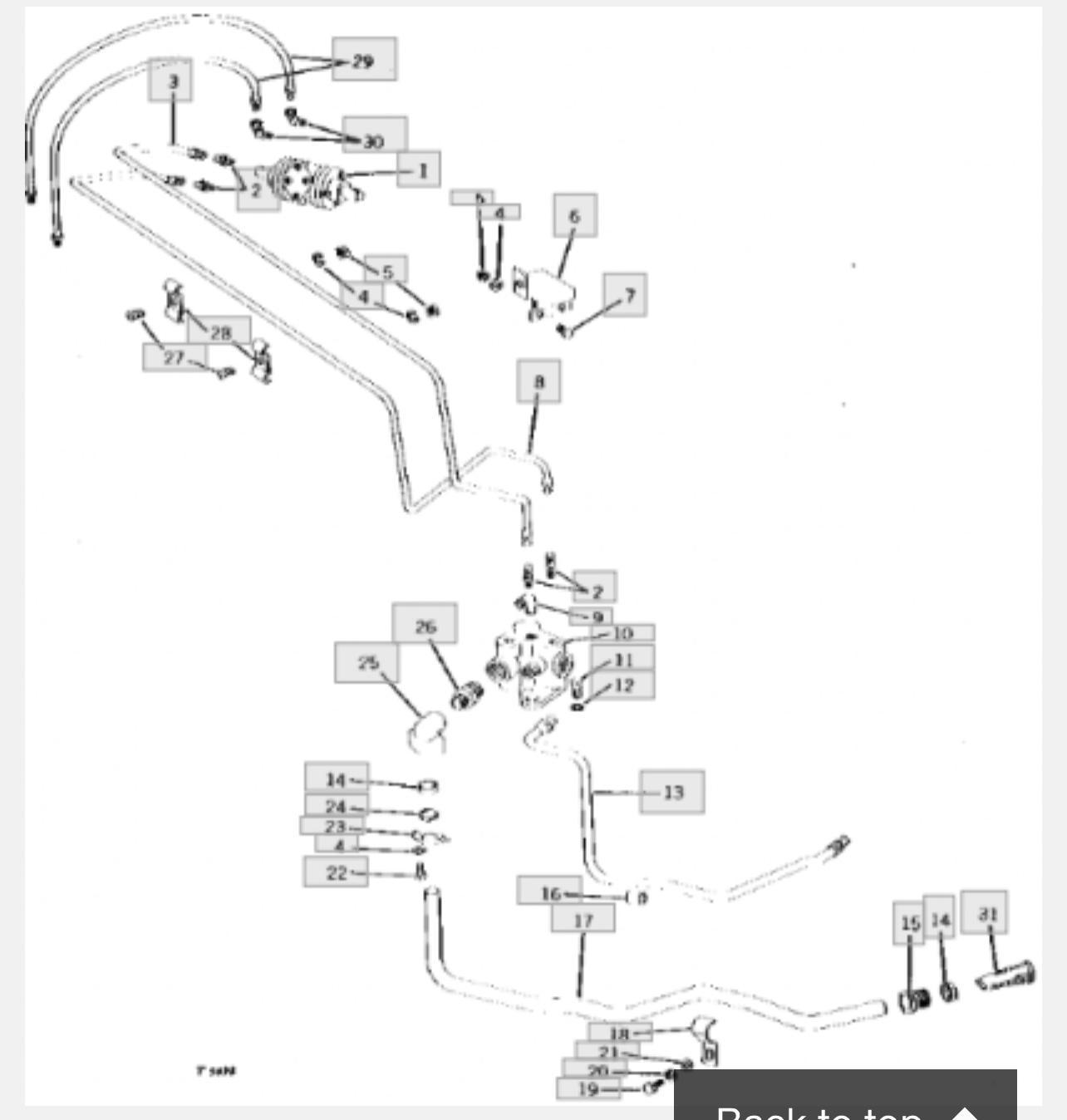

Need to get in and out of the high pressure line supplying the rock shaft .
Hydraulic pump has to be protected by a relief valve prior to or in the loader control valves or that rare pump with difficult to find components will bust .

The line between the hydraulic pump’s divert valve and the rock shaft control valve(s). For the loader valve in and out . Plus a 3rd line from the relief valve to sump .
Small diameter lines are pressure and large diameter lines are the return from sump to pump .

The rock shaft lines are tapped for the loader after the PS diverter valve

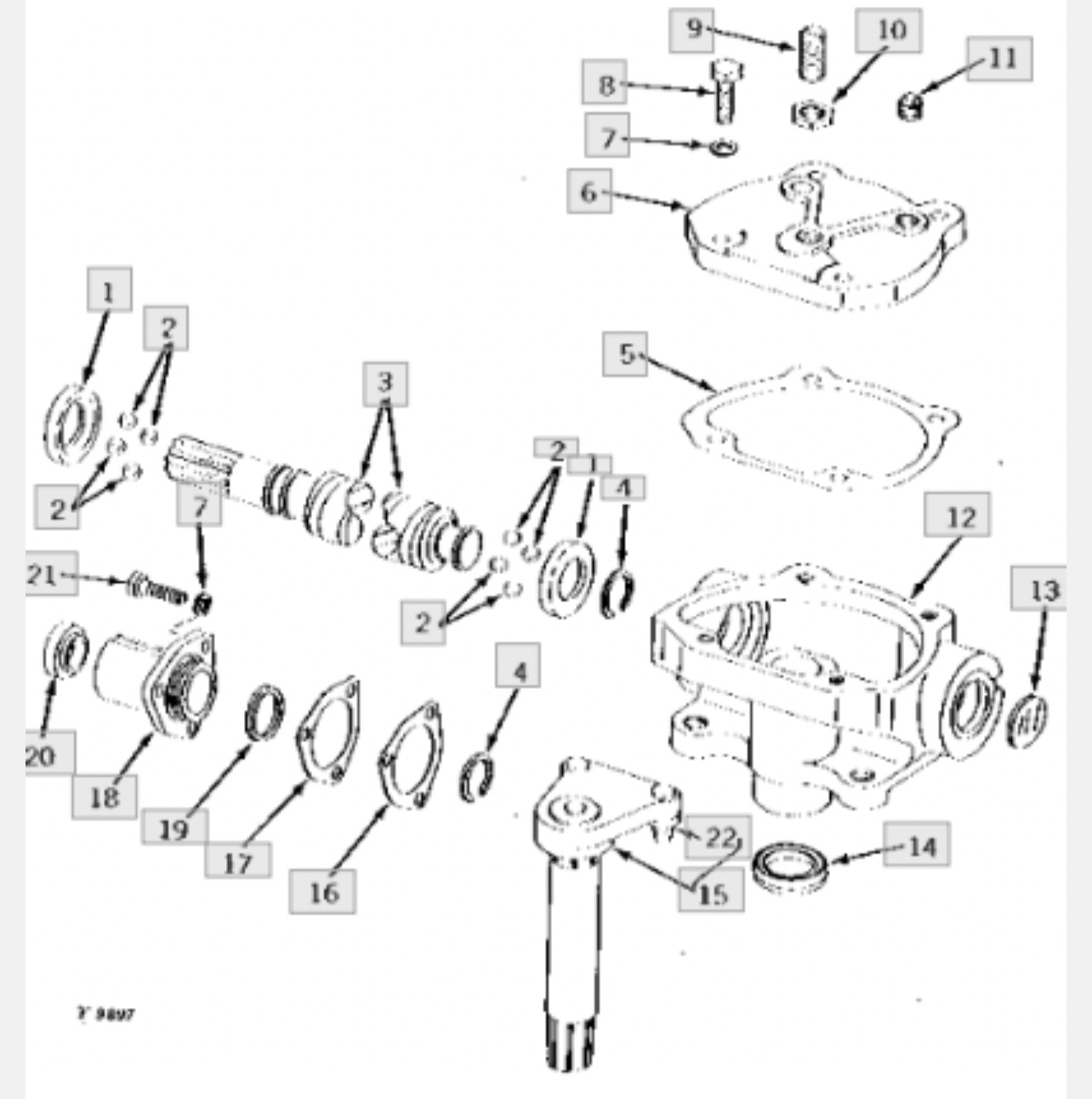

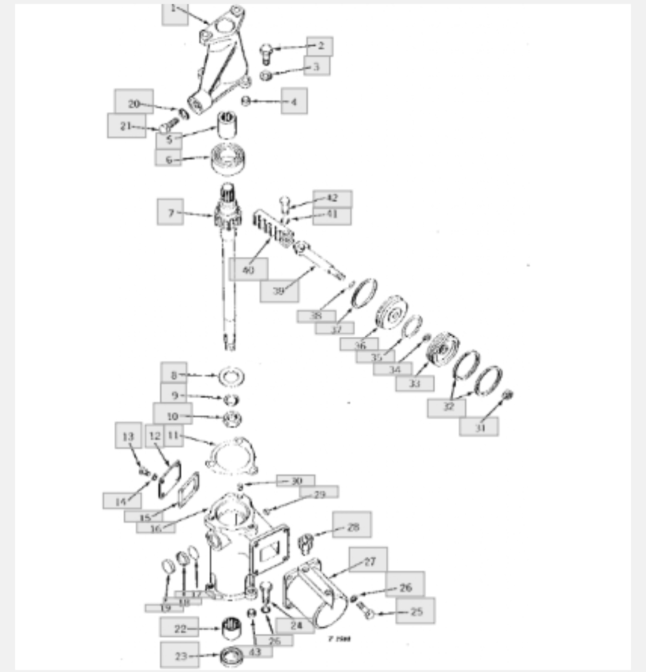

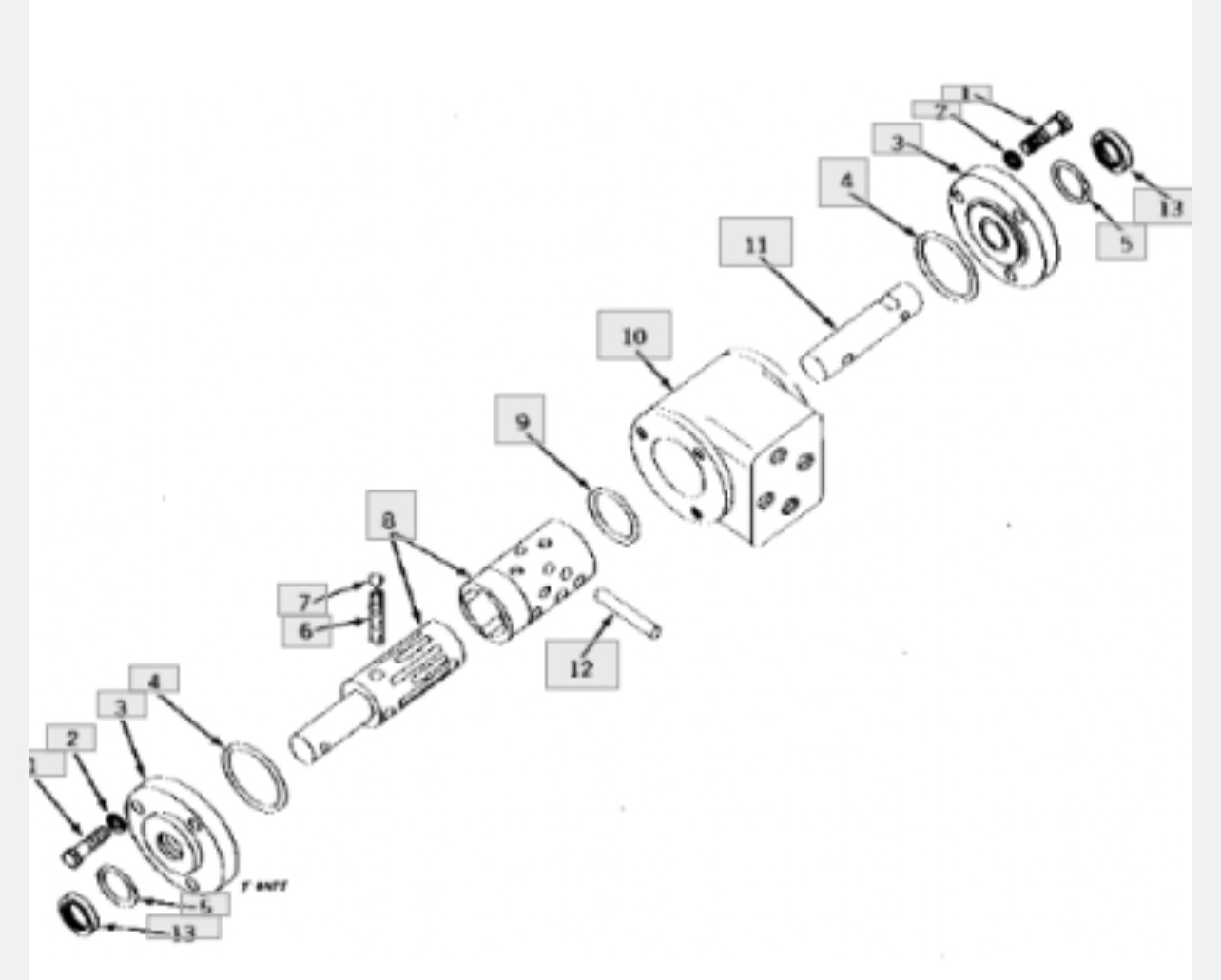

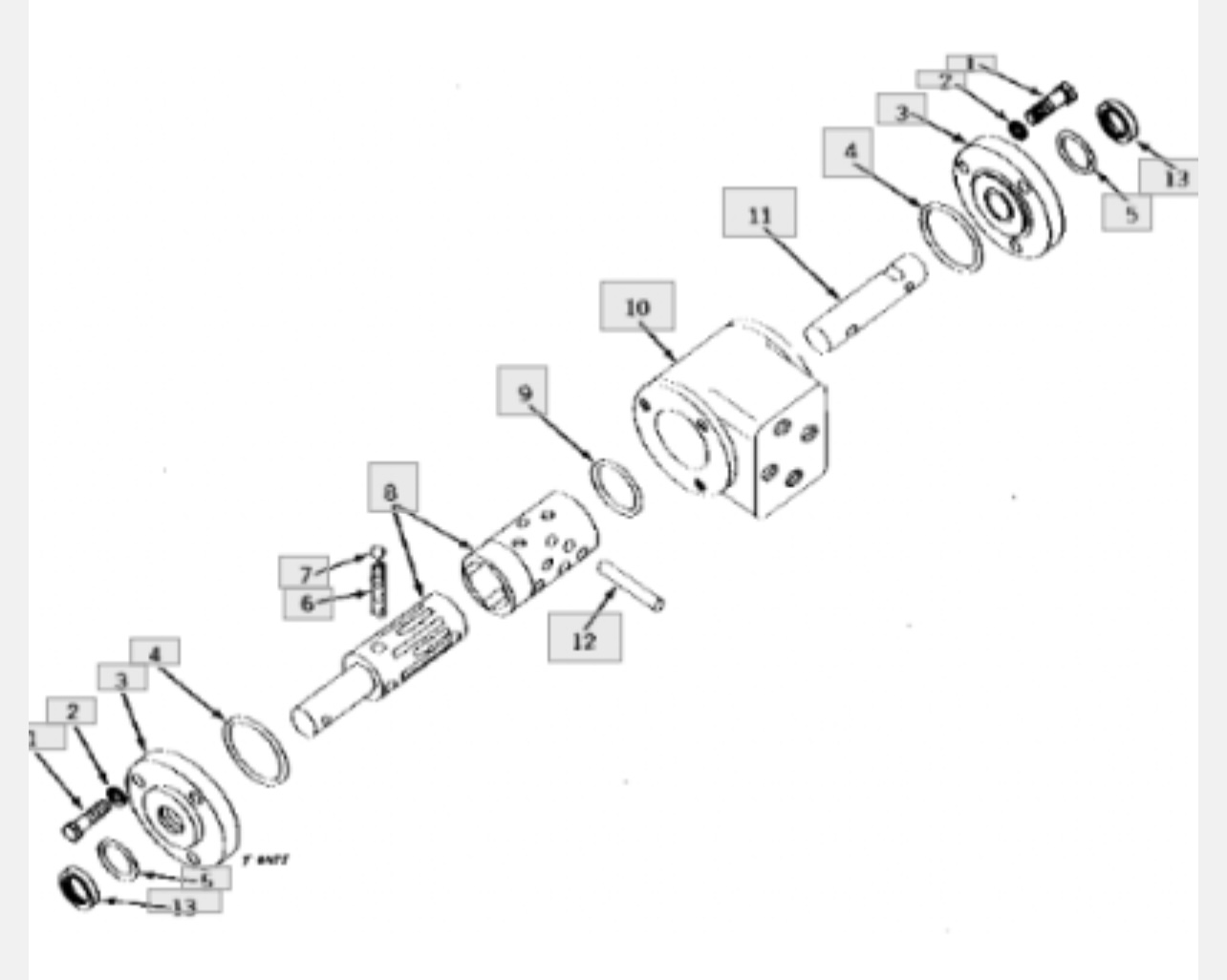

Some parts book images
