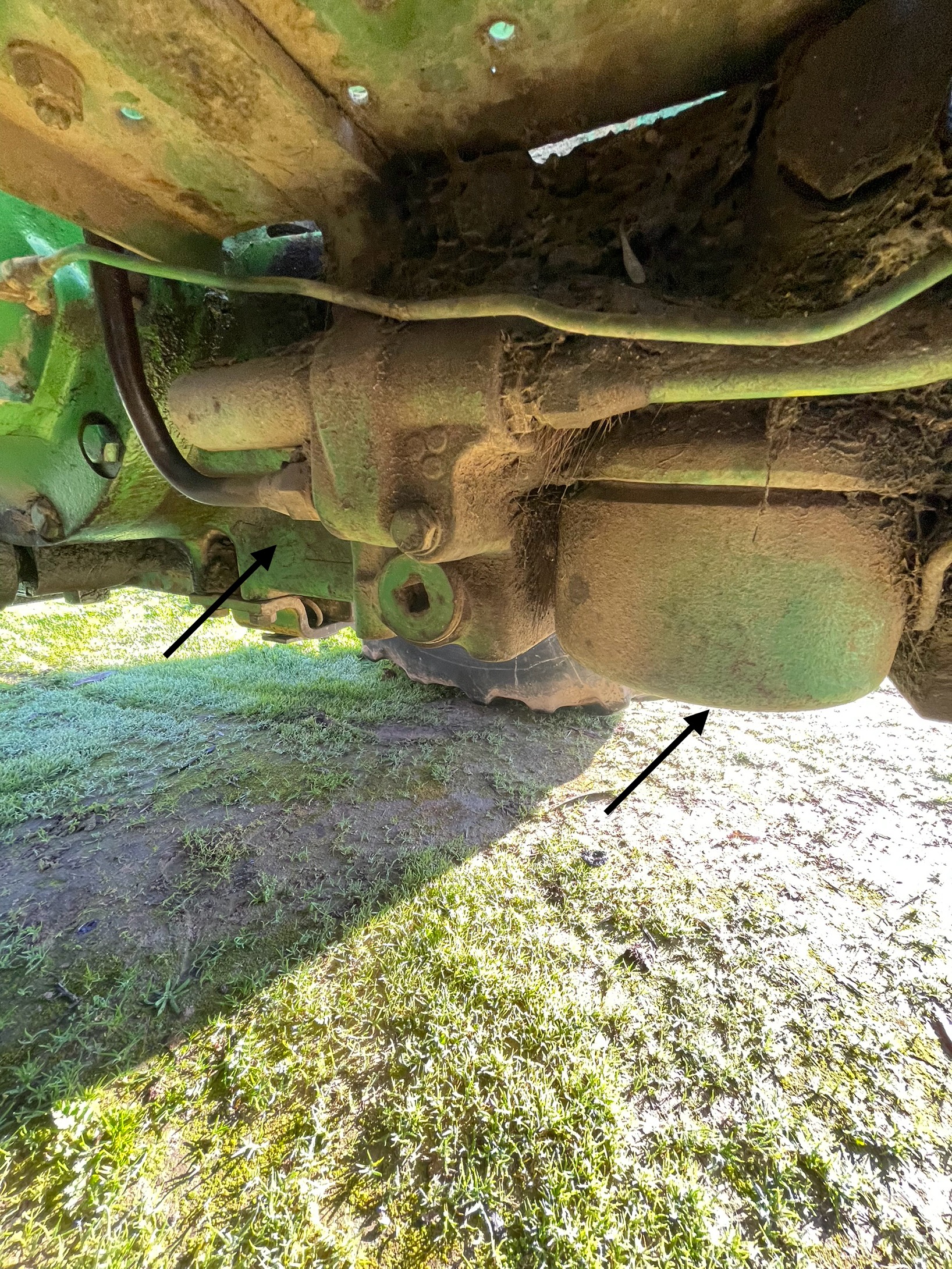

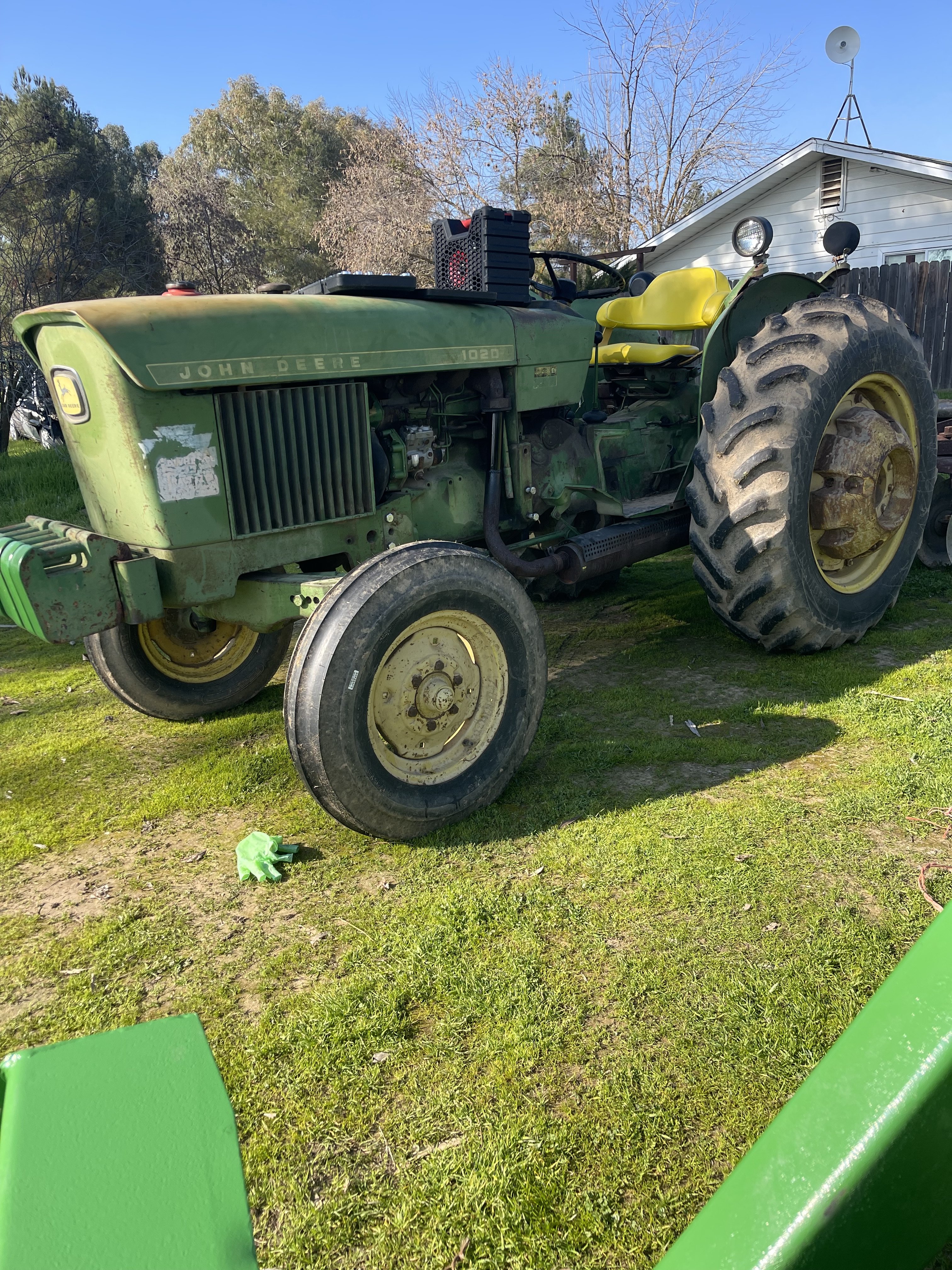

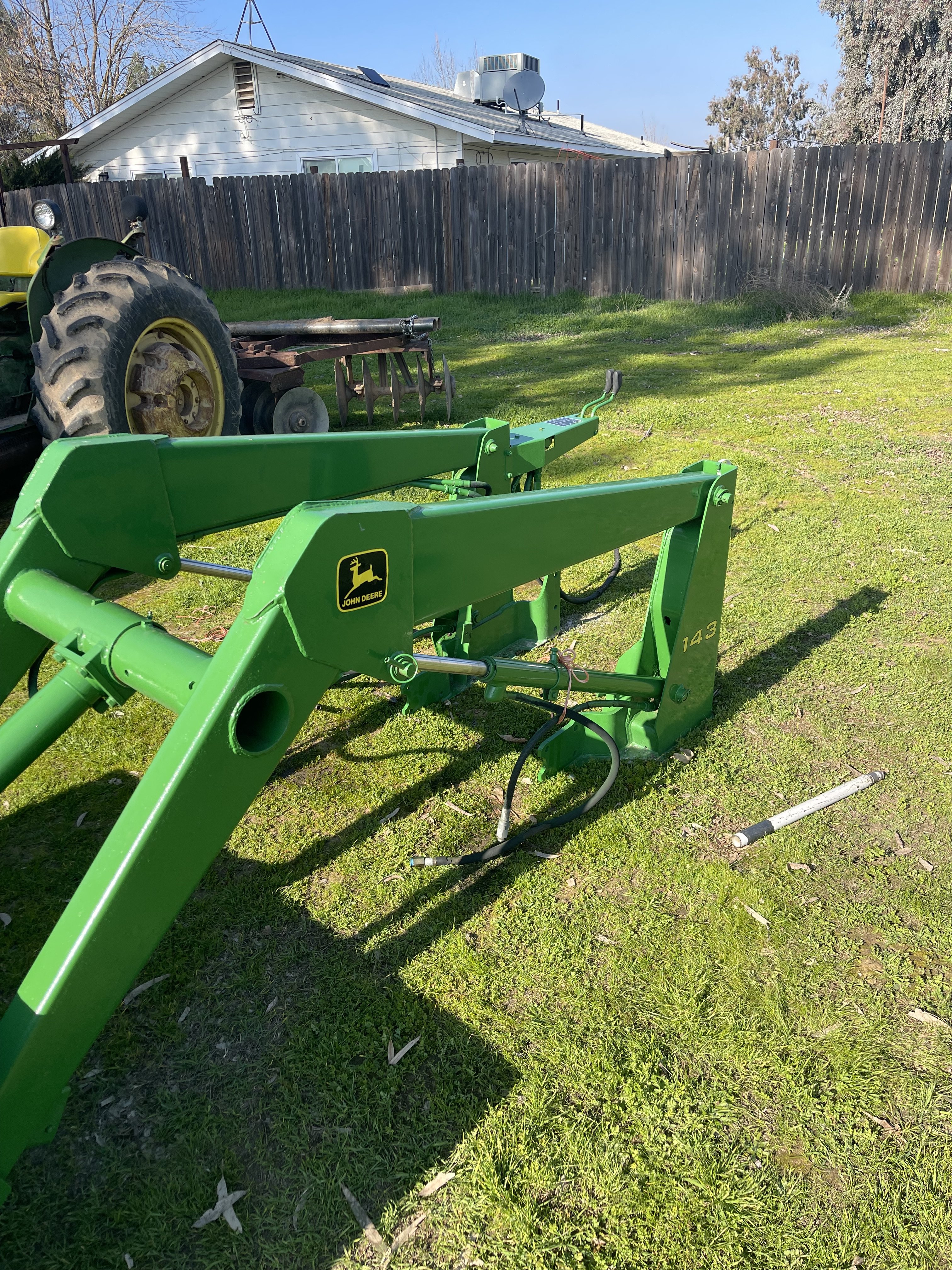

Hi, I own a John Deere 1020 tractor about the tractor without the loader. I recently bought a John Deere 143 loader that I need to attach to the tractor. I have the 143 loader manual, but I am confused about where certain hydraulic lines go. I only have one auxiliary attachment in the rear help if you can thanks in advance.

I’m assuming that these are the two connections that I need to put the adapters on one looks like it’s the transmission filter that I need to put the adapter on mine is not on the side as in your picture mine would be on the bottom. am I writing this assumption?

Ok the bottom bolt is not a drain it what holds the filter in place. Do I need to buy a filter cover with the side adapter?
You need a filter with the port on the side or modify that one. You have the pressure control valve. You need to tee into the line going to the SCV, as in the 2030 picture I posted, not plumbing like the 2020 I posted or like Briar Hill Brittanys posted of his 1020. Tx Jim may be here with all the part numbers for the fittings and cover needed before I get a chance to look them up. There is a heavy cast filter cover (like the one you have now), and there is a lighter steel one now i believe, I haven't seen one of those yet.

According to this parts catalog the bolts should be same length for either hyd filter cover. I suggest removing to swap bolt from original filter cover to ported filter cover. Actually Jim I became aware of the optional, cheaper hyd filter cover while surfing the internet long after I left employment at JD dealership & I have no personal experience using it.
