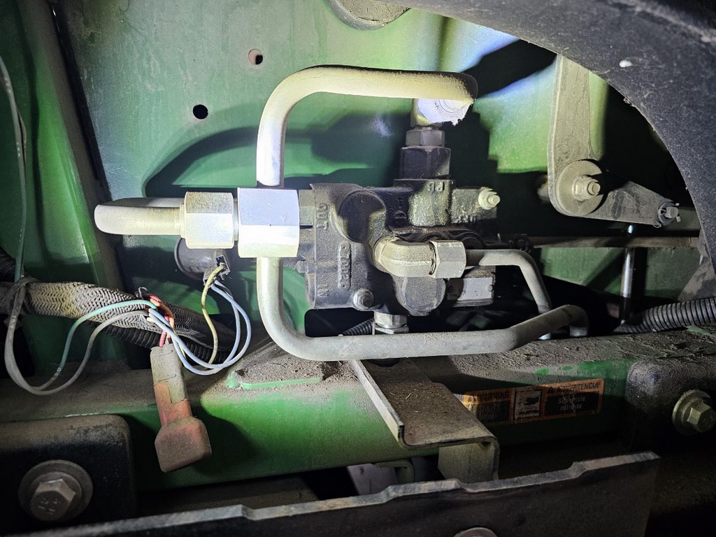

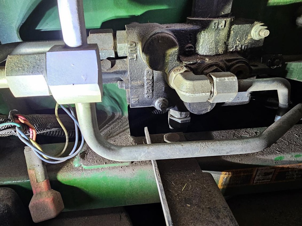

This is the only control valve that I can find underneath the floorboards and where the controls come down to.
Did you read the info I posted as to how the system works?
Valve in your photo is the deck lift valve.

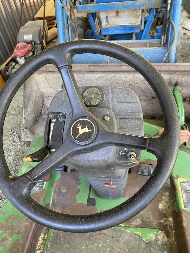

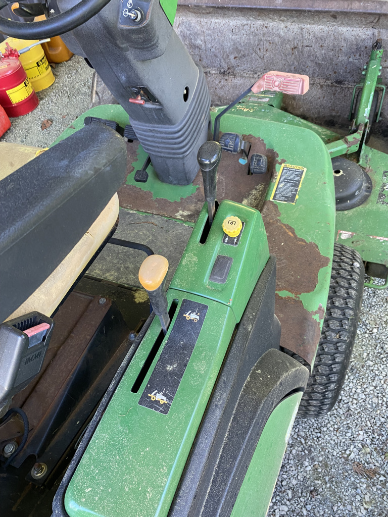

So this is what my helm control looks like. Sitting in the seat as well as a shot from the side. I don't see that control knob that is in the schematic from John Deere. The Black handle lever is the one that I push all the way forward to activate the system. It determines when pushed all the way forward. I am assuming that it activates that valve that I have not found yet. When I get home from work I will dig deeper underneath the hydraulic lift valve and see if I can find it. I guess just follow the linkage.

Apparently you just have the "standard" hydraulics, just like my 1435 WITHOUT the "weight transfer option".
The "fully forward" position of the lift lever is simply "float".

Likely you won't have to disassemble much to check out the detent for the float position, it would be in the endcap on the valve that the arrow points to.
I'm not sure if the two hex plugs are for assembly purposes or possibly to adjust the "strength" of the detent.
The parts catalog doesn't show a parts breakdown of the valve, but likely there's some strong little springs and two or three little steel balls in there that will do their best to launch across the shop and get lost! You mentioned it has been previously worked on, maybe the last guy in there didn't recover the launched detent balls!
