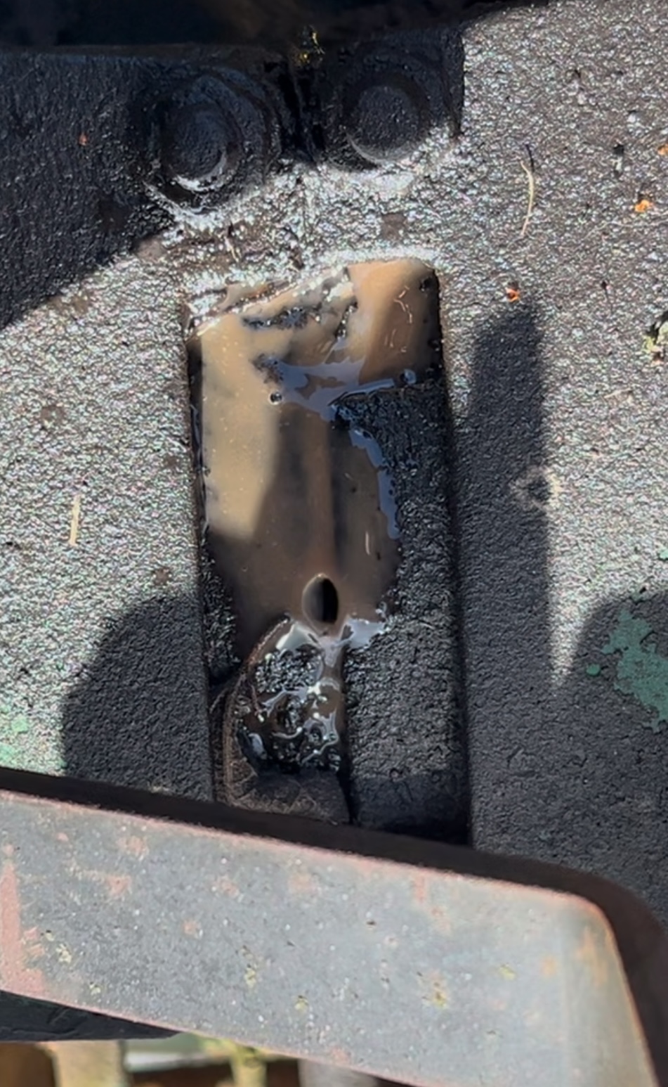

Howdy everyone! I have a JD 2630 with a 146 loader on it. The tractor is leaking oil in the normal spots after a life or two of hard work and of course also hydraulic oil at the remote couplers while the control valve also leaks. This is the two lever style and between those lever’s is a hole from which hydraulic oil mixed with who knows what bubbles up when the loader is in the closed position (all down).
Any thoughts on how to identify my specific model for the control valve and whether it can be repaired or what would y’all’s recommendation be?
Thanks in advance!

Hello Ron, welcome to the posting side of YT! I would suggest starting your own new thread. Give you same description. Photos of the valve, any numbers or wording on it and the leak location would go a long ways towards solving your issue.
