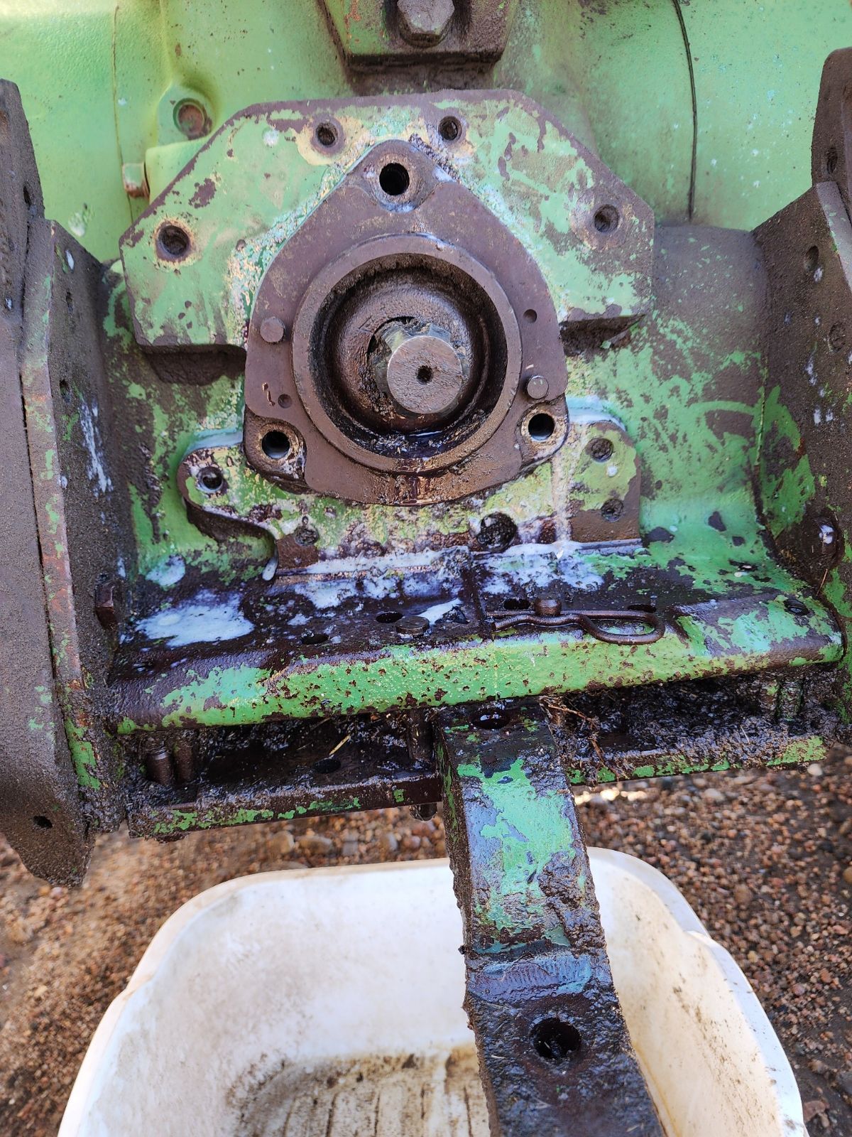

PTO shaft cover has 2 small bolts that are welded to the plate. What are they bolted to and can I cut them?
Welcome to this forum
I don't see the bolts that you referred to. Are you referring to the 2 dowel pins? If your tractor has a pto control lever on LH side of trans case it needs to be held rearward if removing rear pto shaft
