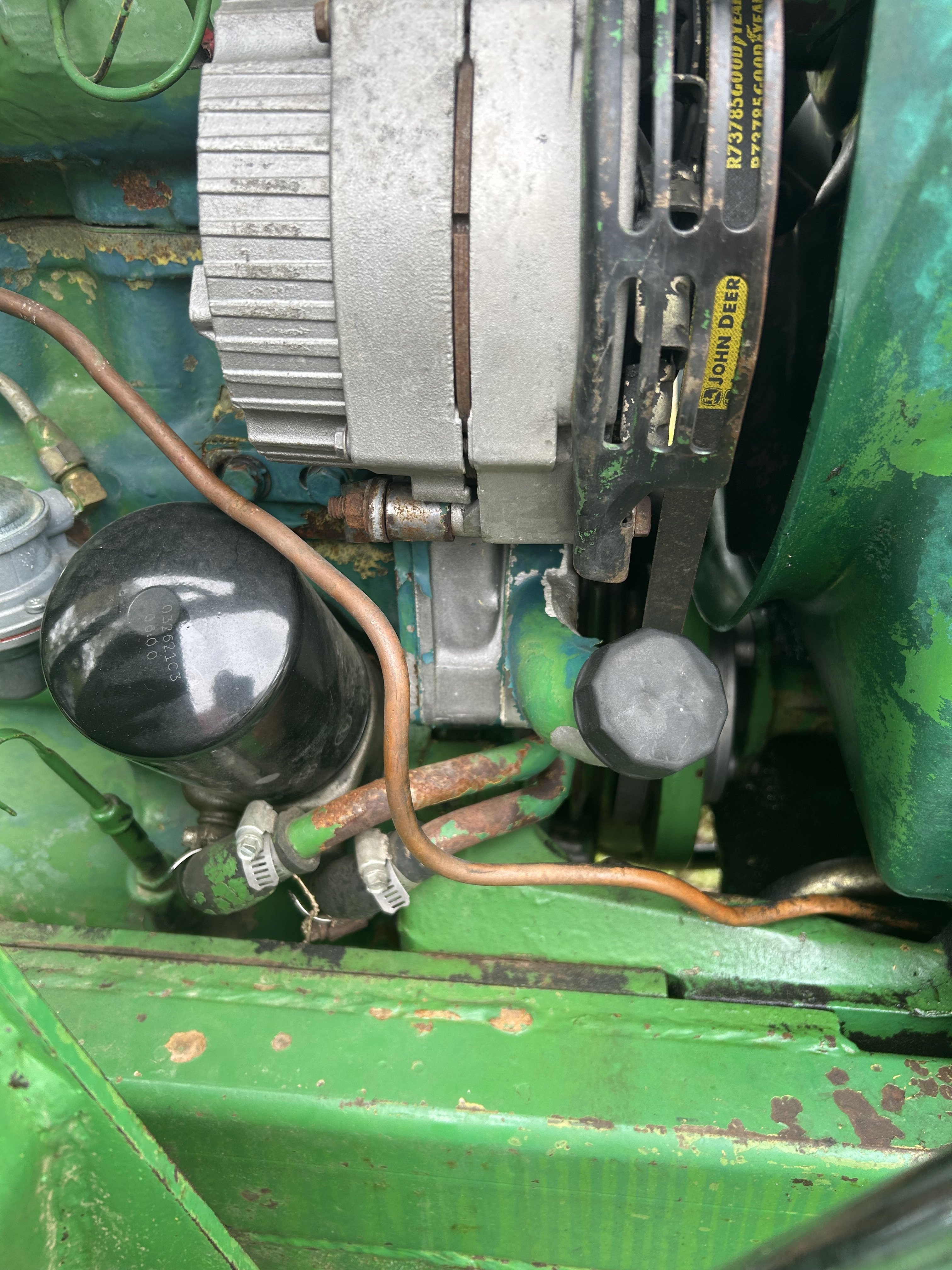

Reconnected hose and added fluid in the rear There is a cap on what I believe is the power steering pump. Should fluid be added there too?
No cap on 2940 power steering valve housing to add oil. JD tractors of that era utilize trans case as a hyd reservoir. Hyd oil reservoir filler hole is located behind seat & oil level dipstick is on RH side of trans case with red knob behind right rear axle. Hyd oil used should be Hy-Gard or it's equivalent that meets spec's of J20C

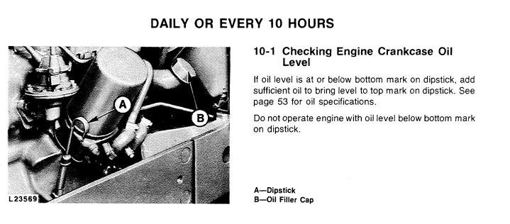

That cap is for adding oil to engine. Sounds as if you're a good candidate for a FREE 2940 operators manual that can be downloaded @ the following link. https://techpubs.deere.com/en-US/Search/Equipment

Noise being made when hyd functions are at idle IE not being used is normally caused by worn hyd pump drive coupler located between engine crankshaft & front hyd pump

I am going to guess the coupler in under the front end where the drive to the pump is has the bushings out. Letting it knock on the pins. It has a bolt on the splined section you have to loosen. Then with the bolts out of the drive bushings the coupler will slide forward change bushings and reset the drive coupler, tighten back up all bolts loosened and probably your knock will be gone. Left to knock will ruin the shaft coupler and then it gets real expensive real fast since you would need a new pump drive coupler and the cheap bushings that would have prevented the whole problem in the first place. Takes a couple hours to do if nothing is removed but the bushing job. I did ours when I replaced the water pump lots of room to work then. Could do it from the top also.
