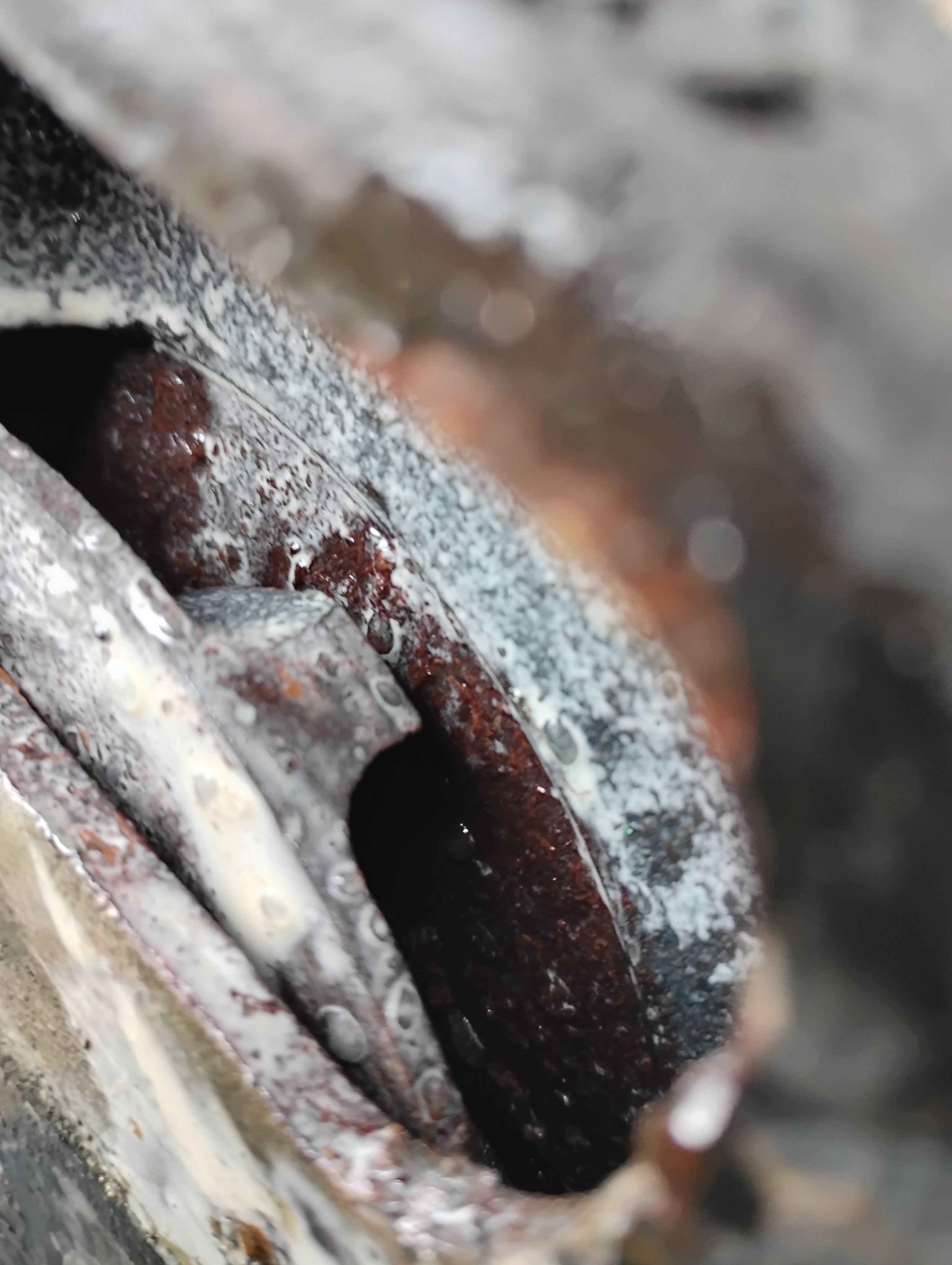

Well I put the water pump from the 4020 on the 3010 and there's still absolutely no movement of fluid. So I guess I'll be looking for a new one.
The pump I took off is pictured below and if you look close you can see the large space between the impellers and the casing. The second image is that one off the 4020 and although rusty it turned really easy, has no slop in it and impellers that pretty much meet up with the casing. Still nothing though.

Look as well for ruptured hose interior they can totally block flow. Jim
Oh really? Do you mean the rubber top and bottom rad hoses can blow up on the inside and cause a complete blockage?
I have the thermostat out and I even took the top rad hose off at the thermostat housing as well as the metal tube that runs to the pump from the thermostat housing and nothing gets pumped out. The water just runs out until the level drops to the level of the opening in the thermostat housing.
Could be the bottom hose1 Jim
Good morning, Jim, and happy Saturday! There doesn't appear to be and issue with the bottom hose. I took it off and looked yesterday. I'll be putting a new pump on this morning. I made a new thread about it. I'm confused about a hole on the new pump with no threads.
The design of an engine coolant system is “closed loop” what goes out must be replaced with something going in. So more clearly it must be able to flow out of the radiator through the lower hose and into the pump. Not sure of the operational history of this tractor but it is possible that the radiator’s internal tubes are plugged. Here is a “down and dirty” method to check radiator flow. You will need caps to close off the radiators top and bottom neck or some willing assistants with hands. Disconnect the radiator hoses, block the necks and fill the radiator with water to the top. Now watch in the fill hole as you open the bottom neck. The water should drop out of the radiator fairly quickly and flow out of the bottom neck with some force. If the water slowly drains out of the top tank then the radiator is plugged. The open radiator should flow enough to keep up with a garden hose.
Exactly! My theory too. I think my pump can't get sourced with fluid enough so it causes cavitation. That might explain why the impellers on the pump that came off were so worn back. There's a picture of them in a previous post. I figure if I get that rad cleaned out the flow will allow the pump to do it's job. Thanks for the input and advice and information. I'm going to make some rad opening plugs and figure out cleaning out the sludge in that rad. You should have seen the greasy crap that was in that cooling system. I wonder if at some point someone put some leak sealing treatment stuff in it and that's what it eventually turned into.
