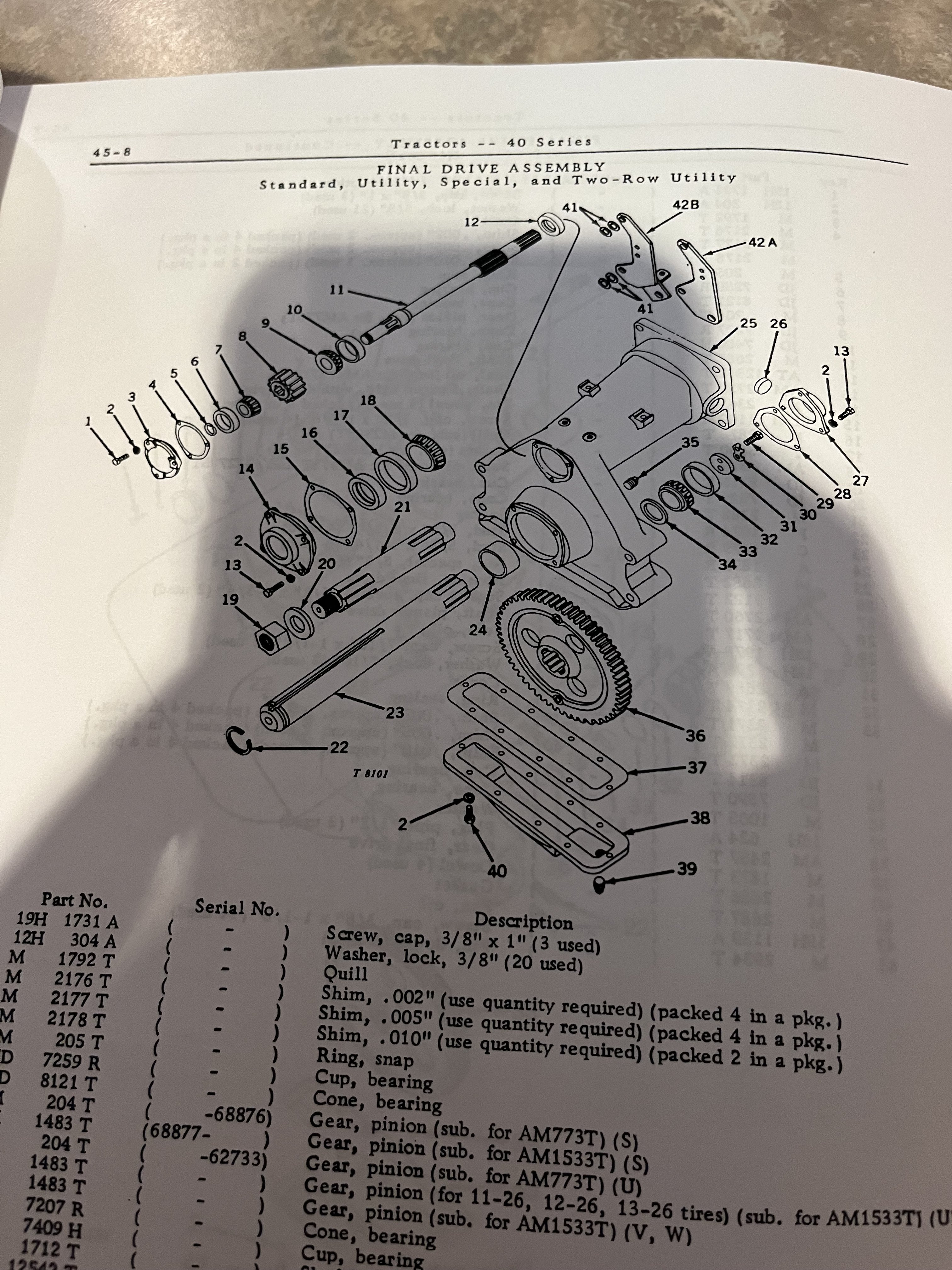

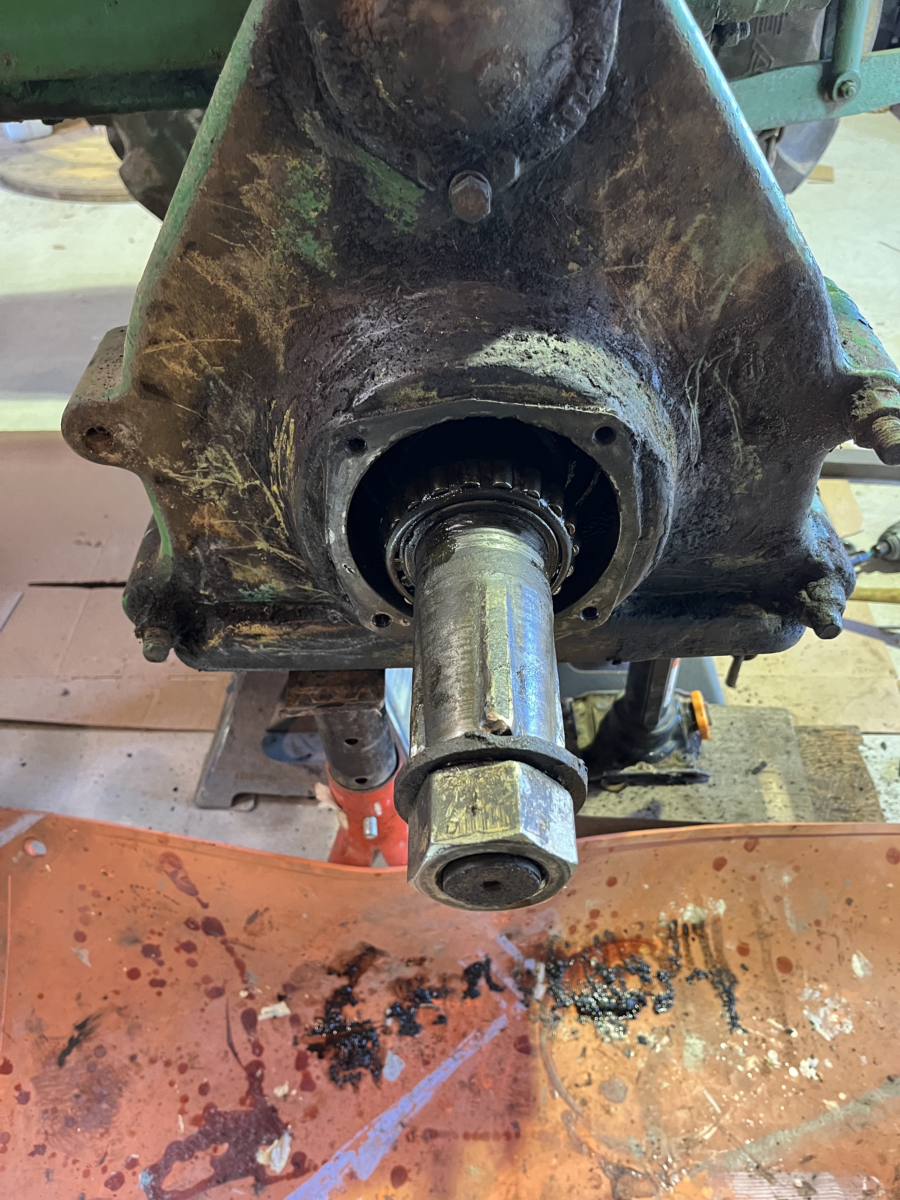

Where can I find the final drive bearings and seals, cup bearing and gaskets thanks

Use the part numbers to search with. Most if not all those seals and bearings can be cross referenced. Careful cleaning of bearings often reveals the manufacturer's part number which parts stores and bearing houses can easily find. John Deere dropped the letter suffix from the end of most part numbers a number of years ago. You might have to search some with and without that suffix letter.
Gaskets may be dealer items or make your own.
Mother Deere is always a good place to start.
Just out of curiosity what is the problem and what is the goal? Those are good low speed tapered roller bearings and shouldn't need replacement. Any wear and all you need to do is remove a shim or two to get the preload back in spec. If you replace them you'll probably need more shims. It's not a swap and go deal.
