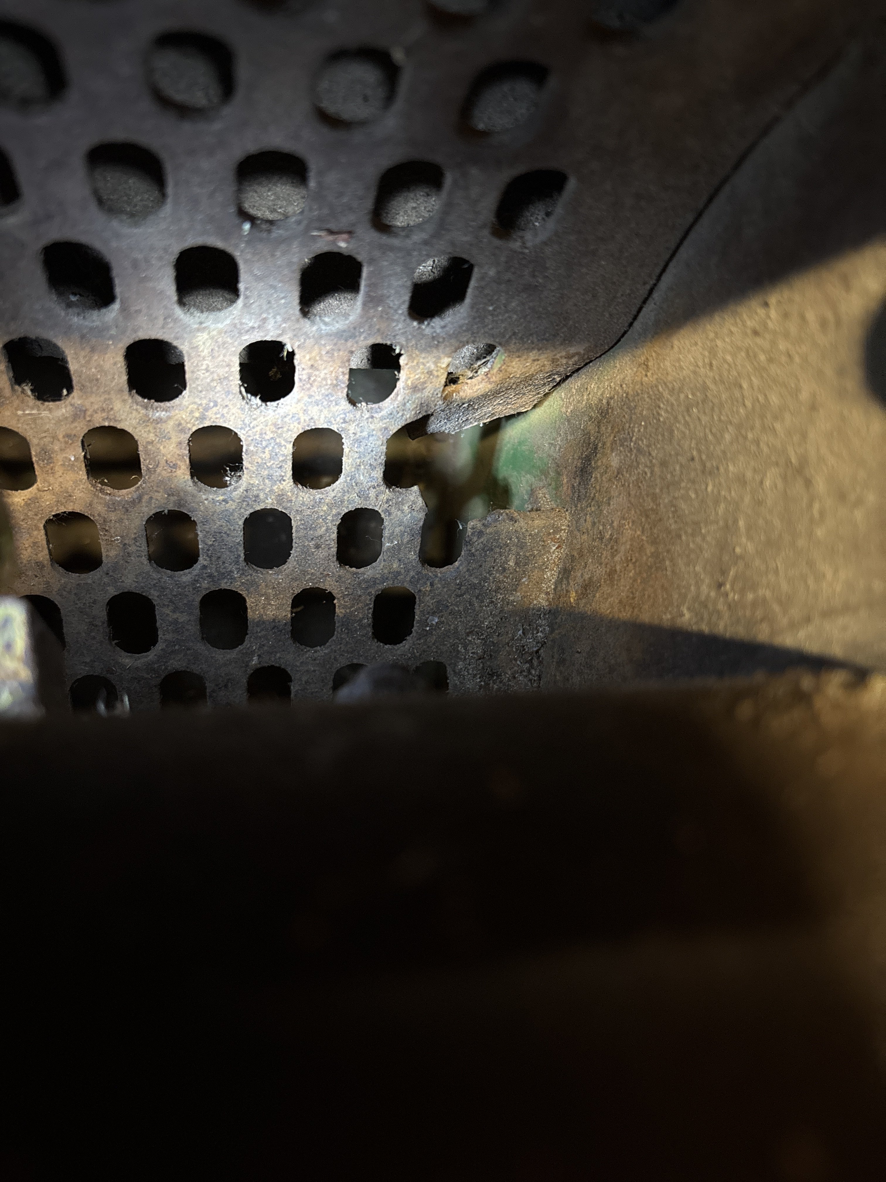

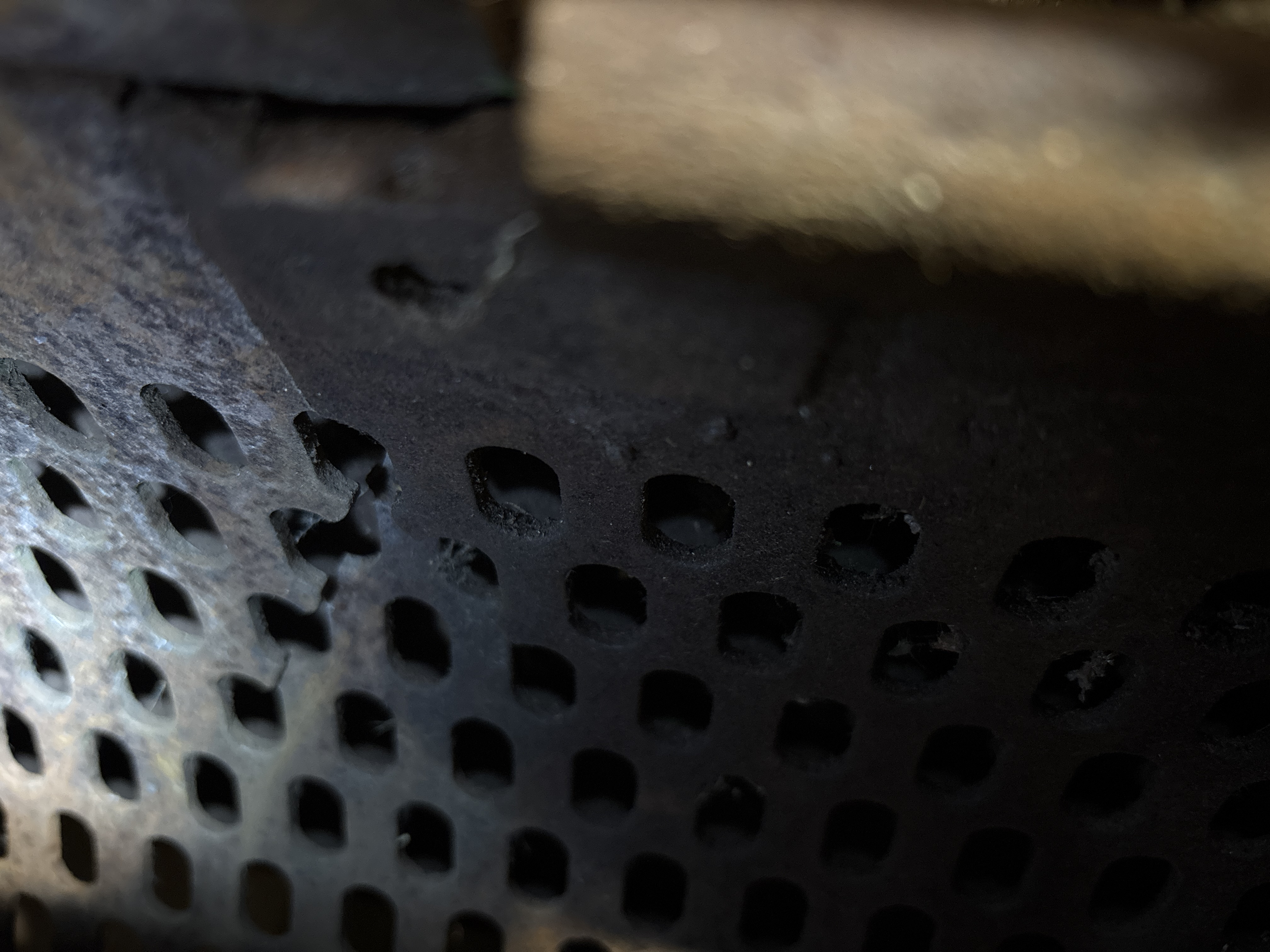

Cut out your rubber blades L1264C out of belting. You need a very close clearance at the outside edge of all the paddles. The belting will bolt onto the three metal blades on the blower fan 7544C. You will create a vacuum to suck in the corn and make pressure to blow the corn up the pipe. Also, run your sheller at rated speed, or a little above loaded to spin the blower and cylinder at the correct speed. I had one, worked great! The parts that wear on the sheller can be fixed with a welder, as the lugs on the main cylinder, cob stacker, and corn blower.

Thanks for the tips, now to find a puller big enough to get the fan off the shaft. . I also just noticed some cracks in the cylinder housing near where the cobs will exit to the stacker so I might be getting in deep.
