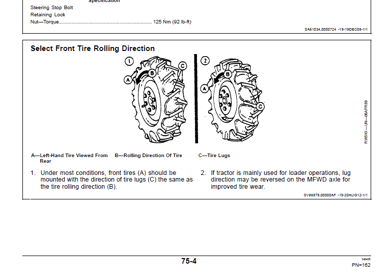

My 5065e is wearing the tires out on the front on the outside of the tread. Checked the tow and that was perfect. It almost looks like the camber is off on both front tires. As far as I know there is no adjustment on the camber.
Anyone got any help on this issue?

Toe is good camber looks off but nothing can be done about that. It is 4x4 with loader. Travel 2 miles a day on hard top feeding cattle. Just put new tires on last week got about 1200 hrs out the last set

Two miles a day on hard top with (presumably) half of that with a hefty load on the front end is going to be pretty hard on the fronts - especially if they're the narrower 9.5's. 1200 hours doesn't sound too terrible to me for that kind of use - not sure you're going to get much better with any adjustment.
Several 4X4 tractors and tire manufacturers up through the early 90's had recommendations to run the front tires with the tread facing backwards for loader work (for all I know they may still have the same recommendation?). I always thought it was a little wacky, but a family friend who ran a large (for this area) operation and who had exceptional mechanical skills swore by it - his JD 1840 and 2555 4x4's always had the front tires reversed.
The reason I mention it: Running the front tires backwards has fallen out of fashion, but you won't hurt anything to do so. You could try reversing the fronts to see if they wear better. More significantly, you could periodically swap them side-to-side without having to demount them from the rims to have them wear more evenly. Half the time have them running normally, then swap sides (keeping them on the same rims) so the other half of the time the tread's facing running backwards. This is presuming you're not running radials.
Alternatively, you could get industrial-pattern tires the next time you need to change them. Not quite as good for traction, but much better than an ag-pattern tread for road wear. But you'd want to check diameters well to make sure they match so your front & back wheels won't be driving at different rates.
I assume you're not running it in 4X4 mode when you don't need to? Running in 4x4 on dry hardtop would be exceptionally hard on them.
Further to my last post - here's the section from the Deere manual where they recommend the front lugs facing backwards for loader work (this taken from a 2555 manual, but it's in several other manuals as well):
