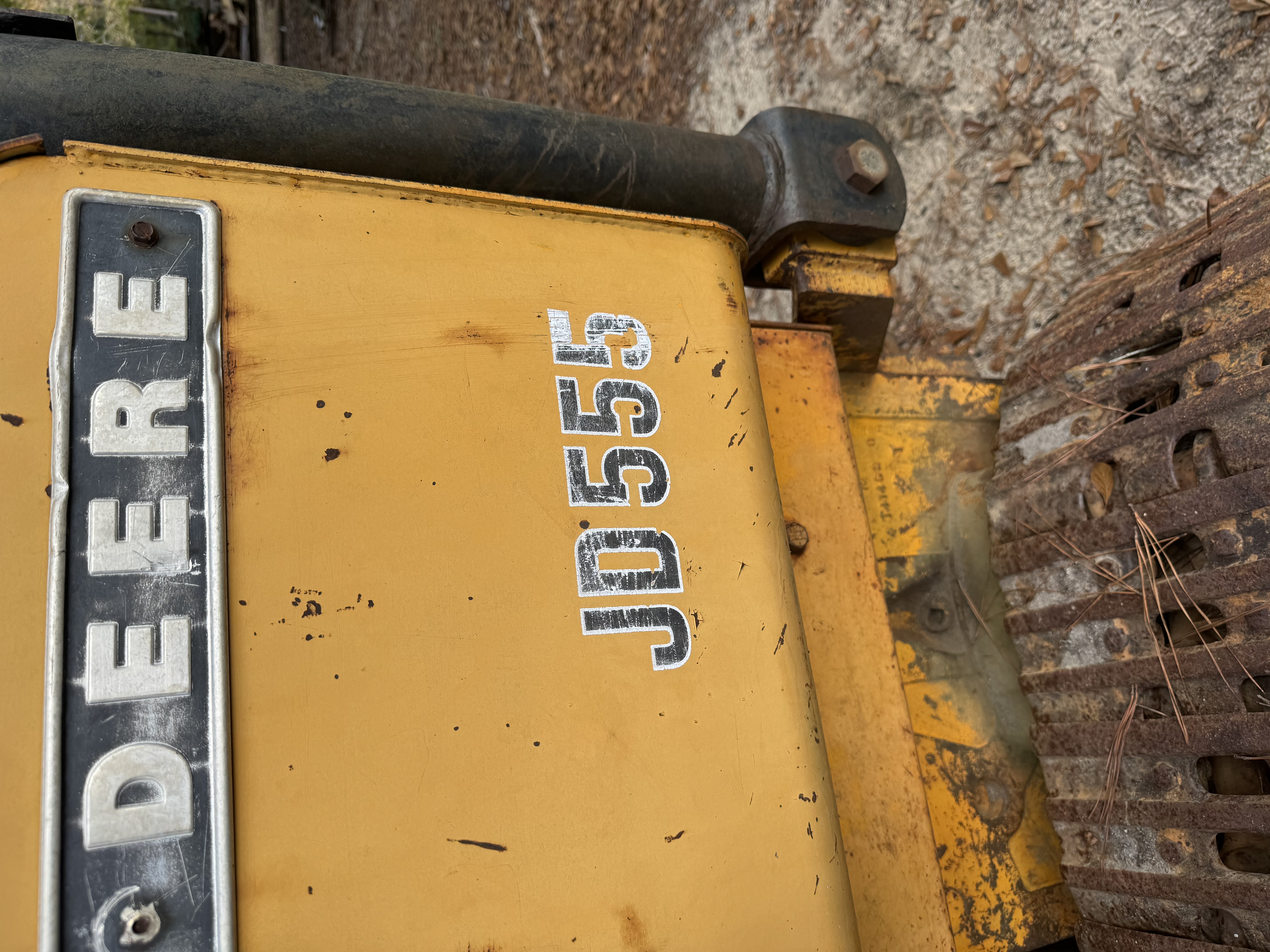

Evening All,
I’ve got a John Deere JD555 track loader, seems as if the hydraulic fluid is getting into the transmission. Trans was full, hydraulic tank was full, set for a month or so went to start it and noticed the transmission fluid was over full and the hydraulic tank was low. Anyone have any experience or thoughts on this issue.

Hydraulic pump mounted on the torque convertor housing? If so my first thought is the hydraulic pump shaft seal leaking.
