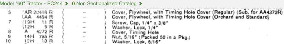

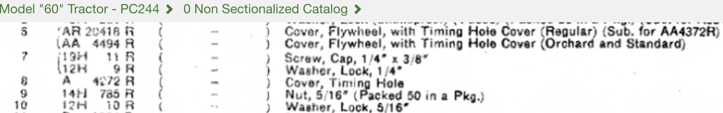

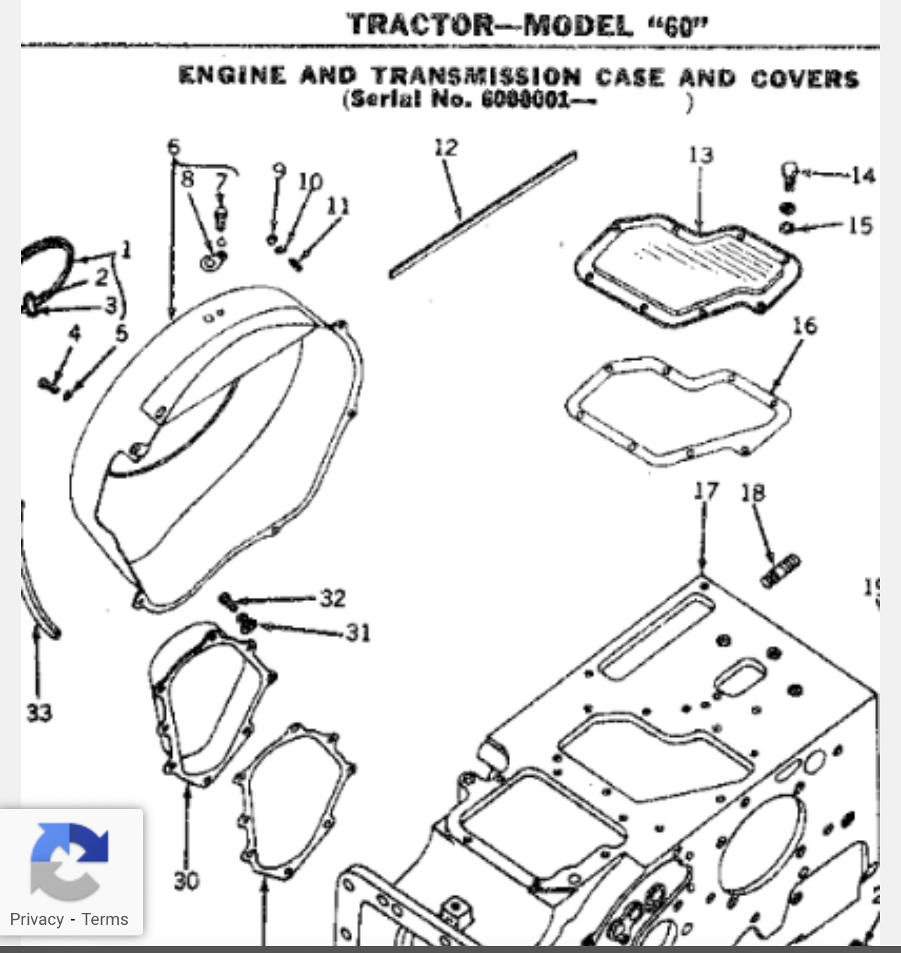

I have a john deere 60 standard and am looking for a flywheel cover. The part # i am looking for is AA 4494 R. Parts book says its for the orchard and standard styles. The only ones I can find online have part # AR 20418 R or AA4372R. They are for the regular style row crop or lp. Would I be able to use these numbers for my tractor or is there a difference between the covers
I'm wondering if the difference would maybe be that the starter linkage goes through the cover on the high crop? The timing hole would be in the same spot i would think wouldn't it
Different JD part number means a different part? But you may be right. Might try a tractor salvage yard for the JD part number you want. A hi-crop may be your part number? A hi-crop cover is not in the parts book. I can not believe all these cover are that different?
A visual

I have two 60's, one early row crop and the other a High seat std. I looked at both specifically looking at the area where the starter linkage comes up. I see no real difference there. I also agree with JIM MN,"Different JD part number means a different part".
