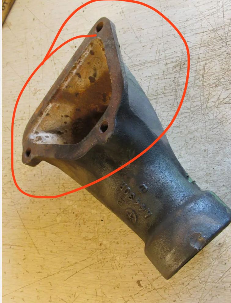

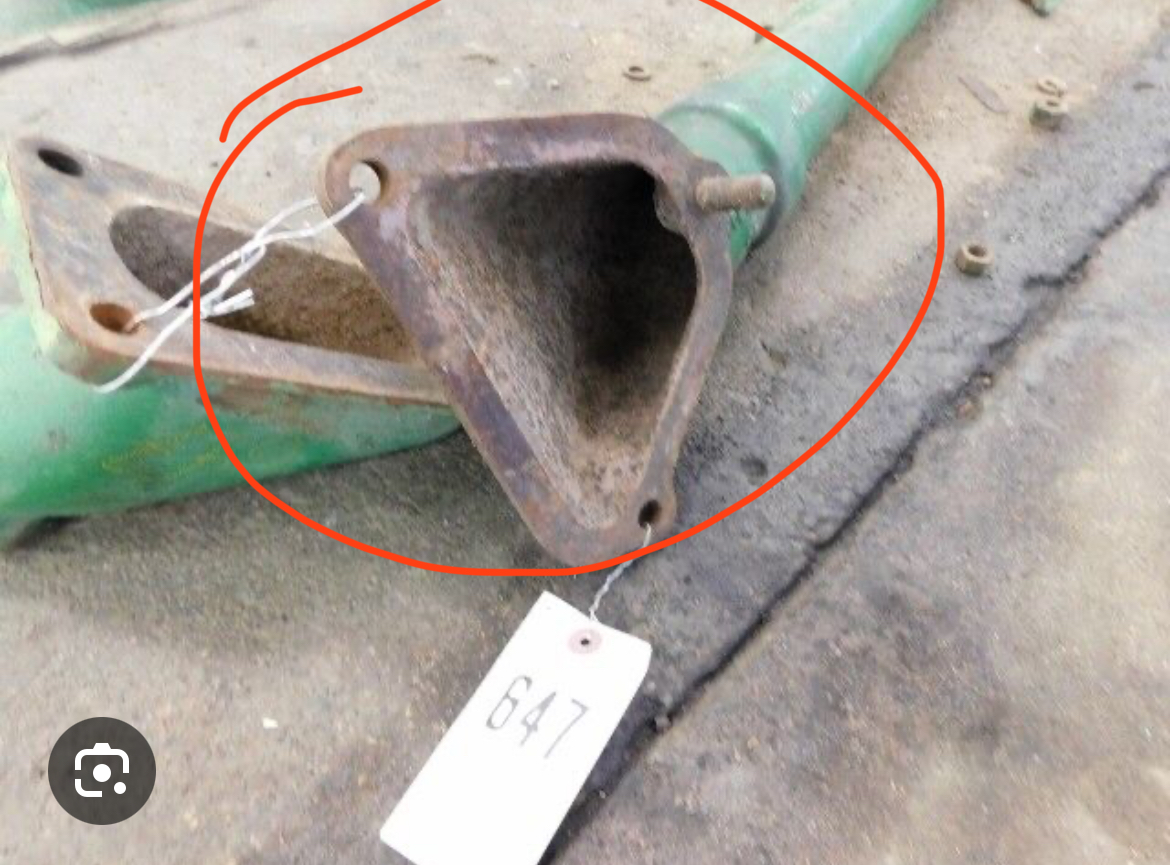

I got a John Deere 60 I replaced the radiator but now the upper radiator water pipe is leaking a pretty good amount of water, I have looked for a gasket but can’t find one, do I need a gasket or no. IMG_2332.jpegIMG_2331.jpeg
I got a John Deere 60 I replaced the radiator but now the upper radiator water pipe is leaking a pretty good amount of water, I have looked for a gasket but can’t find one, do I need a gasket or no.View attachment 80902View attachment 80903
You can make a gasket, clean up both surfaces, glue a piece of gasket paper to the removed part, use a small ball peen hammer, and tap it out, use a little gasket maker to the top side, bolt it on and go.
Gasket A4431R is still available from Deere. Assuming you have a row crop. Standard and Orchard versions use a different gasket depending on serial number.
Got a cereal box in a kitchen cupboard? You've got gasket material.
Heck, depending on the size of that part, a cake mix box, hamburger helper box, pasta box... really any box.
There are lots of videos on youtube showing how to make your own gaskets with basic tools. It's really not difficult. If you cut out shapes from construction paper in kindergarten you can make your own gaskets.
Once your gasket is cut out, smear an ever so slight amount of grease on each side, and install. Don't have any petroleum grease? Use Vaseline, shortening, butter, bacon fat, beef tallow...
You could also make a quick trip to the auto parts store, get a roll of gasket material and a tube of permatex ultra black.
Barnyard; you have some great information. What you said all will work great. I have been there, done that, and it all works for a long time, no leaks,
''I have looked for a gasket but can’t find one''
I'm curious as to where you may have "looked", as the A4431R gasket APPEARS to be still available through John Deere and there are literally unlimited sellers on the 'net that a GOOGLE search will bring up.
About $16, though, and as several others had said, very easy to make yourself.
