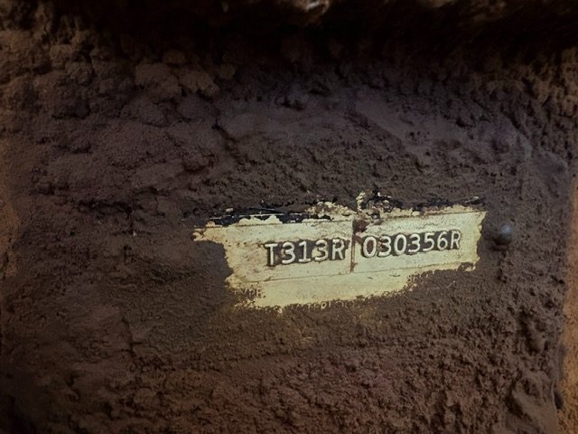

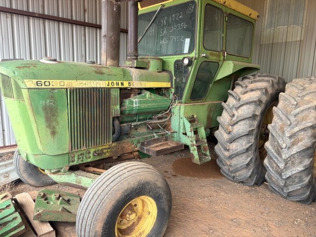

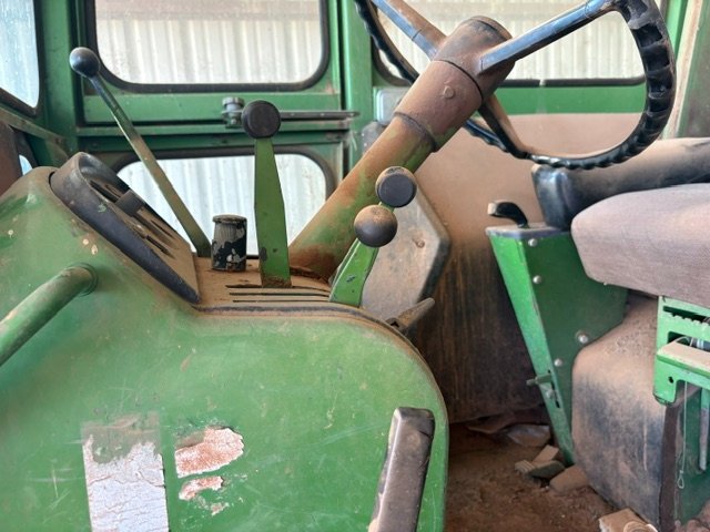

looking for information on this 6030??? The serial number is T313R030356R which is not in the parameters of a 6030 and it has SCV controls on the dash as well as lift controls as a side console. What do I have? Any help would be appreciated.

Scott 730, you are right! My findings are, the serial numberT313R-030356R, falls in the serial number of a 1971 JD-5020 313R-030003-030612R. 5020 side-console rear end. Center console maybe 5020 before 1969, hydraulic levers on dash? But the engine looks to be a 1972 6030 intercooled turbo? Hood grill, side screens, air cleaner, I dont know? What does he have? It does have a Hinson cab!
