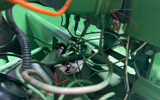

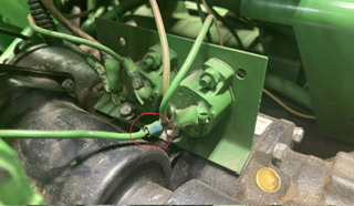

I had a the wire the I have circled short out against the tractor, and now none of the electrical on the tractor is working. I am also unsure of what these are that are sitting on top of the starter as there are not listed in the wiring diagram?
Those objects with 2 posts are circuit breakers that were adding in a field installed kit from JD in an effort to help control fires started by electrical shorts. You are correct in that there are no photos of those circuit breakers in a JD 730 parts catalog. Wire circled in your photo should only control 1/2 of your tractors electrical system BUT for starter to operate wire on each circuit breaker must have 12 volts.

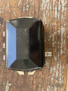

I tested the circuit breakers with my multimeter and all terminals read 12volts. There is a wire coming off the breaker and going to a screw in the voltage regulator, I have a new voltage regulator and it does not have this screw in the side, the new voltage regulator has a ground terminal instead. Which terminal should I hook this wire to?

Are you sure voltage regular is for a JD 24 volt electrical system? I would think circuit breaker supply should be attached to bat A or B terminal on ign switch.
I’m not sure, all the electrical worked before except for a draw that was running the battery’s down if it sat for more than a couple days, and I was unable to get the generator light to come on.
The starter was rebuilt about a year and a half ago, I will hook the supply line up to the bat B terminator terminal on the switch and see what happens.
