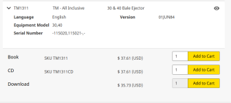

I have no knowledge of JD bale ejectors as very few were used where I live. If you have a model 30 ejector I suggest to get a JD TM 1311. BUT JD parts shows ""model 346 baler has a model 42 ejector"" which lists several different operators manuals & a different Tech manual # 1584(2nd photo below)

That is the manual I have
Yes that is the manual I have TM1584, I was wrong, its not a 30 ejector.

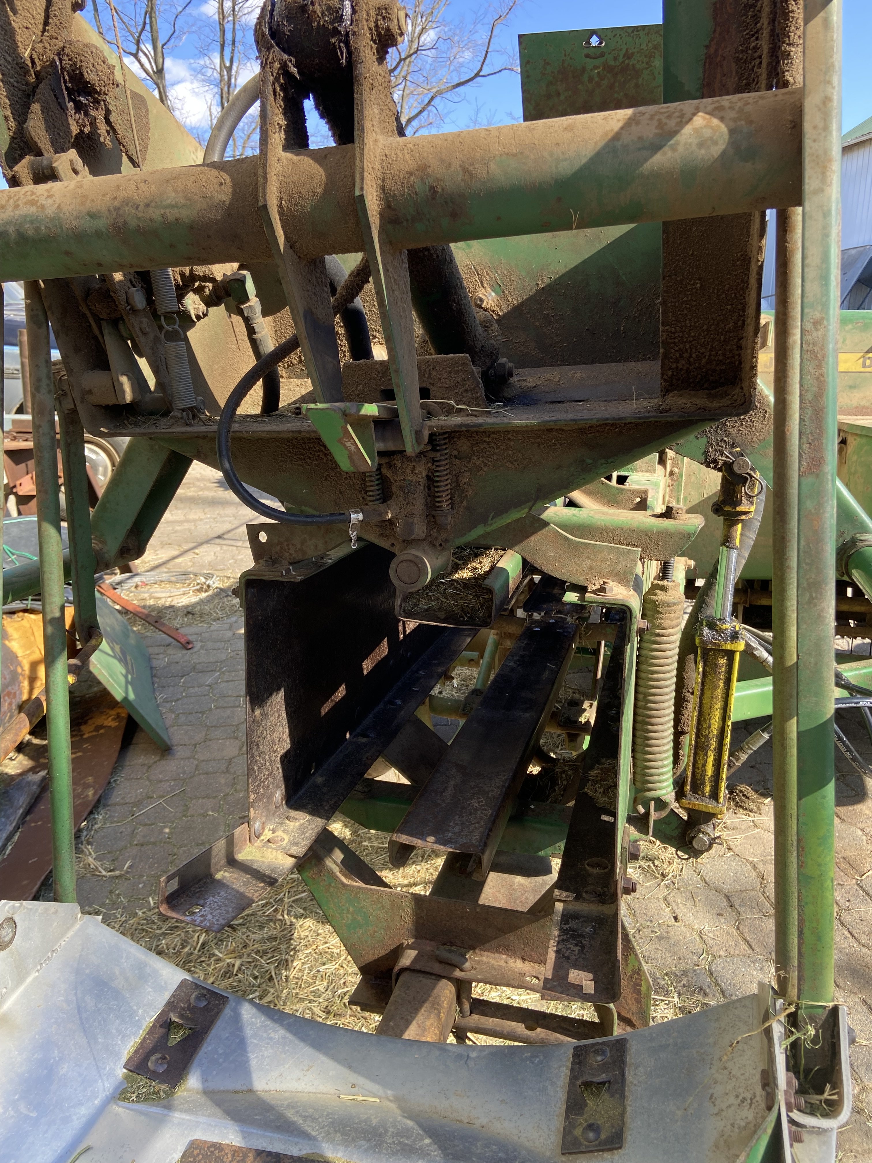

My thrower pans stay up if they trip at an idle so I assume it’s related to the pressure when tripped. You say you changed out the fluid but did you clean the screen filter in the tank? Also, the 2 small springs under the latch break occasionally. Check them. I believe the arms won’t latch correctly and act as you described too.

One other thought, check the spring in the base of the thrower cylinder. If that spring is broken, pan does not return to the set position either. I’m not sure where you are but my balers sit outside. However I have sheets of rubber roofing on them to keep rain out of the control valve. They will corrode

Im in upstate NY, I was JayinNY on here in the past, but svcummins and I got blocked, but im back on. My baler is stored in side. If you mean the two little springs to keep the latch cylinder locked until it throws, they are not broke.

The spring inside the throwing cylinder is probably broken unless the spool in valve is not returning home and pressure is keeping pan from returning home.

Check the springs near the tiny latch cylinder, it has to be fully down and latched to cycle properly.

The pan is returned home by the spring my b inside the cylinder. It has to be at pto speed when tripped so the pan is thrown with enough force to compress the spring to return the pan to latch home.
