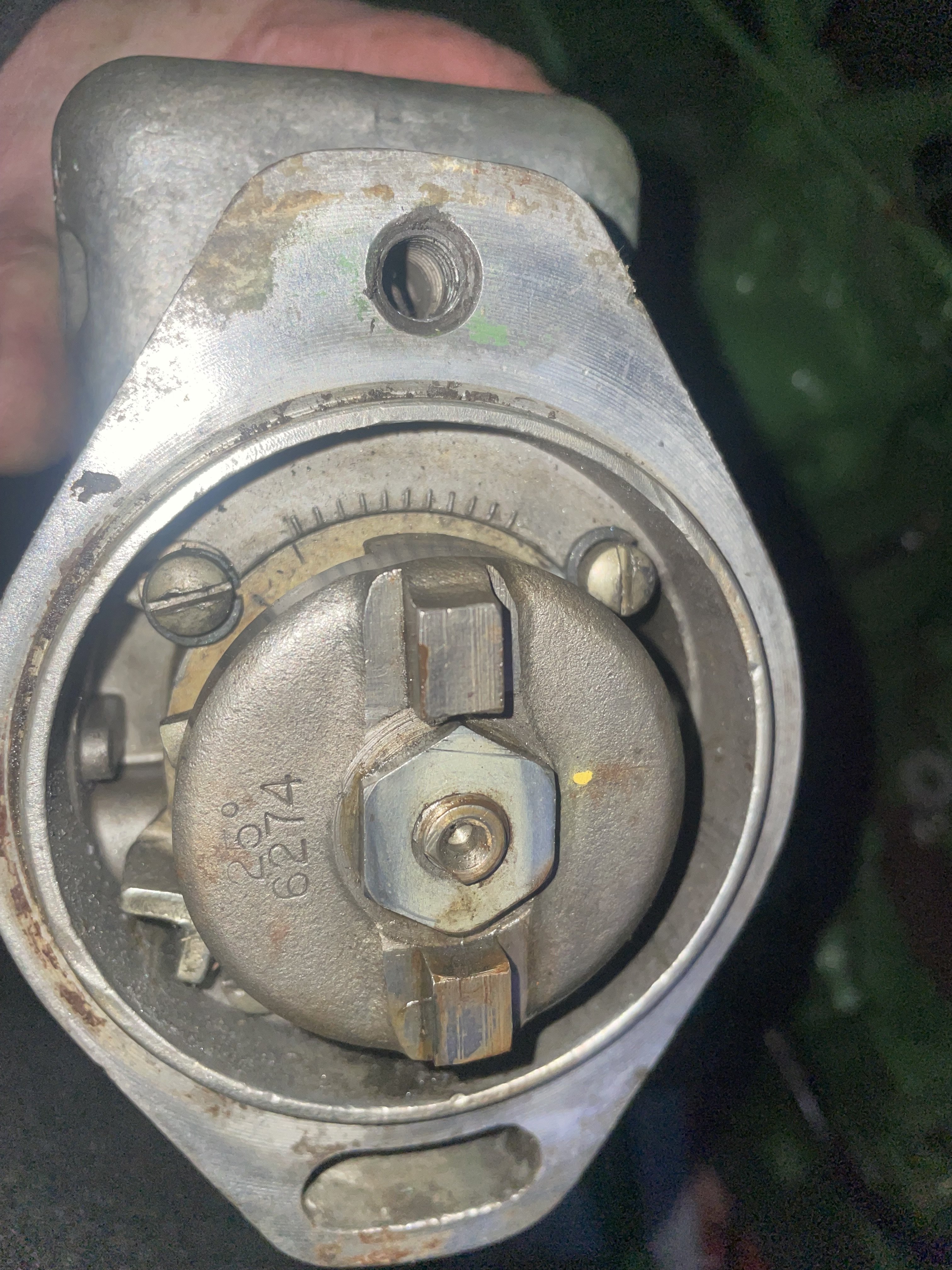

Hi all I pulled mag off to check witness marks on mag I think this is wrong I think it’s to advanced? I also ran tractor with air cleaner pipe off and same issue .
I also noticed that the RH pet cock was blowing small flames out as it was dark in the shed when I ran it I’m starting to think it’s a magneto timing issue. I pulled carb off to recheck ports and pulled the nozzle it’s all clean to me.
It starts easy and idles well but under load it will bog down and black smoke this would indicate run timing being off ?
Ok I got it sorted it was a combination of things but main one was the linkages from at to the governor were way to sort, made new linkages and it’s fine.
