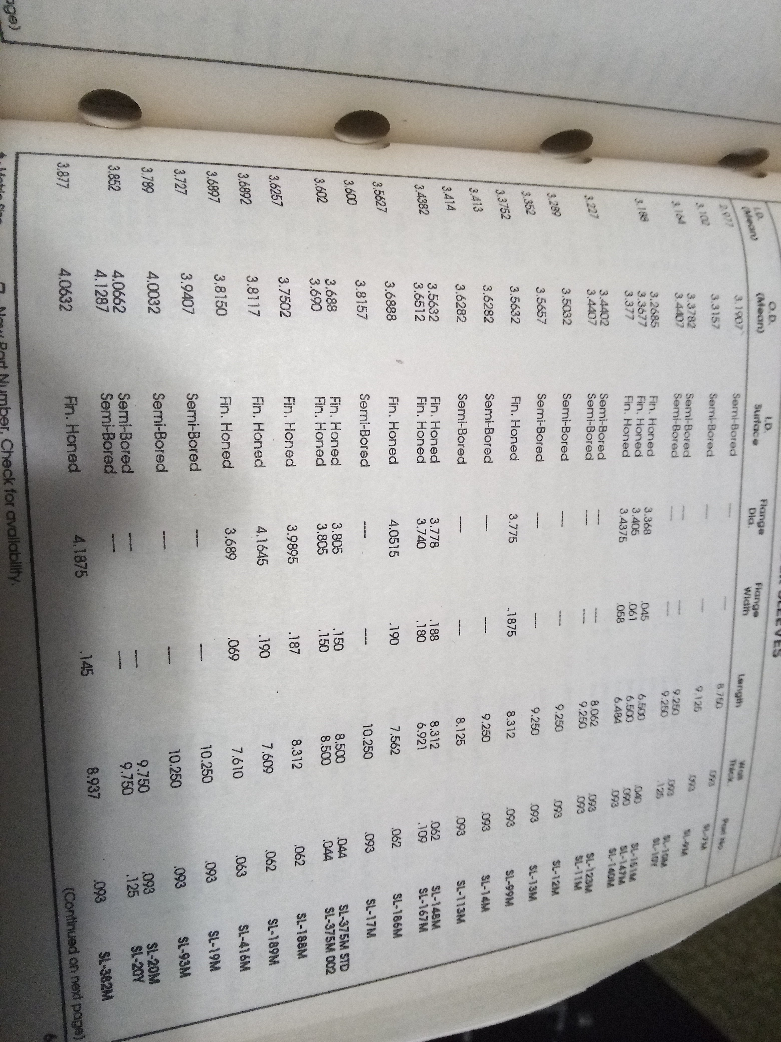

I have a 1941 John Deere H block that is rebored 0.090 oversize--I can find 0.090 rings but not the piston--can this block be resleeved back to original? I did find 0.090 pistons from Kuhns but they are domed and look like they are too long for the cylinder. Help!!

In theory yes it can be resleeved. Just need to find the appropriate material for the sleeve and a shop to weld it into the block.
Melling has repair sleeves in 3/32 or 1/8 inch wall thickness for 3 9/16 pistons. I don't know about the welding part, most repair sleeves are press fit. I sold my H years ago and am not up on the latest piston and cyl repairs
Pullers have sleeved the H block out to take plain ordinary low cost stock pistons from a 40 or even a 420 iirc .

Thanks for the replies---does anyone know where I could get 0.090 oversize pistons for my block as this seems to me to be my best way forward.

Try A & L Parts. Penn Yan, NY. 315-536-0543 M-F. They part out JD 2 cylinders and he has a barnful of new and used.
This is old Sealed Power catalog. Be sure length is adequate.
