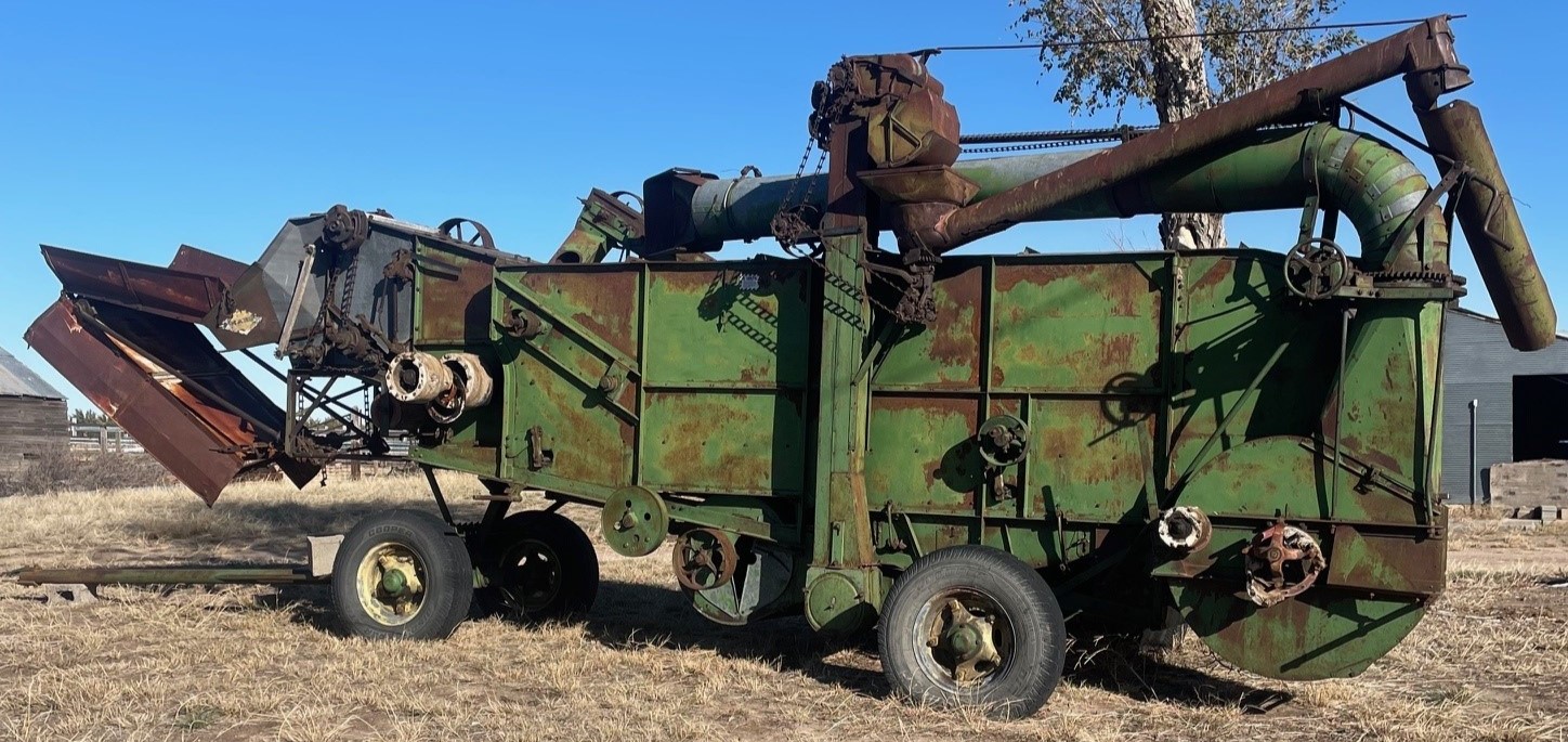

Gerald, I didn't recollect correctly the thresher doesn't have spoke rims it's actually more of a spoke type hub that the rim is fastened to. Here's a picture of it so now you can take a look at it. My father said that these were the original rims that came on it when my grandfather purchased it.
Gerald, I didn't recollect correctly the thresher doesn't have spoke rims it's actually more of a spoke type hub that the rim is fastened to. Here's a picture of it so now you can take a look at it. My father said that these were the original rims that came on it when my grandfather purchased it. View attachment 94393
Thanks for the Pic. I have never seen one with those type of wheels. It is a later model with a steel tongue.
