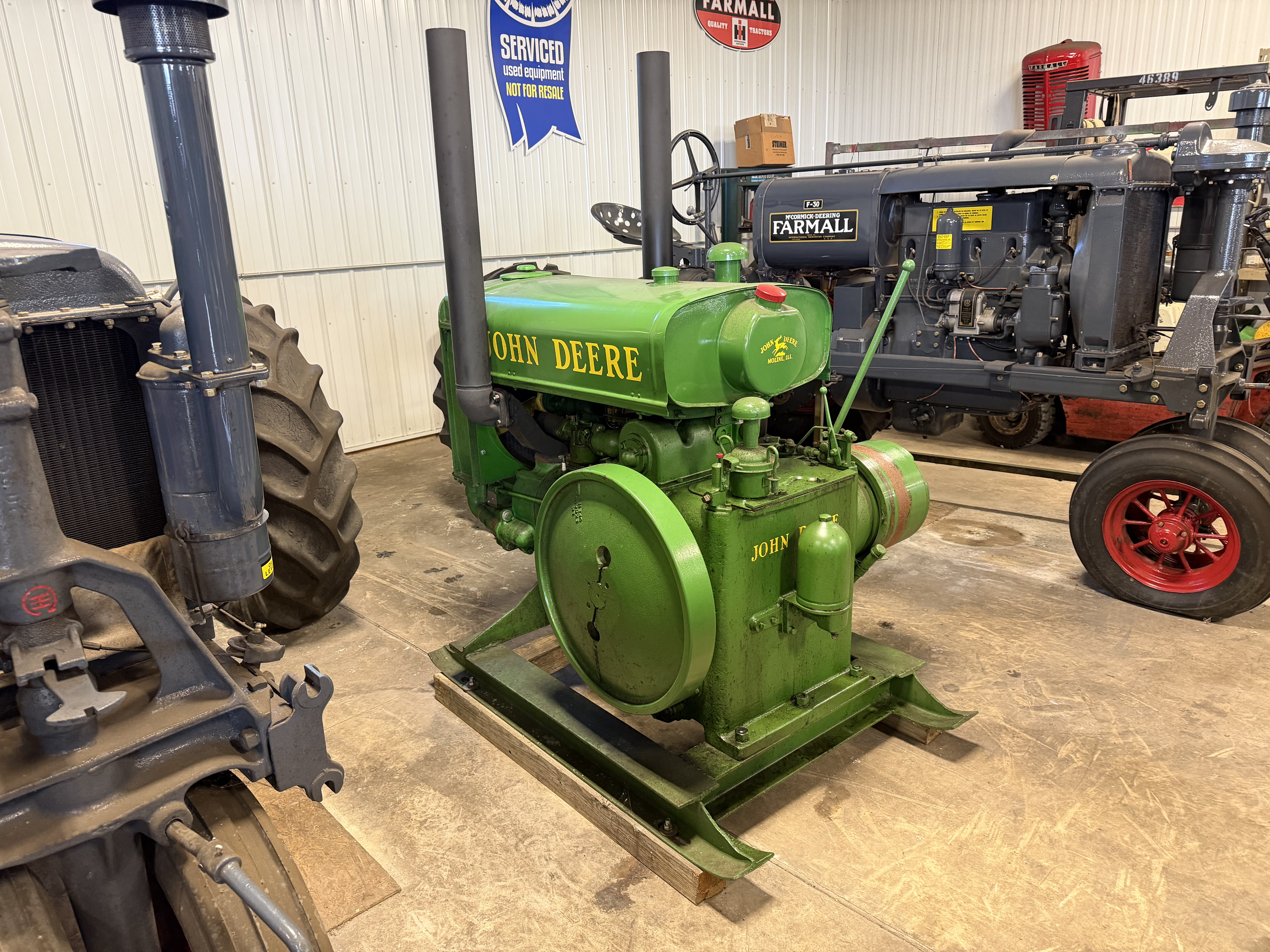

Put some dual exhaust on it. That will make it BARK!
I like using a flat belt to spin something like that after sitting around for a while.Gets the lube flying around,brings the compression up a little, gets the sticky rings a little looser,and you can make sure oil is actually pumping around before it fires off.I caught an A in time by spinning it that way.If there is ice in the sump,and you turn it over,the tang on the oil pump will shear off.If my old boss hadn't warned me about that years before,I would have fired it up and probably broke something.He had learned by spinning the babbit out of the rods on his dads tractor.There is a Model W engine here on FB in N.H. for sale right now,has dual exhaust and has an electric starter added to it.
