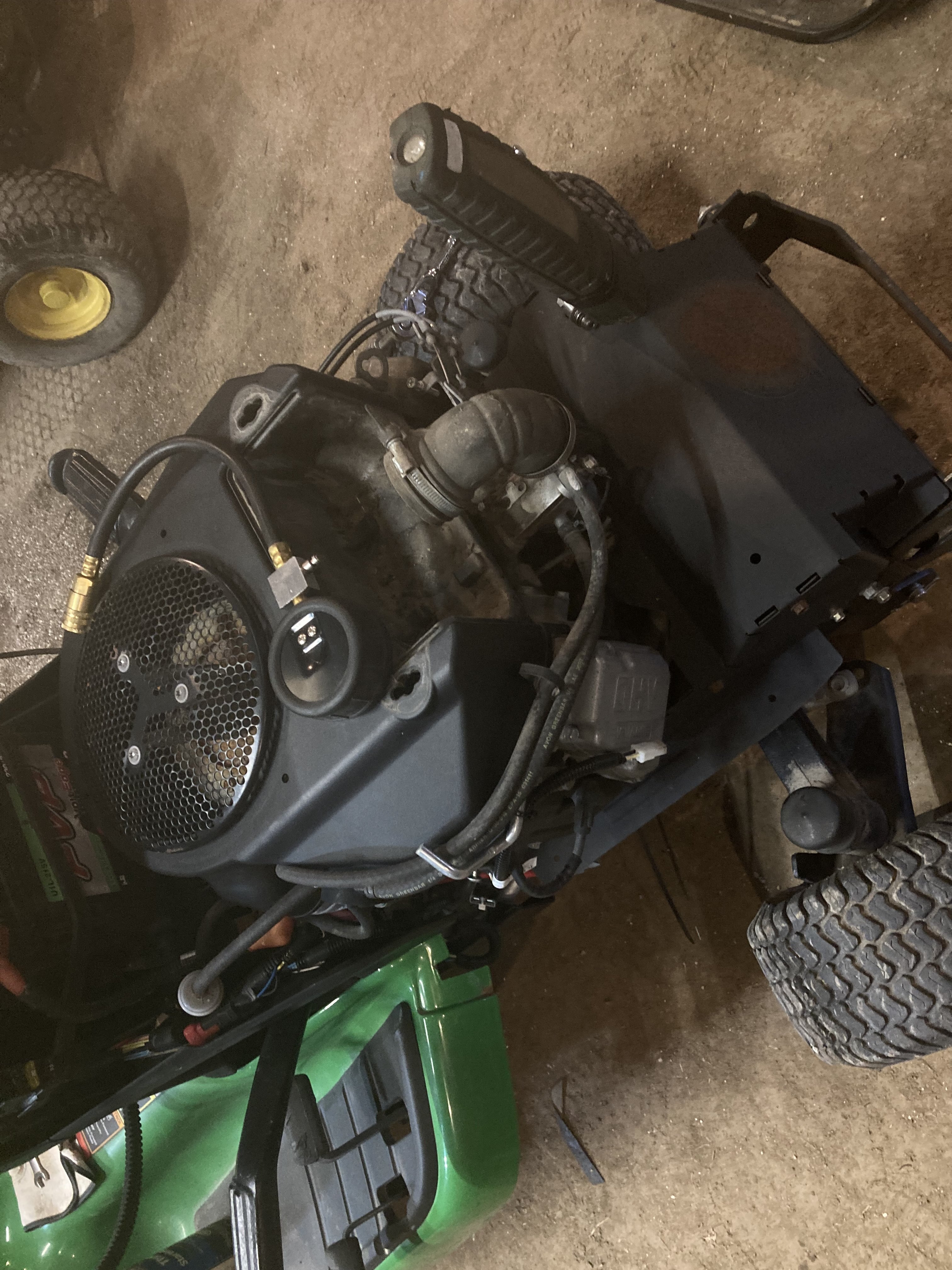

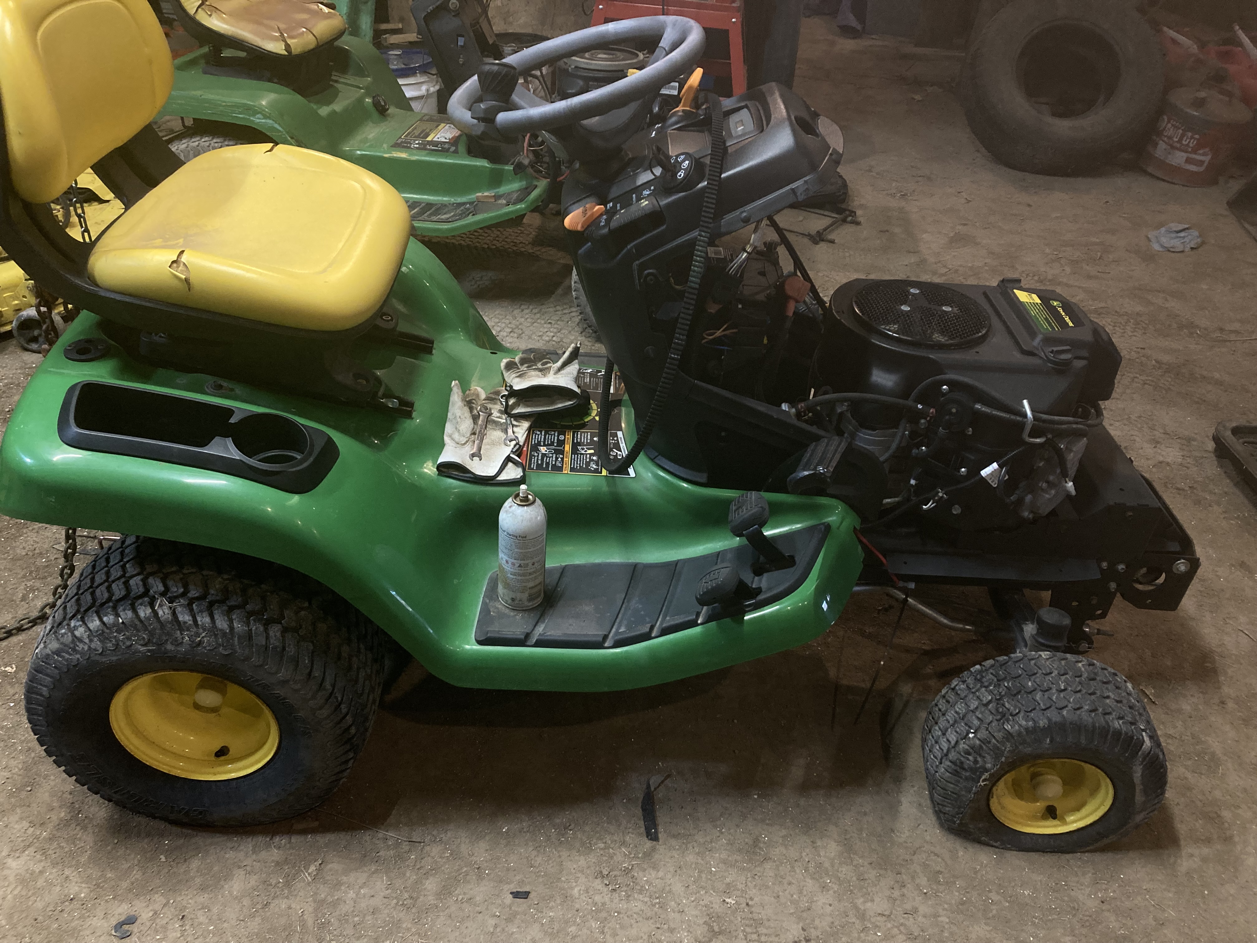

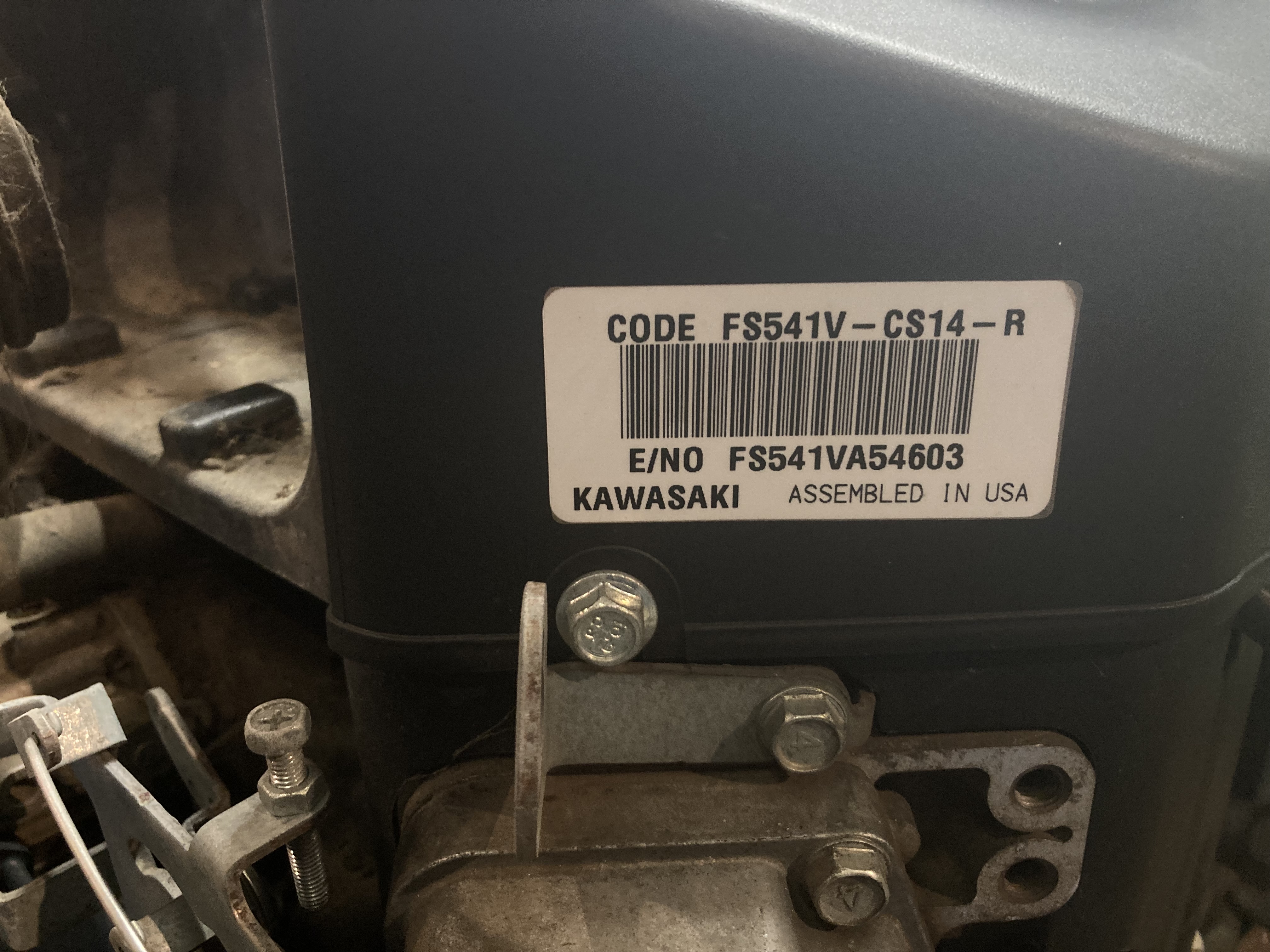

I was given this mower and they said the motor gave out. It is a Kawasaki 18 horse V twin, it has fire and turns over too easy, no compression on either cylinder. I guess the next step is to take the valve covers off and see if anything moves when cranked over. Are there any know issues with this engine?
Trying to decide which way to go. Thanks, Chris

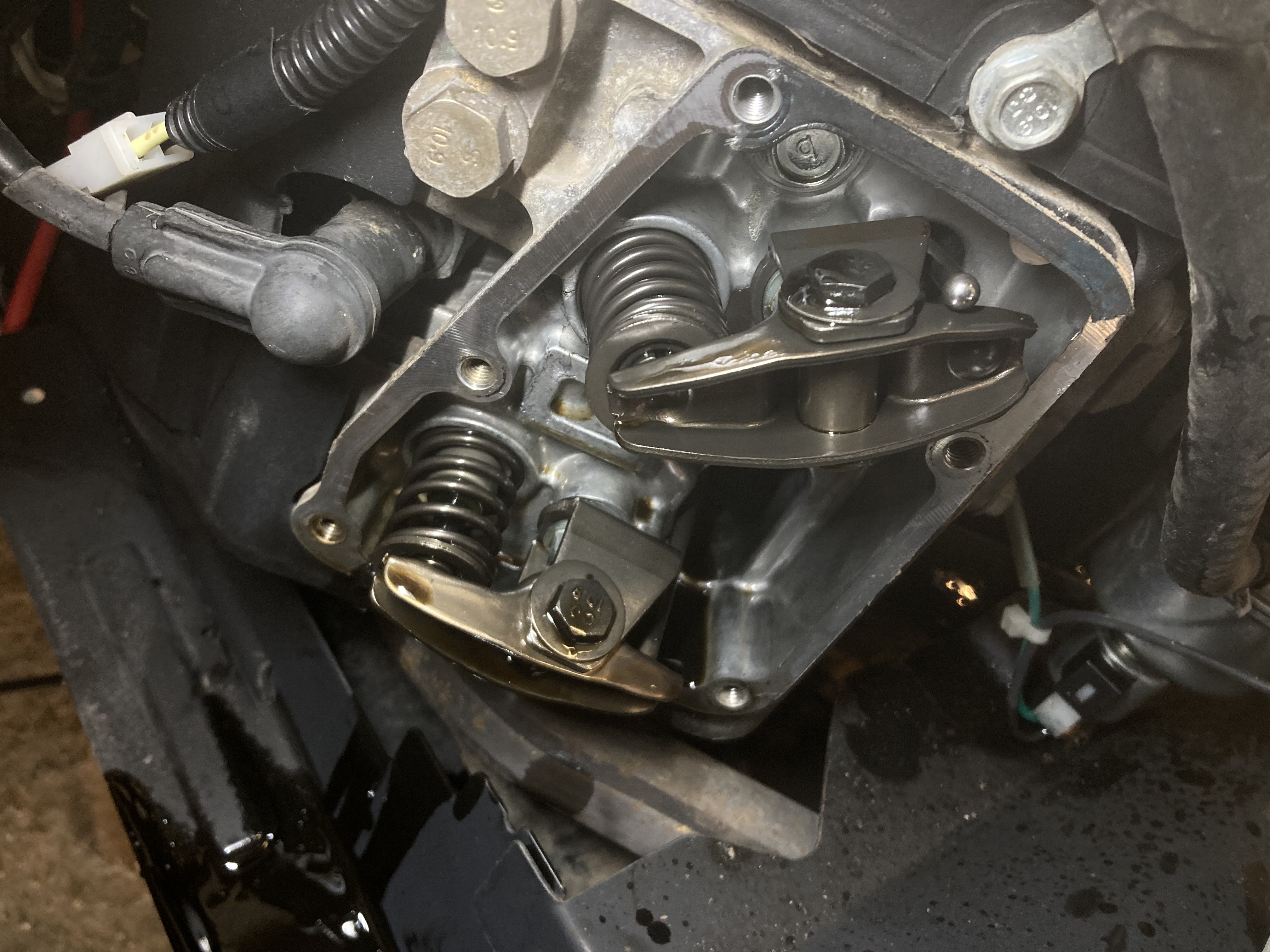

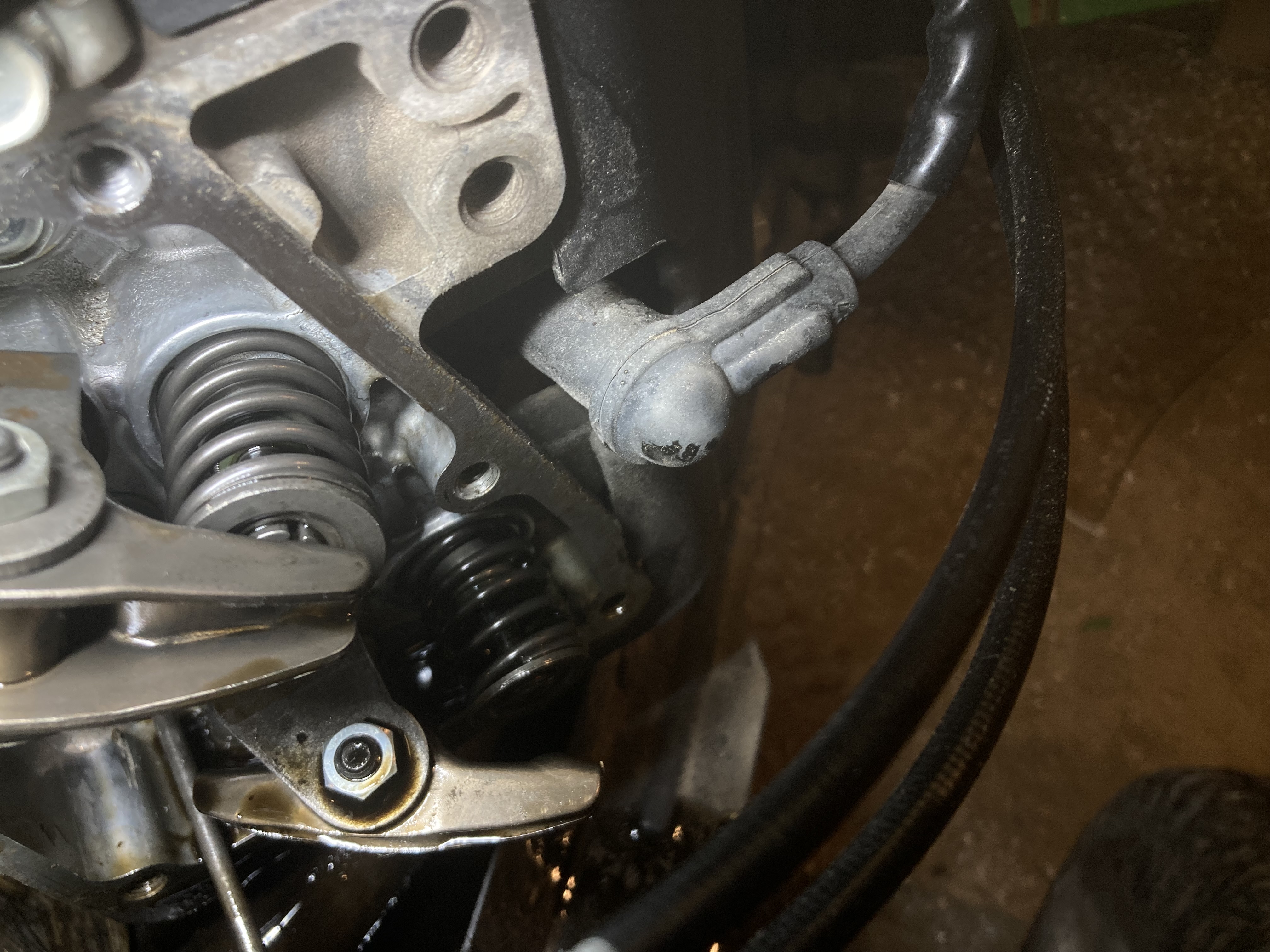

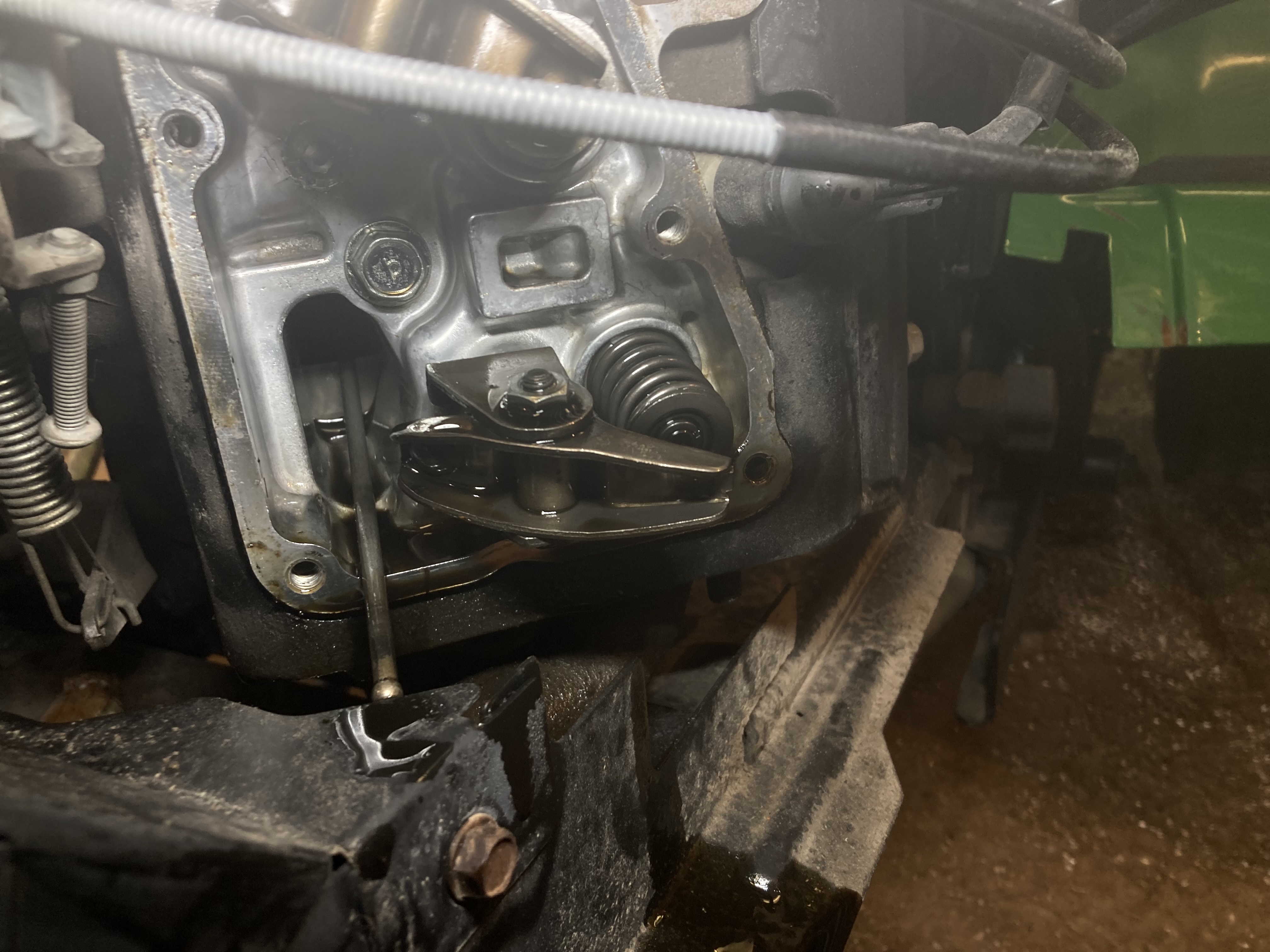

I took the valve covers off today, 3 of the 4 rocker arms were loose. That tells me it needs to be torn down because with the valves not working it should have lots of compression and both cylinders have zero. I did tap the valves on one side and they were all of the way out, not stuck open.

Make sure your spark plugs are in all the way... :)
I would also crank the engine with pushrods and rockers back assembled just to see how much blowby it has out the oil fill tube for curiosity's sake. (piston rings vs valve leakage)
And then take a bottle of soapy water and spray it around the head gaskets to see if they are leaking, again, just for curiosity's sake.
It's not necessary but could be good information later down the road, especially if you could hear where compression is leaking (if there is any).
Make sure to also look for signs of low oil, overheating, and/or especially cylinder glazing or dropped valve seats.
And please keep posting pictures!
I'm guessing you popped the pushrods out of the rockers during testing.
You did verify that the pistons are still firmly attached to the crankshaft via the connecting rods, didn't you?
I'm pretty sure that valve clearance should be .004 for intake and exhaust.

Haven't gotten that far into it yet. I just took the valve covers off and the rocker arms were so loose the push rods had fallen out.

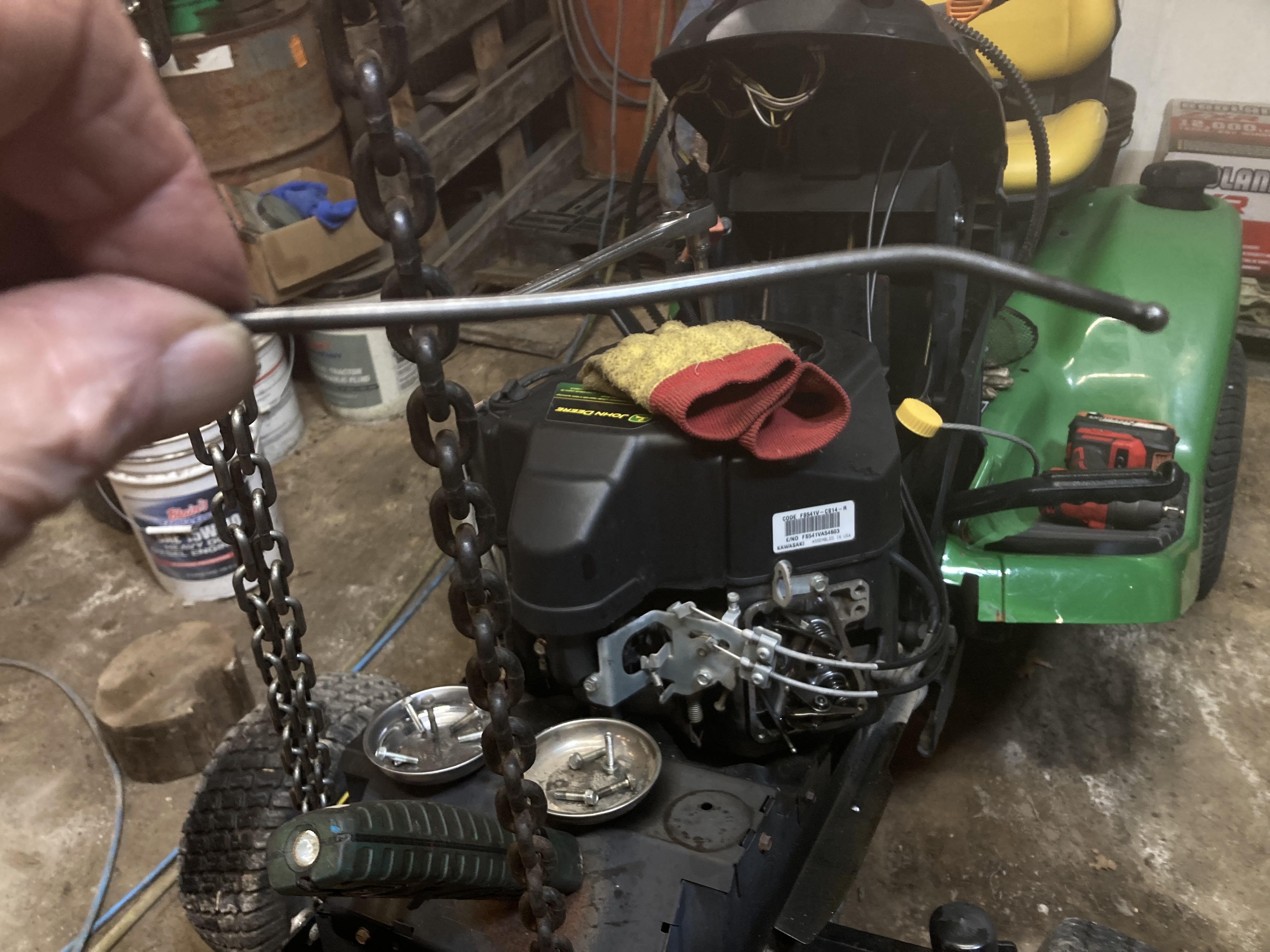

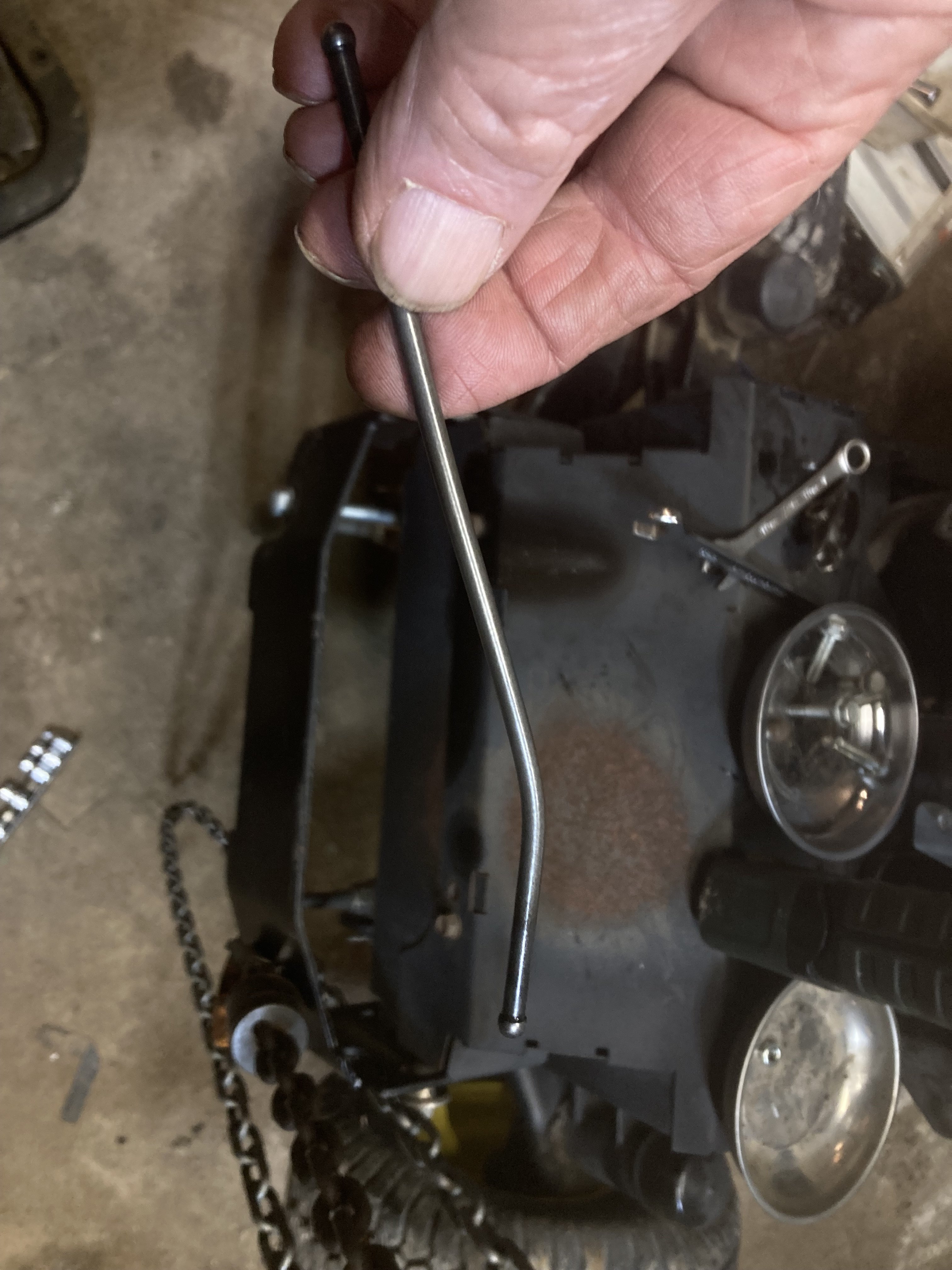

Tried to post 2 times with my phone with pictures but it wouldn't allow pictures so I'll try to post them later and see if it works. It got up to a balmy 29° this afternoon so I worked on it some. Both intake push rods were bent. I straightened 1 and put that side back together and set the valves to .006. Try to do the other side tomorrow.
Dug deeper today, not so good. It seems that the tappets on #2 cylinder aren't moving. The intake push rod extends out at least an inch farther than it should and doesn't move when turning the crankshaft. Guess I'll be tearing it apart to see what is going on, probably wait until summer when it's warmer and I have more time to spend on it. Thanks for the help so far. Chris
