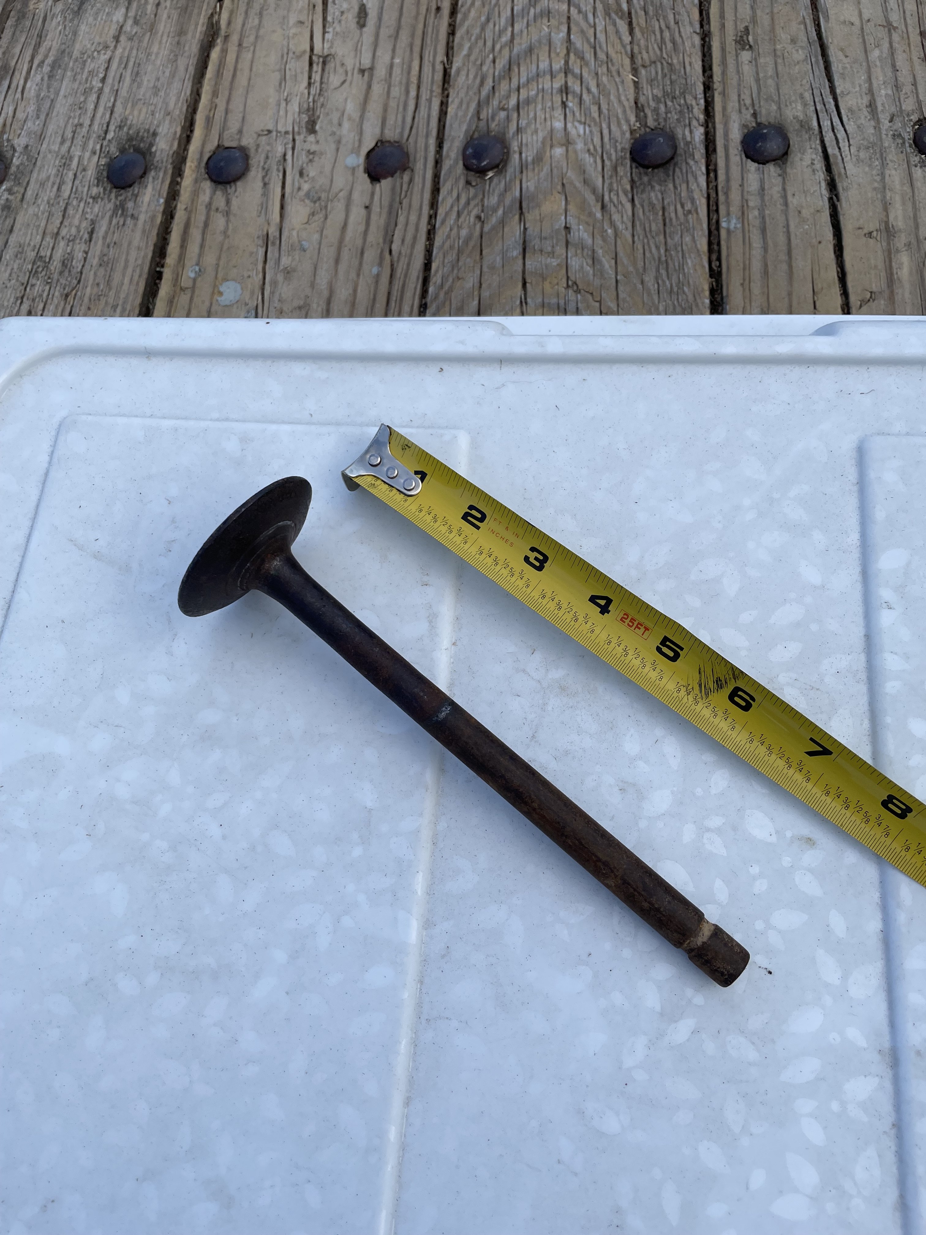

Has anyone used one of these for a draw pin? This has been the draw pin with our John Deere B as long as I can remember.
