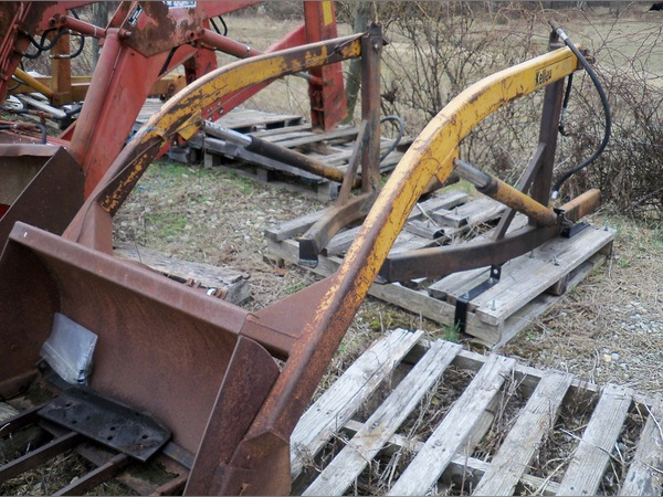

I have done research on these and haven't had much luck finding anything. I'm hoping someone here might know or have a manual about them. My 68 Oliver 550 has a Kelley 400 loader on it. It has a trip bucket and does not put any down pressure on the loader (no clue what the correct tractor terminology for that is)
My main question is what is the lifting capacity? Are these a fairly rare piece? I've only seen the one on my tractor.
Most more modern loader built in the last 40years will lift most round bales if you have enough tail to hold it down in the tractor. So probably in the 1500-2000 range of lift. Tractors hydraulics will also dictate that.
Single-acting loaders were very common up through the 1960's. Their primary purpose was mucking out animal pens, and the single-acting hydraulics allowed them to be used on older, more basic tractors.
There is only one hydraulic hose going to the bottom of each cylinder. No way it can provide down pressure. The cylinders currently on the loader cannot be converted to dual acting as they have no piston. The rod is the piston, and there is no room for oil to go in the top to push them down.
From the picture it appears to be a light-duty loader. Model numbers often indicated the lifting capacity of the loader, so 400 = 400lbs of capacity.
The 550 is a great little tractor, but I doubt you will or should, lift over 800 pounds with it. The weight of the tractor and the limits of the hydraulics aren't going to let you lift much more with it safely. As has been stated, they were built to replace a man and a manure fork and we were darned glad to have them. We didn't know anything any better like we do now. It's not going to do the work of something 50 years newer.

This loader is a lot closer to 60 years old, I would estimate.
That’s a cool history on them, I appreciate it. Now that you say it, 400lbs makes a lot of sense for the capacity. I’ve exceeded that, it’s not happy about lifting a lot more than that.
The 550s do seem to get light in the rear end. That’s good to know about the limits of the hydraulics. I’m sure these loaders were awesome to have when they were new.

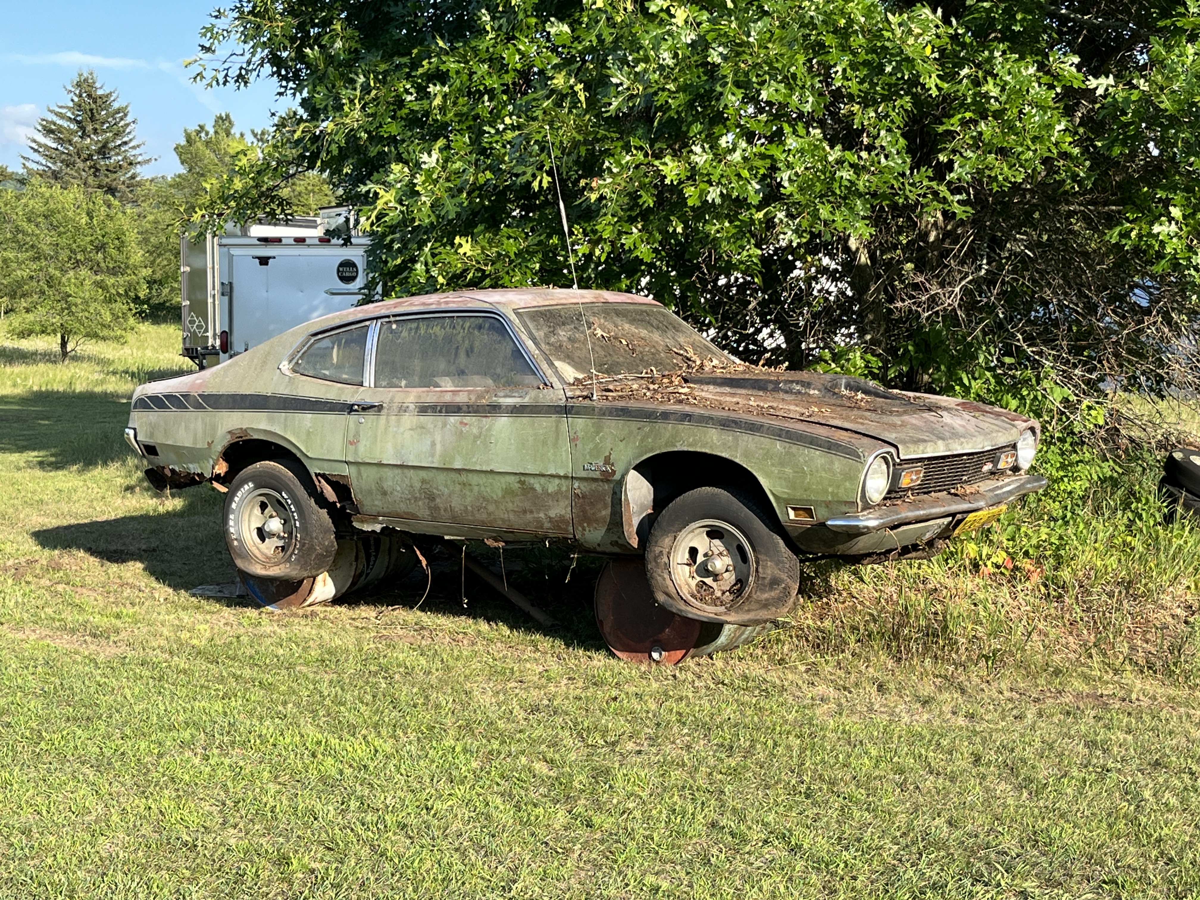

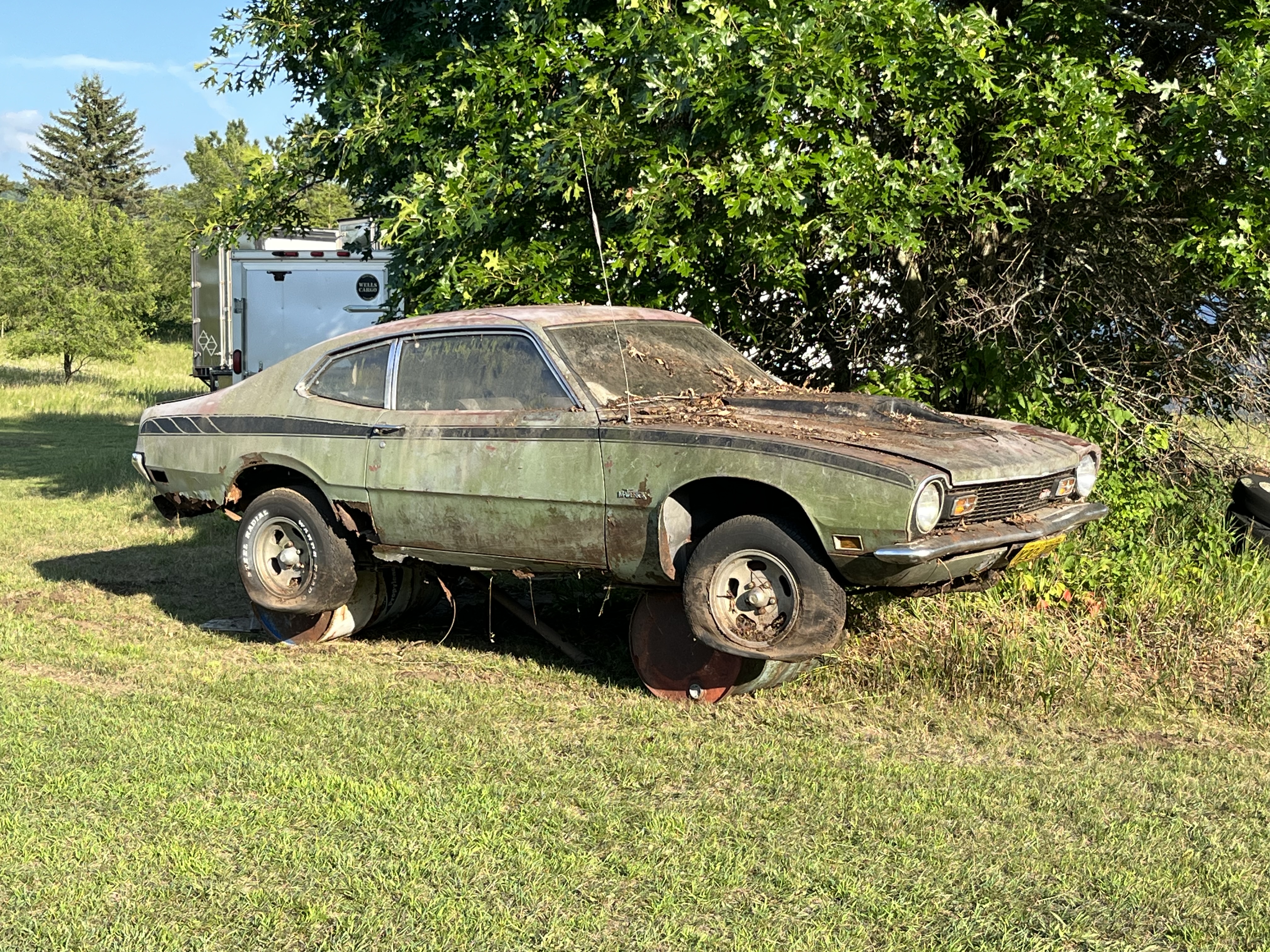

This is probably the sketchiest thing I’ve done with the tractor. We put this car on barrels because towing it on a trailer would’ve torn it apart because it was so rusty. This would allow a rollback tow truck to load it much easier. It was picked up end by end and was just picked up, not picked up and driven with.
