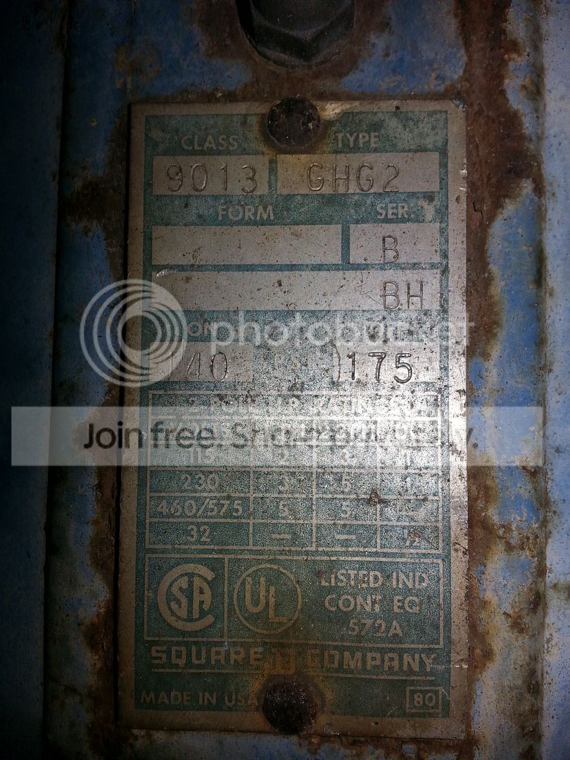

Decided to start a new subject because of string of info. Looking at this chart, is it possible to run a 3hp motor with a 5.5" pulley? It appears it may run to high of an rpm for this size motor. Opinions please! TIA!

I know the compressor has a unloader valve, just not sure it works. I saw some of the pressure switches had unloader valves. I know my switch would be connected to tank, but does the unloader valve on switch connect to compressor by other means? Looking a little online, it appears I could use just a switch with a 3hp motor without having to have a "mag starter" I think it was?

Unloader is built into the compressor are mine is.
Switch
Check the amp rating at the voltage you intend to run your air compressor. Then be sure that the pressure switch is rated at 25%
more than the motor draws.
