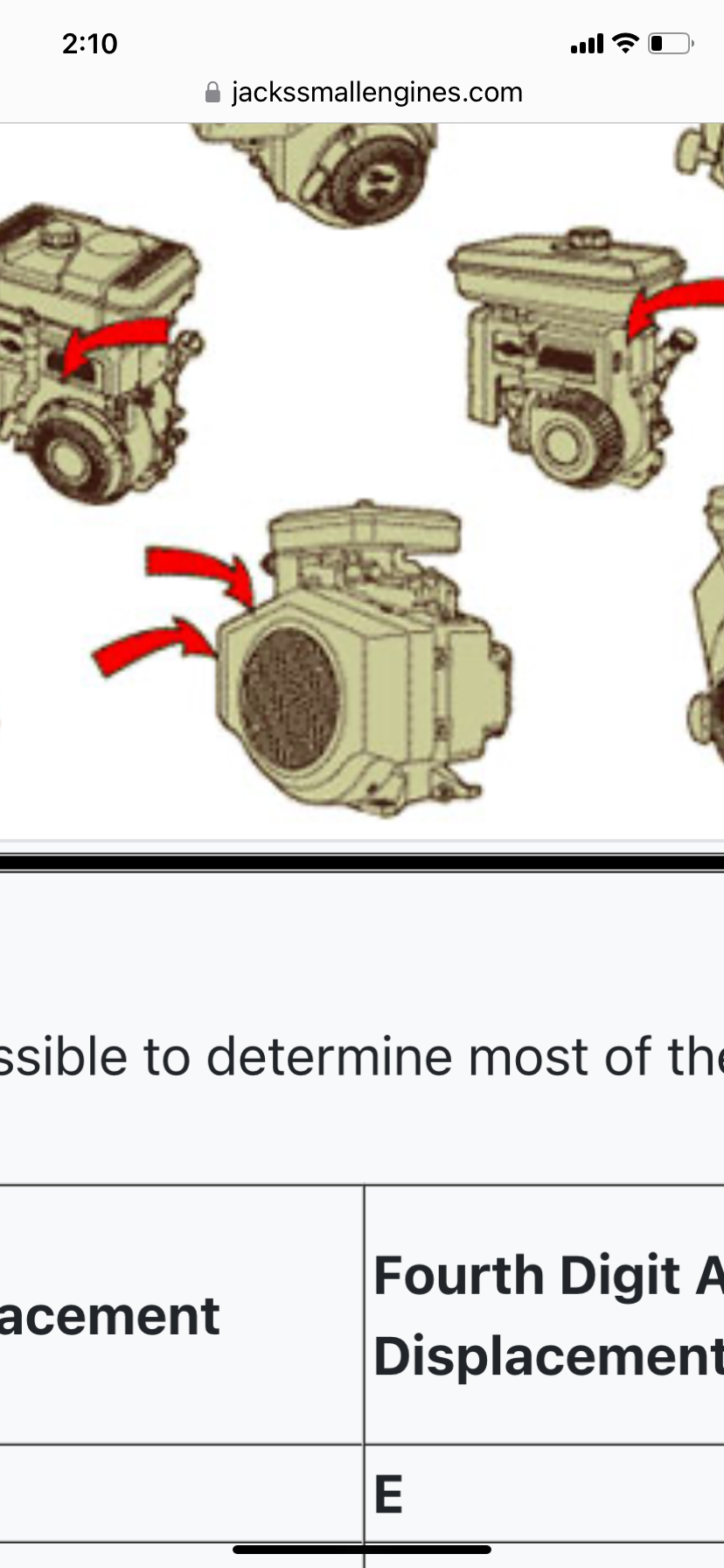

Red arrows show where numbers will be.I haven't been able to locate numbers. The guy I got it from said it was a1992 briggs and stratton twin 18hp i/c series
