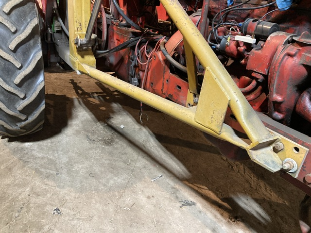

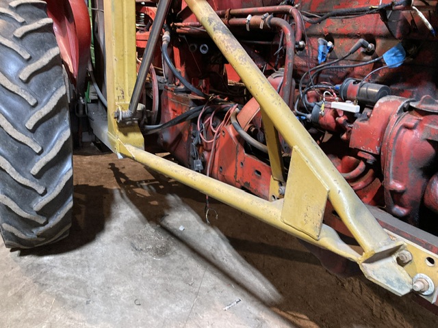

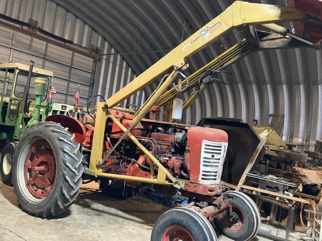

Does anyone have a super K loader on an Oliver tractor? I have one on a Farmall 400 that I would like to put on my Oliver 1550. If so, I need pictures of the mounting brackets. Measuring between the two tractors, it looks to be a tight fit and then I’d have to get on from the rear and the 3 point arms would be in the way. I know I’d have to make mounting brackets but didn’t really want to have to cut it apart and rebuild it. Might be easier to sell the 400 and loader and buy a different loader but the Koyker lifts a lot higher than most other loaders I have seen. Thanks, Chris

In your situation, I believe you need to look at the width between the masts/pylons on your loader. If there's sufficient room, figure out how to build some sort of sub frame/pins etc. to fit the tractor......which will also fit the loader as you see fit to modify it. It's a ton of work, but if you have the time, it might be very well worth it.........and something to look back on with satisfaction. If you do this, I'd wager that you'll spend more time thinking about it, than actually doing the work. Fabrication is about design, not welding. It's why engineers are at the top of the heap, followed by fitters, followed by finish welders.

Does anyone have a super K loader on an Oliver tractor? I have one on a Farmall 400 that I would like to put on my Oliver 1550. If so, I need pictures of the mounting brackets. Measuring between the two tractors, it looks to be a tight fit and then I’d have to get on from the rear and the 3 point arms would be in the way. I know I’d have to make mounting brackets but didn’t really want to have to cut it apart and rebuild it. Might be easier to sell the 400 and loader and buy a different loader but the Koyker lifts a lot higher than most other loaders I have seen. Thanks, Chris View attachment 93902View attachment 93903View attachment 93904
