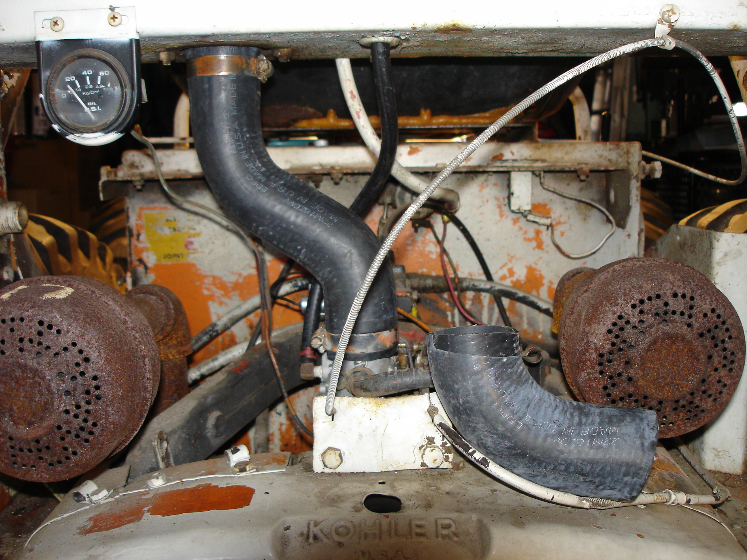

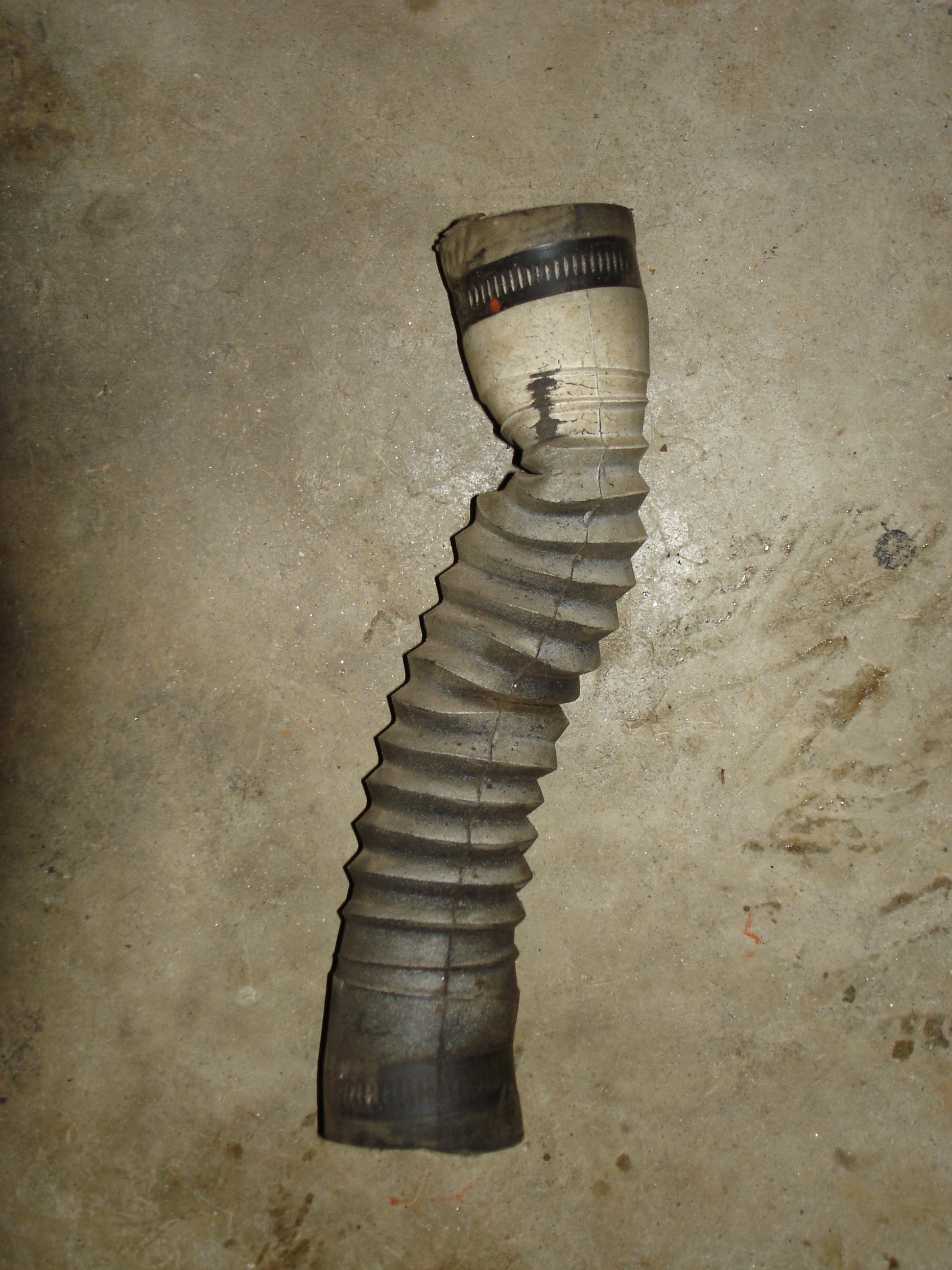

Many of you have probably been down the path I just traveled. I looked high & low for a suitable radiator hose to use for the air intake between the air filter and carburetor. I have seen a lot of people use those corrugated hoses like the one in my first picture below (which never seem to work very well). I went to NAPA and searched through a room full of hoses for the something 1-3/4" ID, 10" long, with a 4" offset. I found the perfect hose (NAPA #9414). The only thing you need to do is cut off the bottom elbow (shown laying on top of the engine in the second picture).

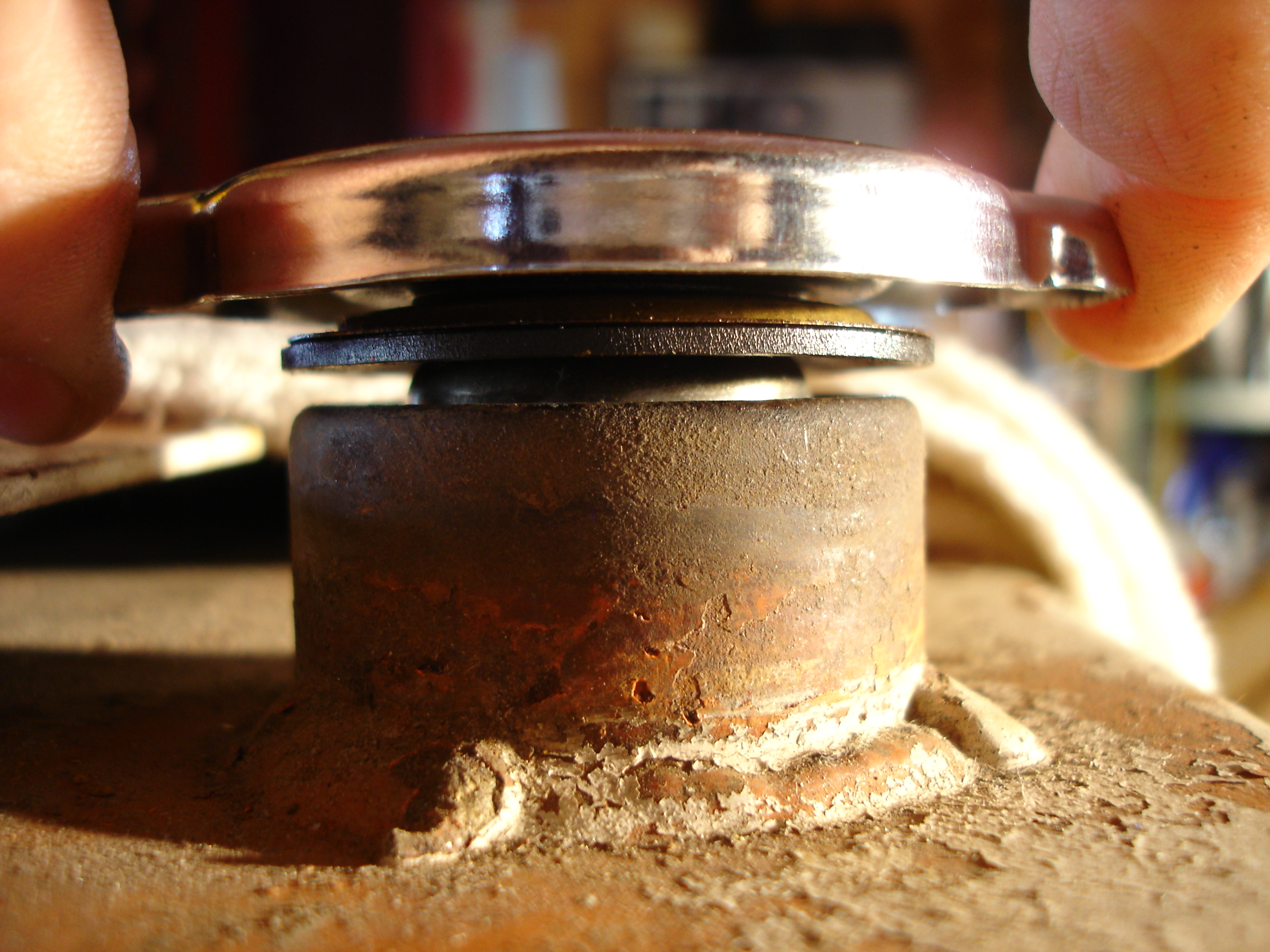

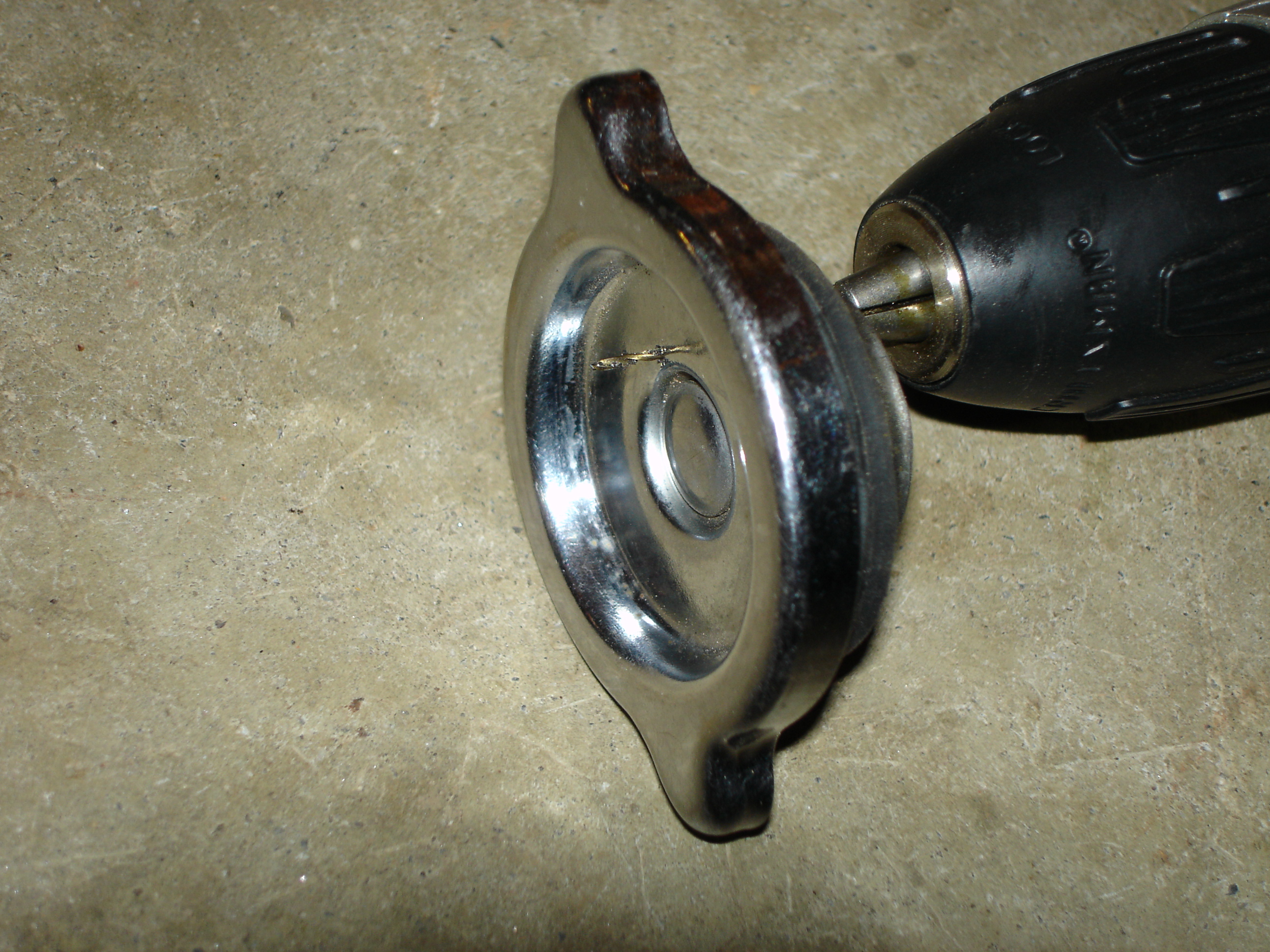

Another hard-to-find item is a gas cap that will fit these tanks. I read in one of the forums that a Mr. Gasket #2062 Oil Filler Cap will work.
Well... YES and NO
I bought one and it would not pull down tight without making a second 1/8" thick rubber washer for it. After making the washer, I drilled a tiny #57 hole in it to make it vented.
