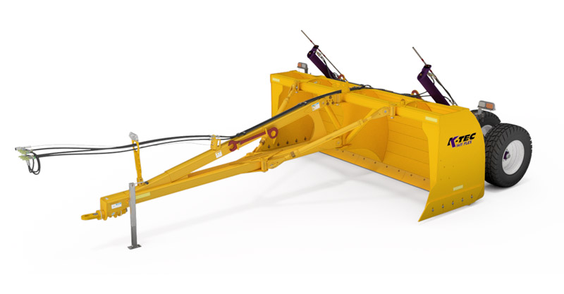

Land plane:
Or land plane:
If the first, easy. If the second, depends on how much you are going to work it.
Hi Thanks - it is a three point attached plane. Thanks for the input. I do think I am going to have to get some additional material but am hoping to get it into a shape where I can maintain myself. Below is a link:
Grader
