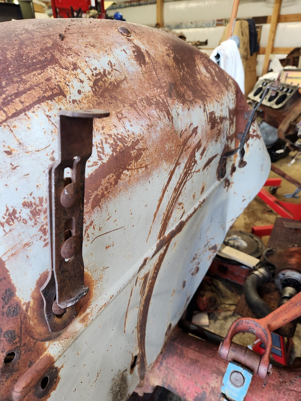

"Lazarus" has a couple of implement brackets (I guess?) mounted to one of the nearly destroyed fenders. Any idea what would've been carried on these?
the front and back brackets seem like they're sized to carry something 'flat' and about 5" wide. My other N had a grease gun bracket but nothing shaped like this. it's weird.
Could be overkill for lights. PO may have just used some heavier stock because he happened to have it laying around.
