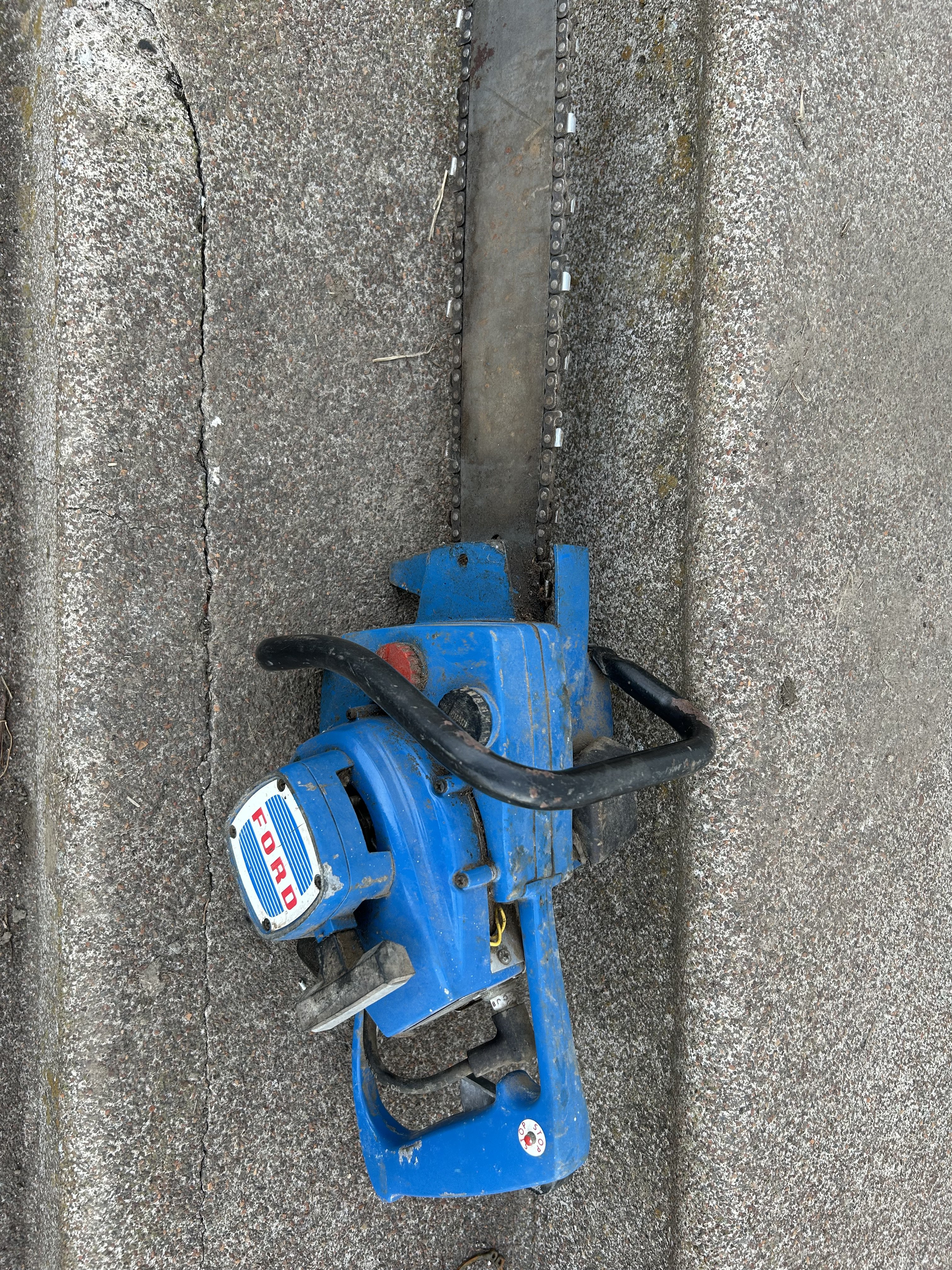

I was at a farm sale where there were about 50 different antique chain saws on a trailer. I won the first bid for $25, got to pick and I chose the Ford. About 10 guys came up to me afterwards wanting to buy it from me. Seriously, it wouldn’t be for a serious lumberjack, but most Ford collectors have never seen one in person.
If I ever see another, you’ll hear from me.

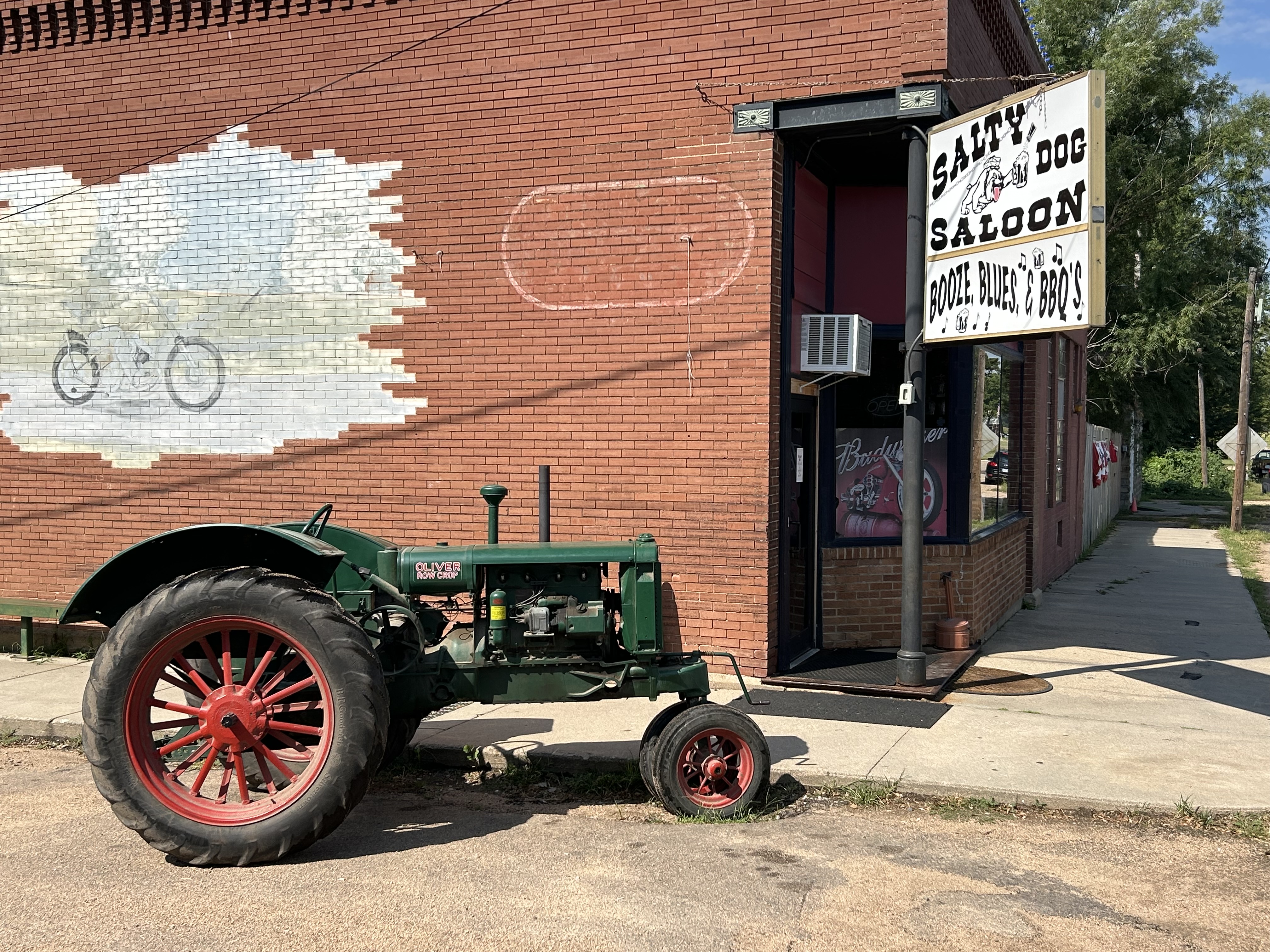

The foot clutch pedal is one the right. So when driving it, you have to unlearn everything that you’ve learned. It’s somewhat challenging driving it on a tilt trailer when you want to ease it on the trailer and brake at the same time. But, I digress, because this is a thread about Fords.
