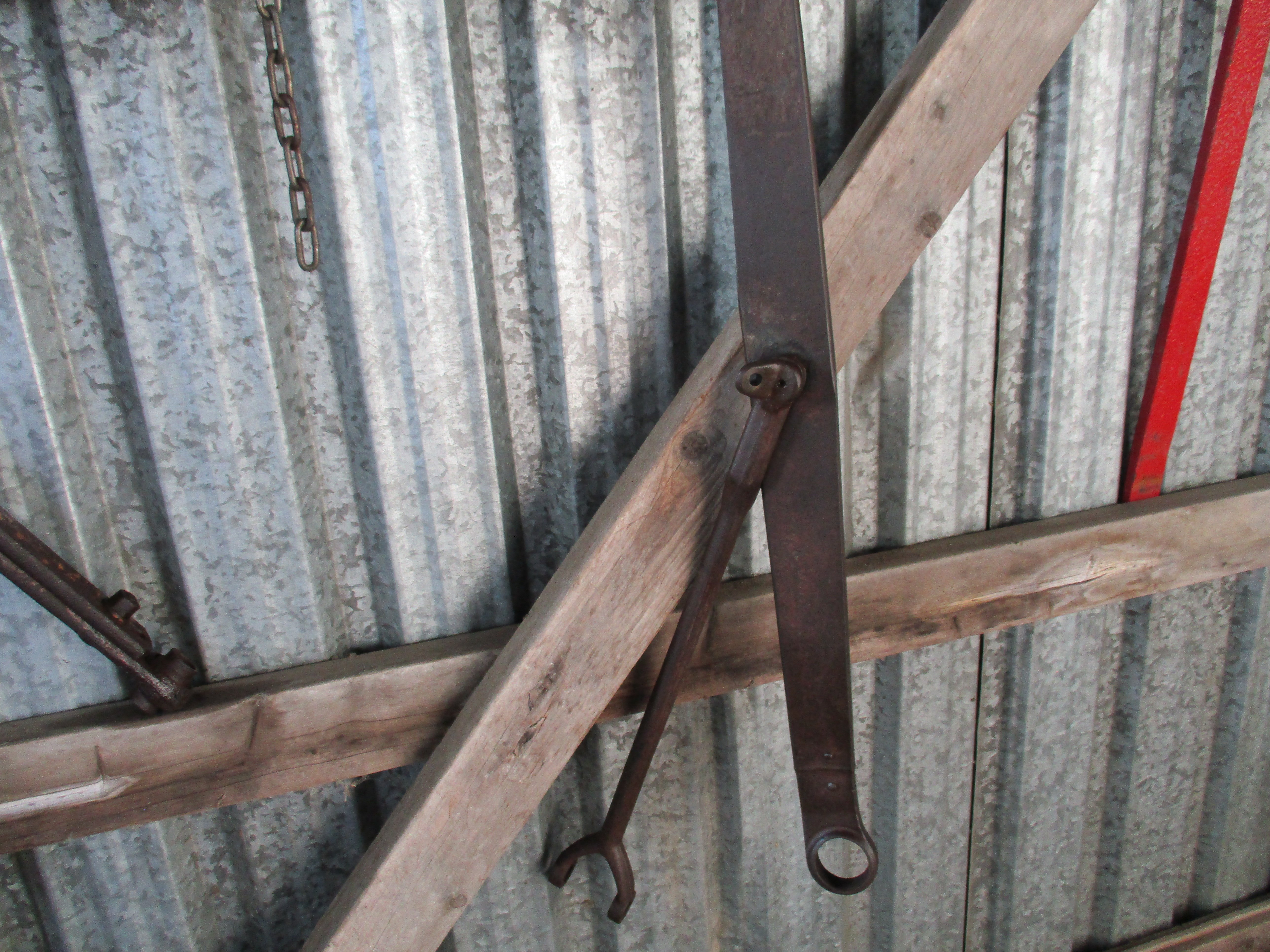

I have to remove the hardware from lower lift arm however it seems like it is pressed in.
The nut comes off the back but it won't move even with a few light taps with a ball-peen hammer.

Before you put the nut back on flush with the bolt and smite it, hold a heavy block of steel tight against the backside of the flat lift arm to minimize force being absorbed and lost to the free play.
