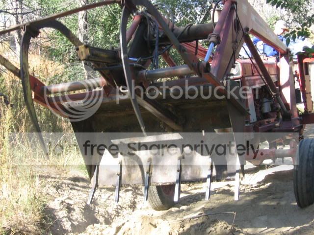

The biggest problem is the packed straw/ hay rolling out of the bucket, my prior loaders-buckets had manure forks, this one doesn't.
Didn't know if digging teeth would be enough to hold the hay in the bucket. Thought if a digging tooth bar would help, I'd go buy a bolt in job and be done with it.
Guess I could make some tines to bolt in the bottom of the bucket, the bucket already has holes in the bottom of it, sets of 2 spaced about 10 inches apart, probably to bolt in tines. Just a little concerned about the strength of the bucket lip with bolt in tines.
A project for another day, I'll keep fighting it for now, as the fields are dry enough that I can spread.
