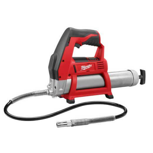

I bought a Milwaukee grease gun a few years ago. It is amazing what a game changer an electric grease gun is! Put a Lock-N-Lube style fitting on it, and you will stay home from church just so you can grease all the fittings on the farm.
I’ll second the Milwaukee. I’m sure there are other good grease guns out there but the Milwaukee is pretty nice.
Mine is 18v battery.

Wow $172 for the bare Milwaukee tool ! I have a lot of Milwaukee tools but that's too high for just pumping grease.

I think it’s worth it, it makes greasing almost fun. I have 2 of them, one in the truck and one in the shop.
I’ve found that the easier you make the job of greasing the more often you will do it.

The Milwaukee is good, but I'm sure most of the others available are as well. You'll probably want to stay with whatever battery system you are using for your other tools. At least that's what I do, so I don't have a bunch of different battery types and chargers, plus I can have fewer batteries that I can share among tools. I think most major brands offer them now. If your're patient, you can find sales and such, even for Milwaukee, like this one
$143 at checkout, without battery. Acme Tools also has sales and closeouts. Anyway, an electric grease gun is one of those things that you will wonder why you did without one for so long once you get it. Some things are just worth it.
