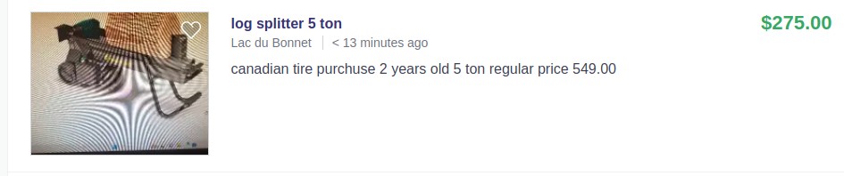

Hydraulic-Electric log splitter repair
So my son’s father in-law gave me a non-working log splitter a few years ago.
I thought I could get it working again since I consider myself a bit clever (at times).
I could get the motor to turn only if I first spun it by hand at the electric motor fan.
I also had a bunch of logs sitting that I wanted split. Always done by splitting axe previously.
Looked the model up on line and found that many people complained about the same exact problem. They all said it was the starting capacitor. And, ‘that world famous on line retailer’ that sells everything had the exact replacement for the ‘burnt out’ starting capacitor.
All the comments said...’works great, problem solved’. After a few attempts at replacing the capacitor with other ones of similar capacitance I had laying around, but not exactly the same capacitance, it was still a no go. So I bought one of the exact type from the on line retailer.
It came a week later and I put it in place...NO GO, again. $25 wasted because it was listed as ‘no refunds’.
The logs were still sitting ready for me with the axe. But I had a ‘log splitter’ sitting in my shop too.
Well, after careful consideration, I figured I had nothing to lose on the hydraulic-electric splitter and tore it apart, motor first. I read what ever I could find on line regarding this very common model log splitter, found nothing helpful at all. Lots of info on how to use it, precautions, warnings, where not to operate it, but nothing on how to repair it.
When I opened up the motor I found that the wires going to the motor ‘starting windings’ were broken, that's why the motor would start if I manually spun it first. Actually the wires were corroded through. Easy fix I thought...got the soldering iron out and proceeded to repair the broken wires. NO GO. The wires were not made of copper so the solder wouldn’t stick. Electrical solder does not stick to steel.
The cheap @ss manufacturer used steel wire for the motor windings instead of copper. They must have saved at least $5 on each unit sold. Scratched my head on that for a while but eventually used a mechanical crimp to reconnect the winding wires. It worked. I split all the logs I had over 2 weeks and never looked back at the axe. This log splitter retails for $450 to $600 new. Now for me that’s kinda steep, considering I could burn nat gas for 2 months for that price.
What did I learn from all this?
- manufacturer says log splitters are dangerous and should never be used for splitting logs
- manufacturer says never use log splitter outside/outdoors, they are dangerous and you could get injured or killed
- manufacturer says do not use the device if the temperature is below 20C or humidity less than 50%
- manufacturer says there is a risk of electrical shock if you plug it in to use it
- manufacturer says the device is not intended for splitting logs
- manufacturer says it might split logs so be careful
- on line retailers like to sell parts and have a lot of ‘bots’ saying the right things to make you buy repair parts and stuff that don’t work but make tons of $ for the on line retailer
- manufactures will use the cheapest most inappropriate materials possible to save a buck
- consumers are gullible idiots and will gladly overpay for ‘labor’ saving devices.
- lead solder doesn’t ‘stick’ to steel
- 20 ton log splitters with gas driven hydraulics are insane
- a log splitter with more than 16” of stroke is insane too, cut the wood to 16” or less first
