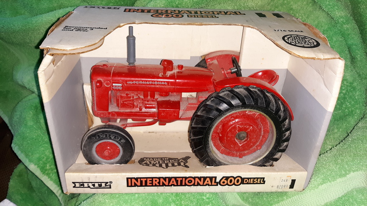

Ahhh yes read the others. But they are such a big chuny beast. No rear hydraulic drawbar. Just brute power. I would like one too but I DO have a cast scale model of one !!

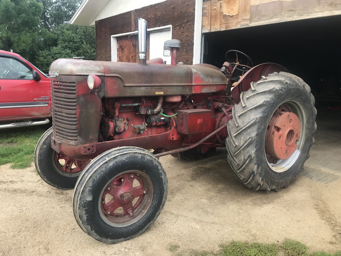

Here we are. Took a picture of my 600. The biggest of the beasts. There was a restored one at Kinzer show. Man that thing was big.
