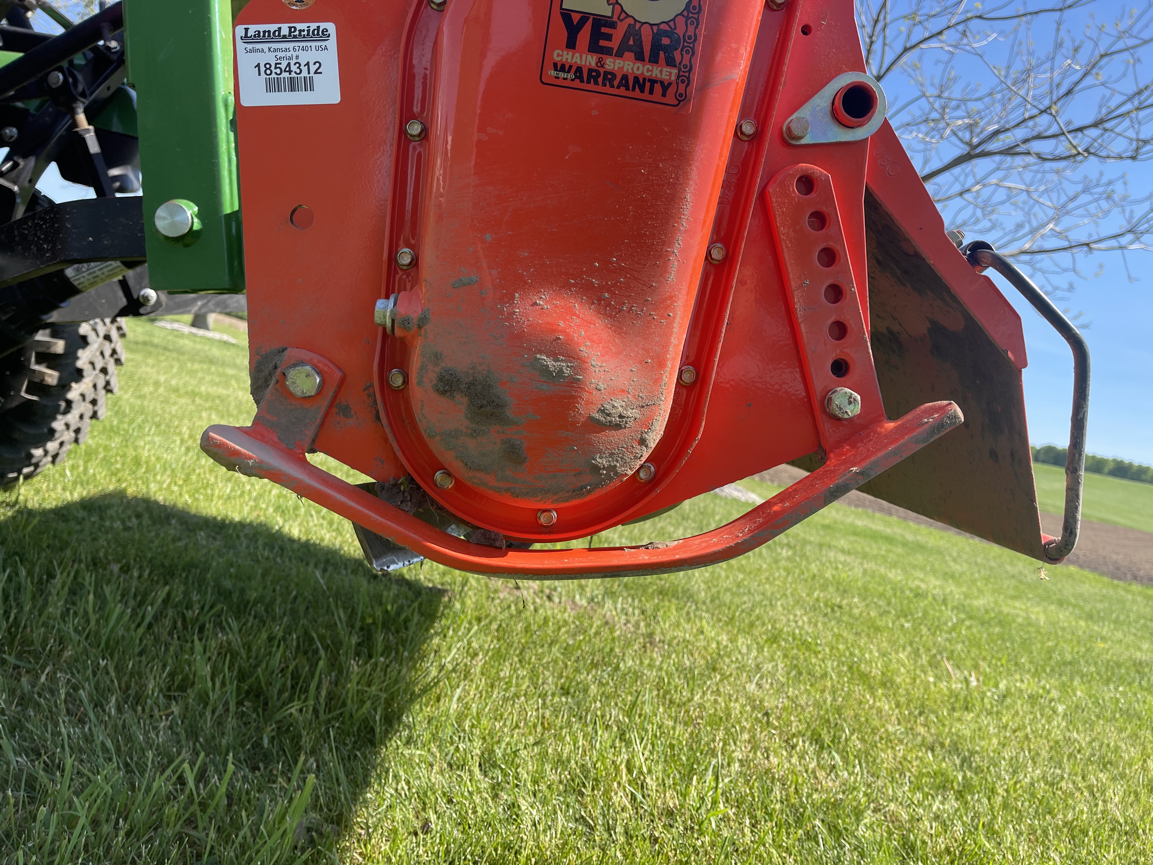

More images of my Mother’s rototiller on the 1025R . The hydrostatic ground speed is handy .iirc the lighter units use a #80 drive chain and the heavier units a #100 drive chain ?
Even when adjusted to the max. The first pass is rather shallow . Have yet to attempt swapping the skid shows side to side in order to gain 1/2 an inch .
The subsequent passes are deeper as the skid plates sink into the soft soil .

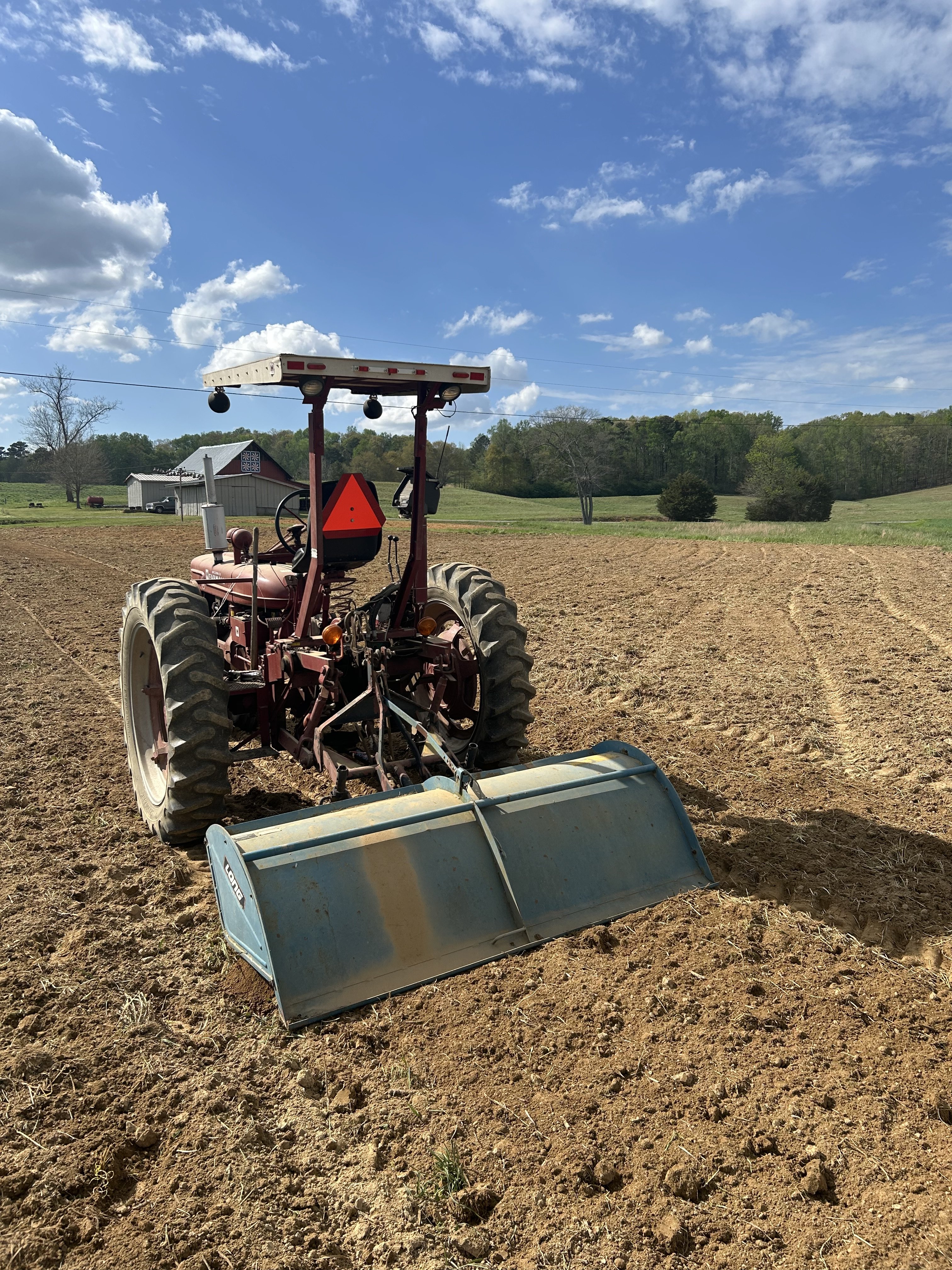

Run a 6 ft behind a FARMALL h. Works great in plowed up ground. Ran thru the middles of my gourds week ago. Actually ran in 2nd gear. Left the ground perfect. Picture is when I was doing away with some clods and trash.

My FARMALL h in 1st gear is fine. I do not use the tiller to fix ground. I use it to do a final prep. In soft ground such as cleaning the wide middles in watermelons or gourds or such 2 nd gear does great.
