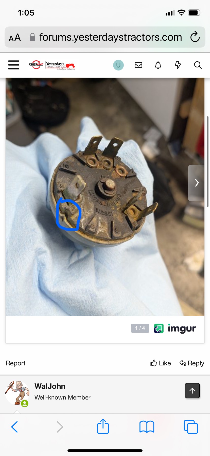

I've got a headlight switch for my 1970 David Brown 990 tractor. It works but moves a little stuff. I'd like to fix it if possible rather than replace it.
Any ideas how to get it apart?

You are correct the snap ring is not holding the bottom on, the staked areas are holding it on, see pic. Just a bit of warning the staked in parts of the housing may break off when you attempt to bend them back. I would try flooding the shaft with your favorite penetrating oil while working it back and forth. Eventually the lube might find it way to where it is needed. A more aggressive approach would be to drill a small hole the size of a can straw about midway of the cylindrical part of the housing and spray your lube in there. Might try to locate it where it will face down when installed or seal it with a dab of RTV.I thought the e clip was holding the shaft in, I didn't consider that it was holding the bottom on

No need to disassemble the switch, just gently spray a penetrating oil onto the shaft, into the switch, while working in/out. If the rheostat is not working, replace the switch, it's beyond repair.I've got a headlight switch for my 1970 David Brown 990 tractor. It works but moves a little stuff. I'd like to fix it if possible rather than replace it.
