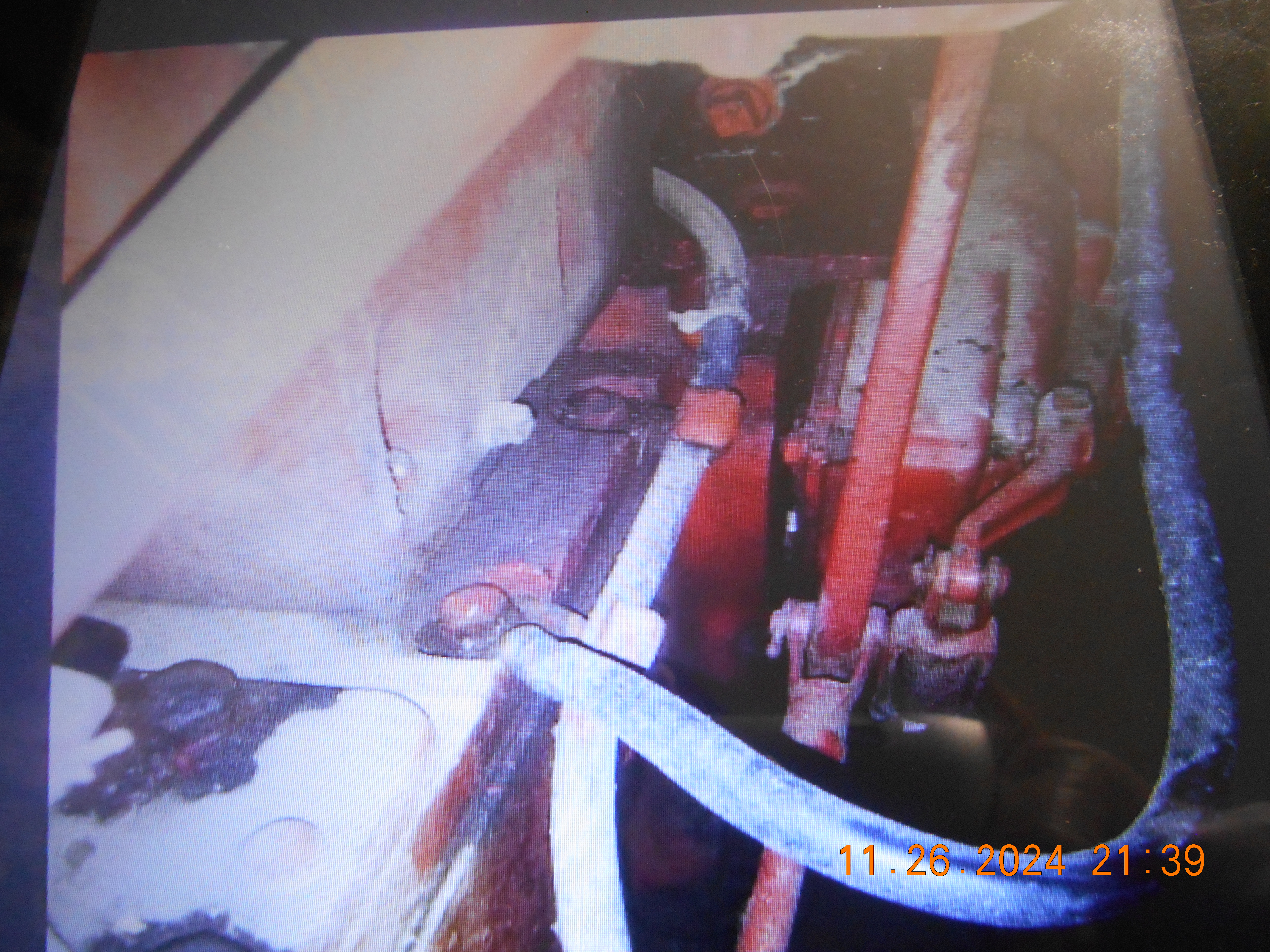

Here's some pictures, although I've put some stuff back on temporarily as I just broke a brake line on my car and need to kick this out of the garage for a bit. Not much to see but it sounds like the SuperM clutch may be different than others? So maybe can clarify that facet.

Can't tell for sure from angle if you have the adapter plate for a SM. About have to be one since almost all SM transmission housings didn't have bolt holes for cover or hole fore brake band operating shaft. Later SM didn't have bolt holes drilled in transmission cover also. From picture it looks like bolt for clutch operating lever may be screwed into transmission top cover. Regardless of if in cover or adapter plate would try heating cover where bolt passes through. Almost has to be stuck on it, or brake band shaft stuck in hole if not brake band. Does your tractor have the plate behind cover like picture? If just shift lever broke and not casting it screwed in, no big deal they can be made pretty easy, or thread end welded back on end.

Yeah there is a plate that the cover is bolted to. In the side picture you can see where I stuck a prybar between the two and it bent the plate. The bolt doesn't go into the transmission cover as I've had that off previously (if I knew I should have messed with this bolt then). I haven't tried heat yet so that's an idea.
OK I got back to this. I ended up getting a slight gap between the cover and backing plate and cut the bolt there. It was frozen into the cover, as once the cover was off I was actually able to unturn the remaining threaded stub with just fingers.
