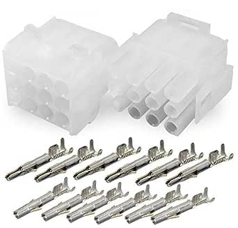

GB, what's a "molex" connector? Never heard that term, thanks
Molex connectors been used in electronics for years. Basically plastic connector. Get a meter and do some resistance checks,
