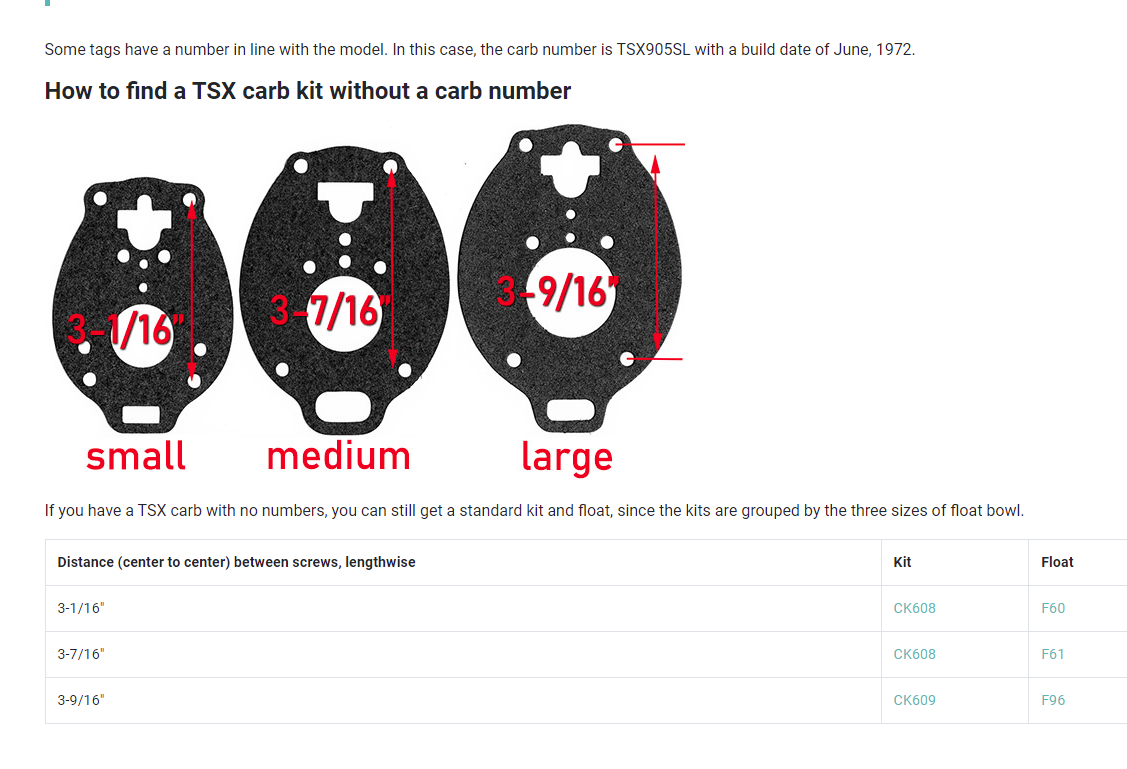

how do you identify the size of the carb by the numbers small mediam and large without a brand of tractor or model if someone is looking for say the mediam size body for a one off custom application , say tsx---- or zeinth---- how big or what is in it ?

In that case look in the parts area of this site. A carb for an 8N is the small the one for the 600/800 series if the medium and the one for the 601/801 is the large
Are you trying to identify one that does not have any tag on it? M-S are basically three sizes with three types of load adjustments. Zeniths are more complex with many different types. Both should have some kind of brass tag to identify. One of the carb suppliers has pages listing which components are used by carb number. I stumbled on them once but can[t remember which site it was.
Here's for the MS carbs:
There's more info out there on venturi and jet sizes, if you search long enough. steve
