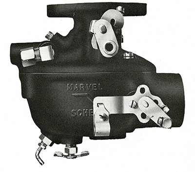

Another question for you. My carb is missing the bracket where the choke cable attaches to the carb. We don't have any tractor scrap anywhere nearby, and I'm having a hard time putting my fingers on one on the internet. Got any suggestions? steve
