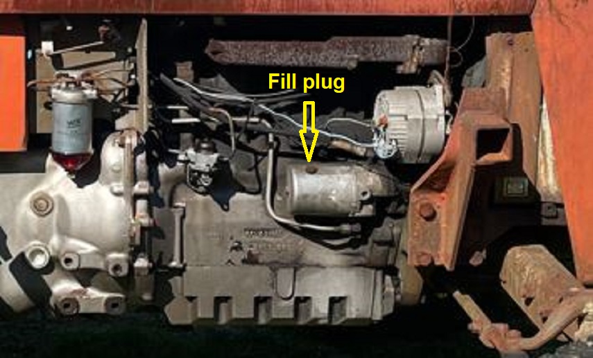

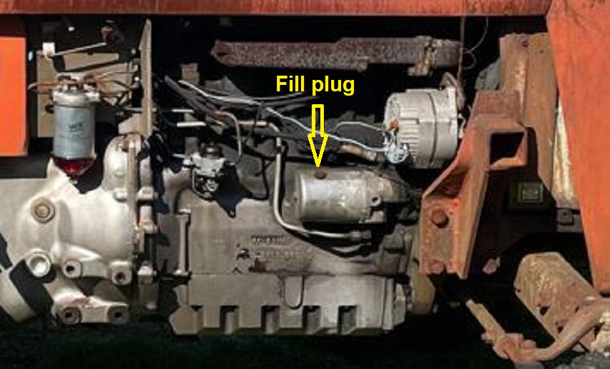

Does your power steering pump look like this one on a 255.

Yes. That's what it looks like. Has a loader on it, a little difficult to get to. What type of oil goes in there? The tractor is about a mile away, have to drive it to my garage to work on it. Hope the oil stays in long enough to get it here. Is that fill plug a screw?

I run UTHF in mine.
