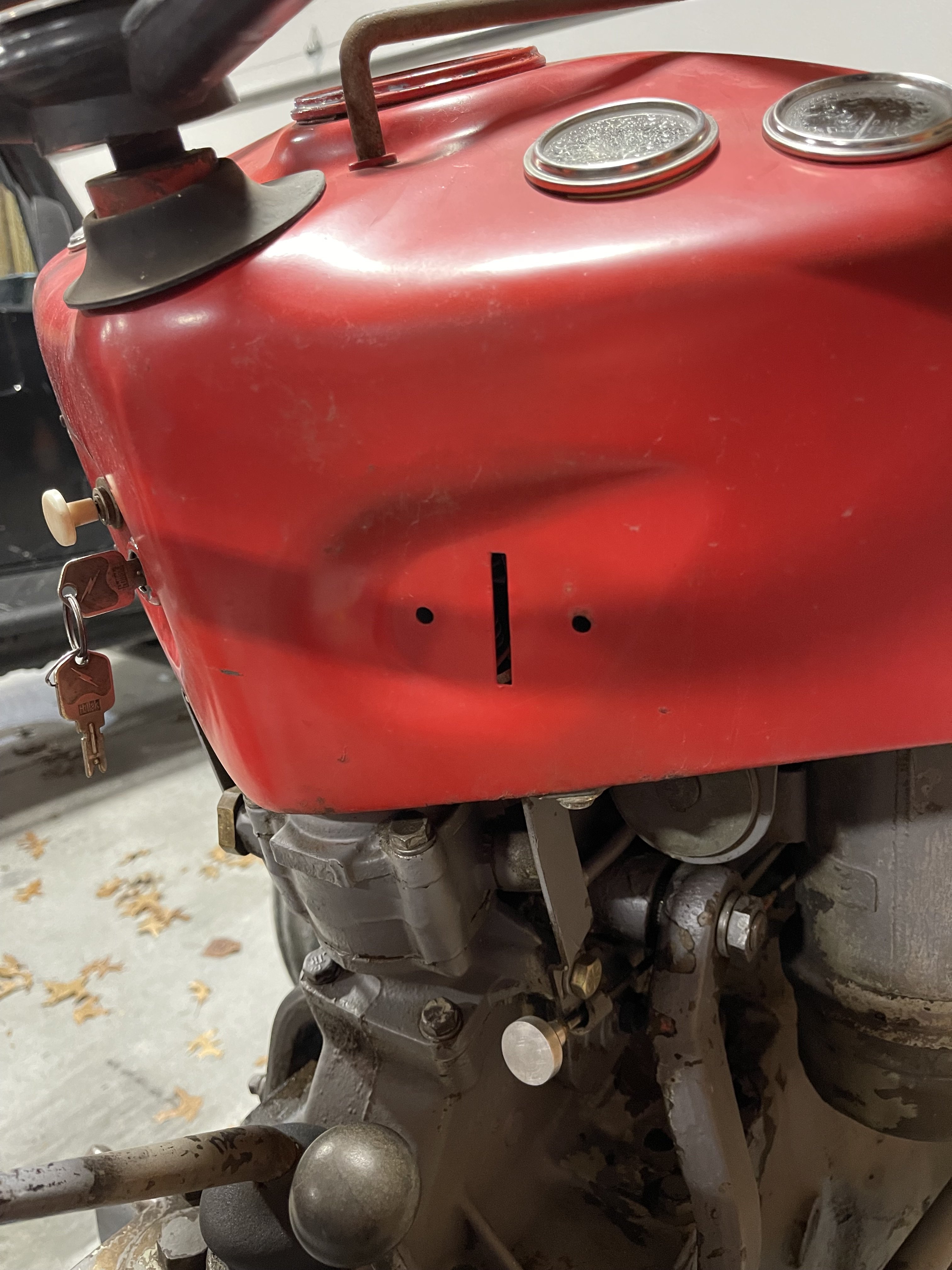

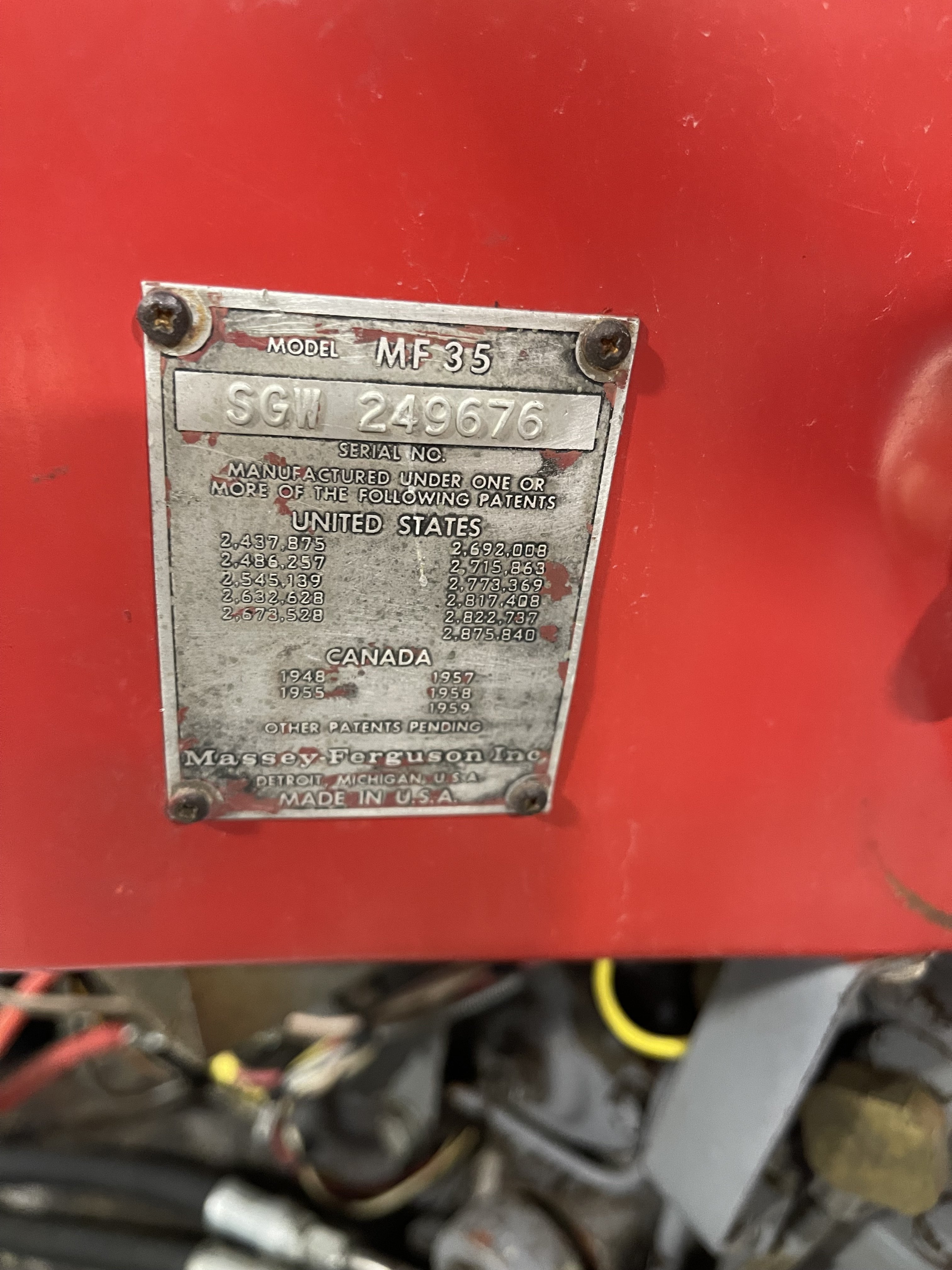

I recently purchased a Massey Ferguson 35 on an auction. From what I can figure by the S/N, it is a 1964 Standard gas version with multi power. I’m wondering if something was removed or bypassed? Not sure what is missing here.

Is it possible to remove or bypass it? The weird thing is I can feel something engage when I’m on a hill and push in the clutch. It holds the tractor in its position. Also high range and low range seem really far apart.
I believe the SGW means standard/utility chassis, gasoline engine, multipower transmission. 249676 would be a 1964 serial number.
Multipower is a hydraulic controlled gearing. High range of the multipower transmission will hold the tractor from rolling backwards if in a forward gear headed up hill or from rolling forward if backing up a hill. Low in multipower will freewheel going downhill in any gear. The high and low range with the short shift lever are mechanical gears so they are what they are. From your description someone removed the selector for the multipower, with it in high to prevent freewheeling downhill. To me the best answer is to restor the multipower control and learn to use it. The only way to safely bypass it would be to change to a regular transmission. I think low is aboout a 33% reduction from high in the multipower and it is shifted between them without using the clutch.

The serial number indicates multipower. Your description of it not rolling backwards if you disengage the clutch when headed up a hill is what a MF with the Multipower in High will do. I have to believe that someone removed the shift lever and maybe some of the linkage. They may have locked in Hi due to a problem with the low side of the Multipower, or just to prevent the downhill runaway if one forgets to shift into high when heading down hill. There is no engine holdback through the transmission in Low Multipower.
