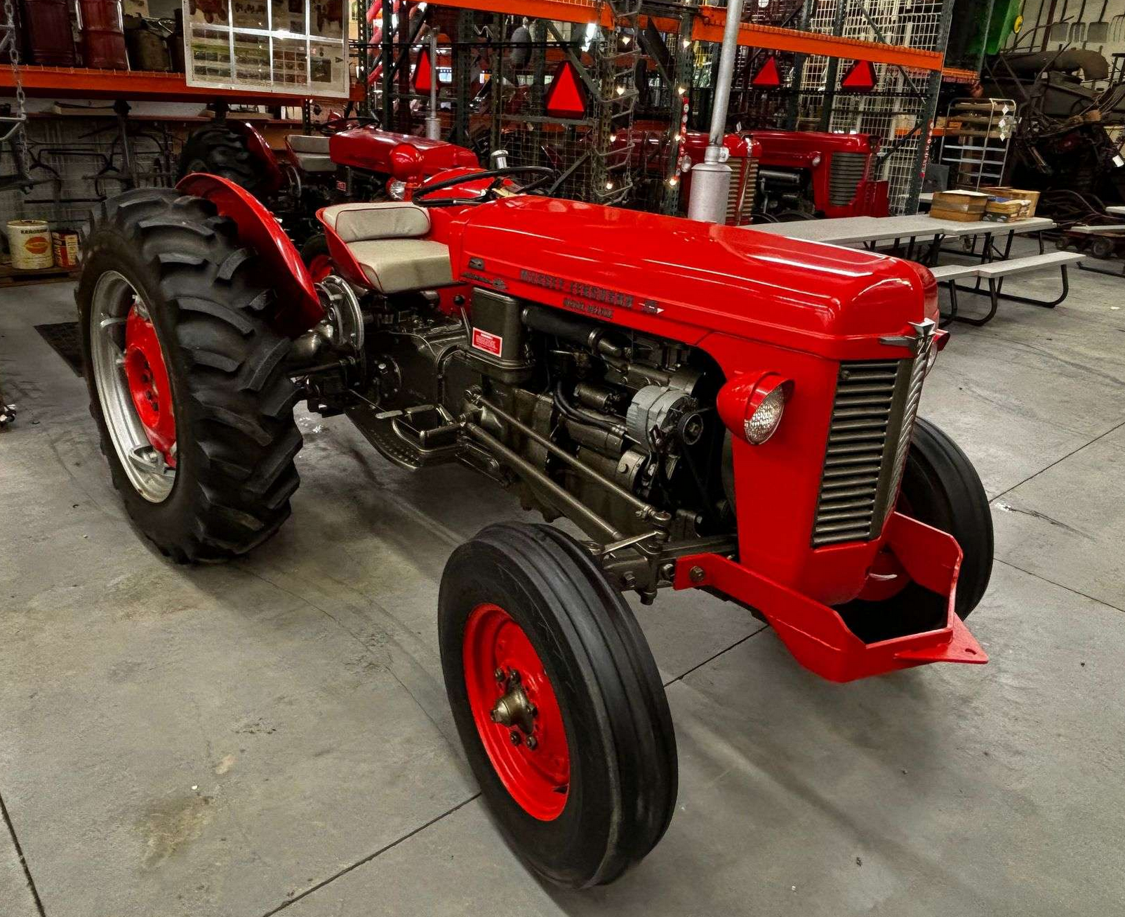

Sounds like a Massey Ferguson 35 Deluxe with the Perkins 3.152 engine. Does it look like this:
When I first looked at your picture I busted out laughing. Boy do I wish it looked like that. That aside, it does look like the same tractor apart from the fact that somone changed the air cleaner on mine. Everything else looks the same except that mine looks like it went thru the World War. Thankful I don't have much in it.
