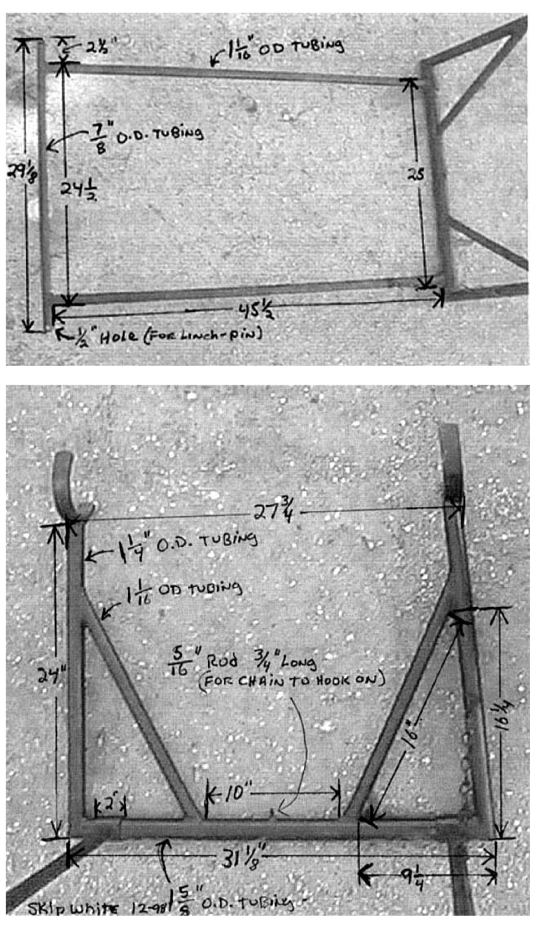

I have a Massey Ferguson 135 Deluxe and was wondering if anybody has a Ferguson Jack and was wondering if someone would be willing to send me the dimensions for one. I would like to fabricate one for my use and probably would like to make it heavier duty, for safety purposes. I use a farm jack now and think the MF jack would be a lot more convenient. Thanks in advance.

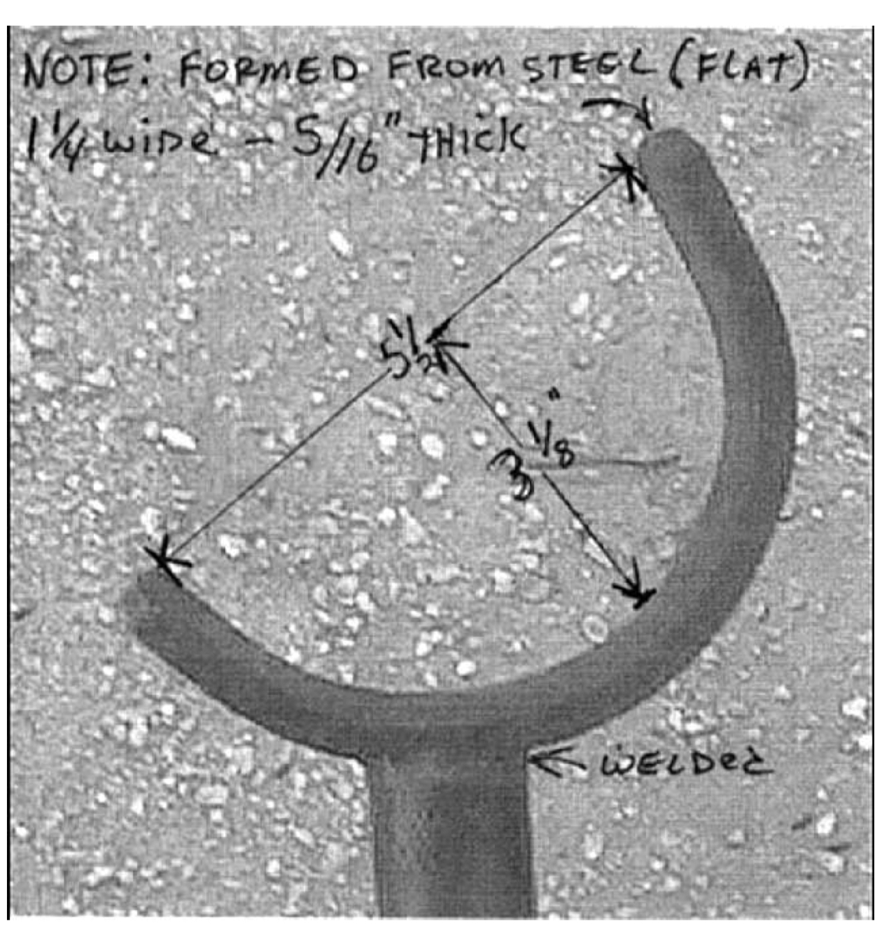

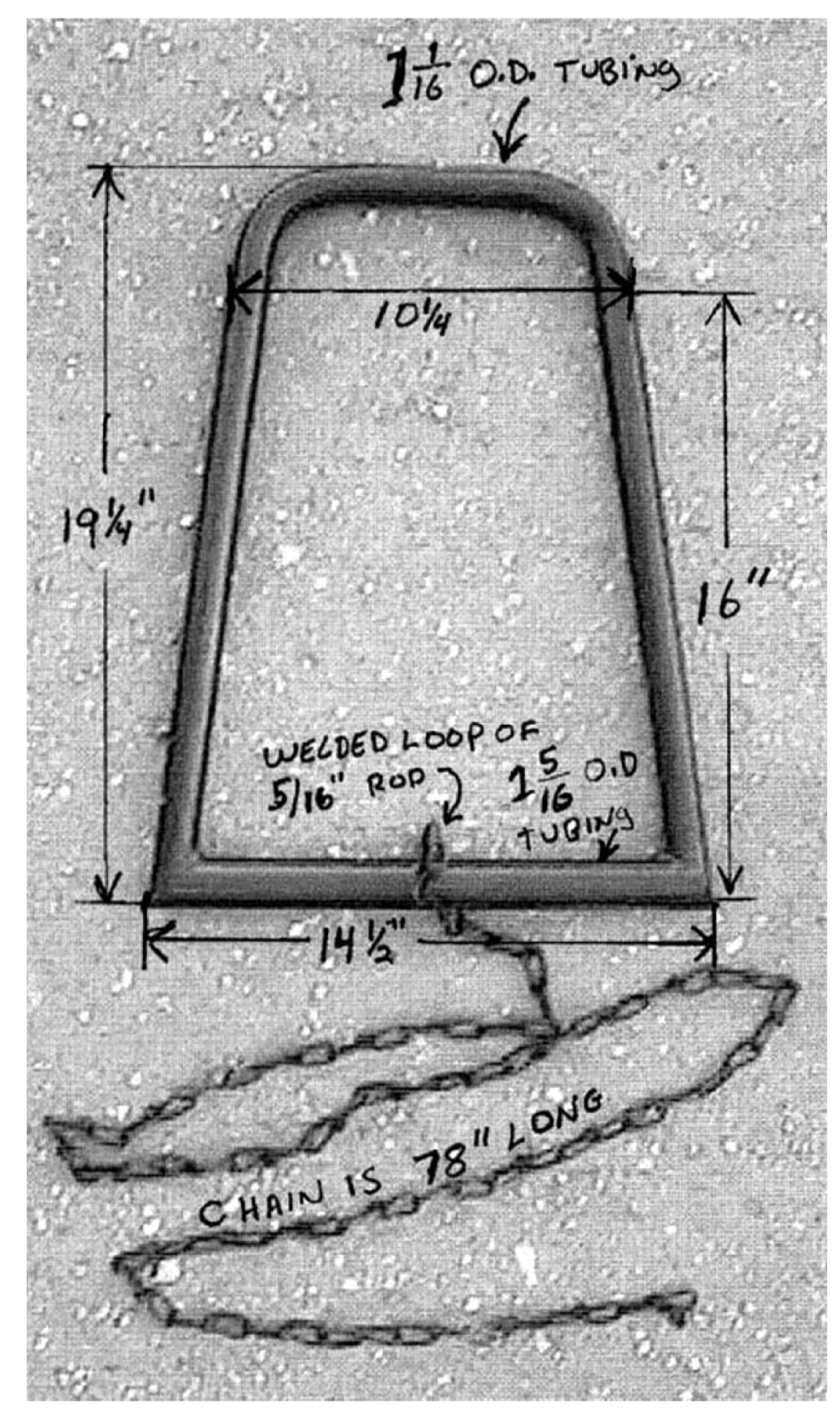

FORD-FERGUSON had a tractor jack, made by the KP Mfg co that was a self-levitating device and could raise the tractor up off the ground in order to change the wheels/tires. There are two parts. Rear connects to the 3-PT and front has a brace that goes under front axle. As you slowly and carefully raise the 3-PT Lift it will cause the wheels off the ground. Original jacks pop up often in ADS and on ebay. I don't know if a 135 or larger will handle the jack so it's your call and your liability. I/WE ARE NOT responsible for any damage or injury sustained.
Now, years ago a fella, Cargo-Cult, made his own based on this design. GO to NTC to FIND instructions.
I ALSO WROTE AN ARTICLE ON THE TRACTOR JACK for the N-NEWS, Summer 2012. SEE PIX
