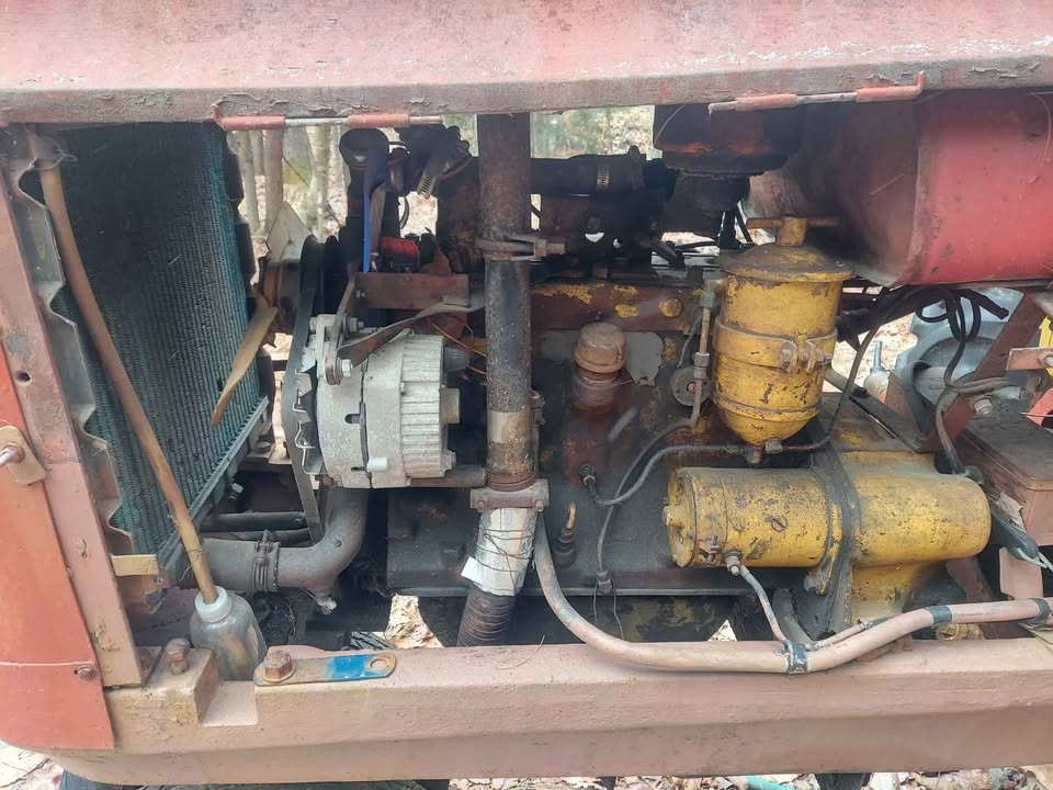

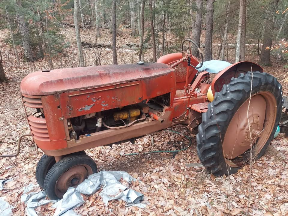

Is this a 101 Jr or a 20. The thing that gets me is the distributor under the carburetor.The F124/ F140/F162 all look the same OUTSIDE. You won't know for sure what it is until the head is pulled to measure the bore size, all three had a 4 3/8 inch stroke.
That's NOT a distributor, it's a MAGNETO. Flathead Continental engine have the distributor on top of the cylinder head.Is this a 101 Jr or a 20. The thing that gets me is the distributor under the carburetor.
I would say it’s not a 20. There’s no louvers in the side panels. And the hood looks different.Is this a 101 Jr or a 20. The thing that gets me is the distributor under the carburetor.
The told me its a Massey Harris 101 Jr. 1943 as I dig deeper it seems this motor might be a f163 out of a welder.I would say it’s not a 20. There’s no louvers in the side panels. And the hood looks different.
Well if it runs and works good it will be a good tractor for you. Doesn’t matter what engine it is unless you are wanting it original.The told me its a Massey Harris 101 Jr. 1943 as I dig deeper it seems this motor might be a f163 out of a welder.
The tractor model and serial number is also stamped at the top left trans edge, next to the clutch pedalThe told me its a Massey Harris 101 Jr. 1943 as I dig deeper it seems this motor might be a f163 out of a welder.
It is probably a 101 Jr, with some changes. The oil fill spout is in the wrong place for an F124, 140, 162. The engine ID tag is behind and above the starter, behind the oil filter lines and canister on the L-head Continentals. Look along the block/oilpan rail, right side facing forward, towards the rear for the block casting numbers. The F-series Continentals will say F400 there. Like Dieseltech said, the tractor serial number is stamped into the transmission case rail, between the tranny cover and the implement lift cover. Most of it, except that sheetmetal engine curtain looks just like my two 101 Jr.s. steveCan you tell me if this motor goes with this tractor? Its a 1943 Massey Harris 101 Jr. View attachment 99837View attachment 99835
Normally, the oil fill cap would be right behind that aluminum tape on the exhaust pipe. Your block may have an unmachined casting there. It may be an F162 out an older Lincoln welder. Maybe an F163 out of a newer one. steveIt is probably a 101 Jr, with some changes. The oil fill spout is in the wrong place for an F124, 140, 162. The engine ID tag is behind and above the starter, behind the oil filter lines and canister on the L-head Continentals. Look along the block/oilpan rail, right side facing forward, towards the rear for the block casting numbers. The F-series Continentals will say F400 there. Like Dieseltech said, the tractor serial number is stamped into the transmission case rail, between the tranny cover and the implement lift cover. Most of it, except that sheetmetal engine curtain looks just like my two 101 Jr.s. steve
