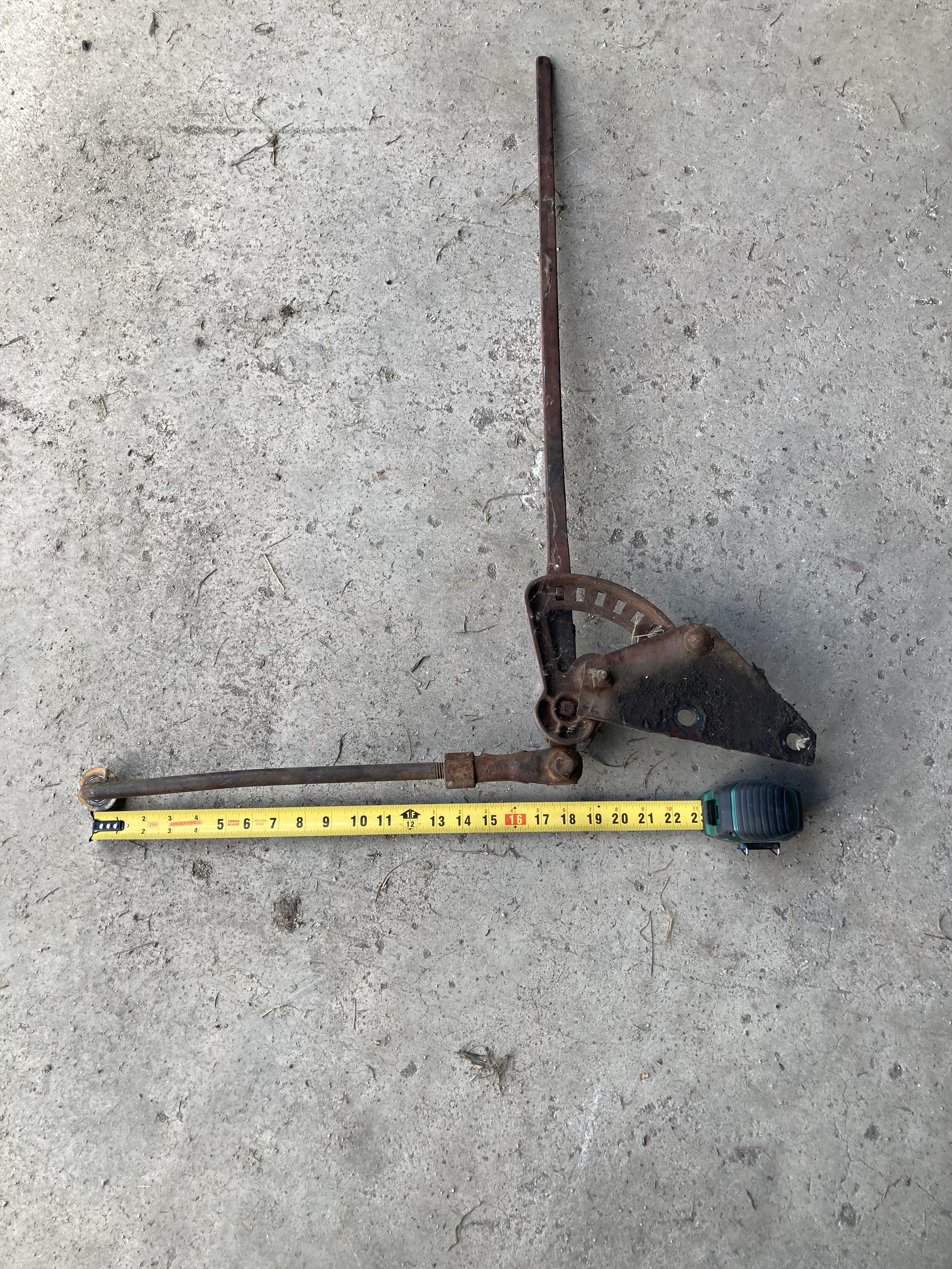

Should be a lever mounted on the inside of the right fender that adjusts the pitch of the cutter bar. By the angle of the cutter bar in your picture, I would think yours is missing.
Unfortunately, I do not have a picture, and my mower is not currently on the tractor.
Thanks there is a lever with adjustable notches but nothing is connected to it I probably could make something or use a heavy chain but don't know on the mower where to hook it or if something is missing

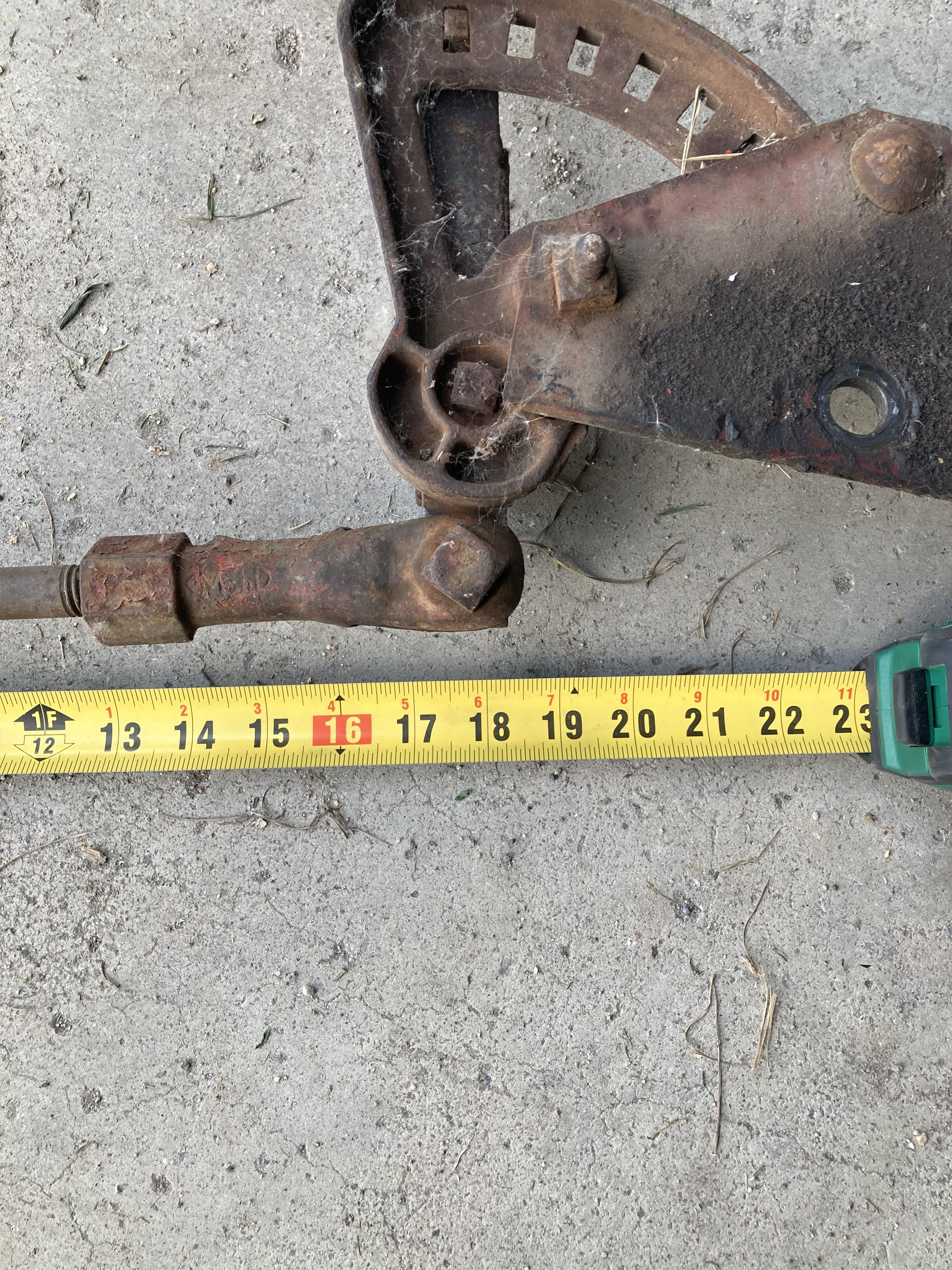

Hope this helps. Pic of the linkage is as if you were looking at it from the seat side.

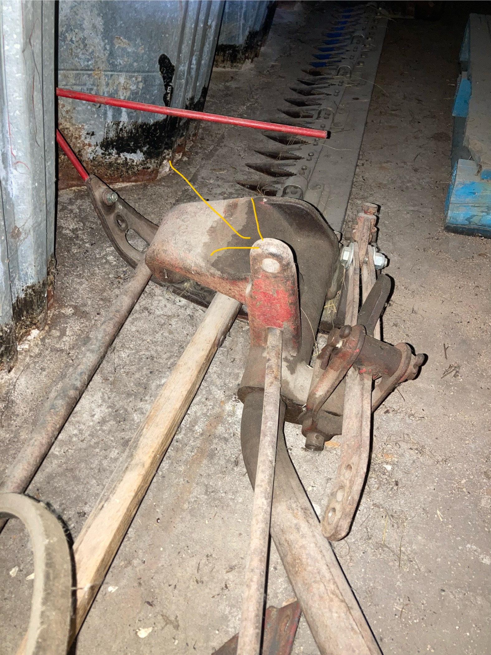

This is where the rod connects.
Thanks that really helps me to get it right I appreciate the pictures and measurements someone welded a bolt where the arm sticks up from the mower I dont know how much was cut or broke off. pushing the bar up straight by hand takes A lot of effort that rod must hold a lot
