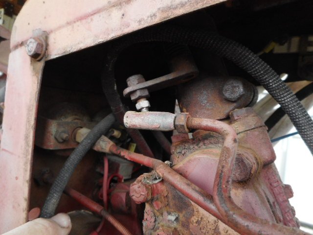

Can someone help me figure out what I am missing on a 1949 Massey Harris Pony throttle linkage?
I can't figure out how the throttle lever attaches to the throttle rod. The lever has a small hole drilled through it and the throttle rod has a ball and socket connection.

The Governor control Rod that runs from your steering column forward to the GOVERNOR control ARM is attached to the GOVERNOR control ARM by only a SPRING.
Then a short ROD Governor to Carburetor linkage from the GOVERNOR control arm, attached to a ball on the Governor control arm is attached to the Carburetor Throttle shaft lever assembly
What component/ components is your Tractor missing?
NOTE Items # 1...3...4.....5
Item # 1 Governor to Carburetor linkage
Item 3.
...Governor control Rod
Item 4......Governor control Rod SPRING
Item 5.... Carburetor Throttle shaft and lever assembly

The missing part is on the throttle lever end.
It may be of value,if you start a new thread?...post these pics,state your location,ie Town,State / Province ,Nation? Good possibility you shall receive information on location to obtain LEVER. I have TWO parts Tractors MH Pony's. The lever you require is RUSTED SOLID to the SHAFT. You may consider replacing the lever and shaft as one component?

Thanks for the pics, I'm hoping I can fabricate something to work
