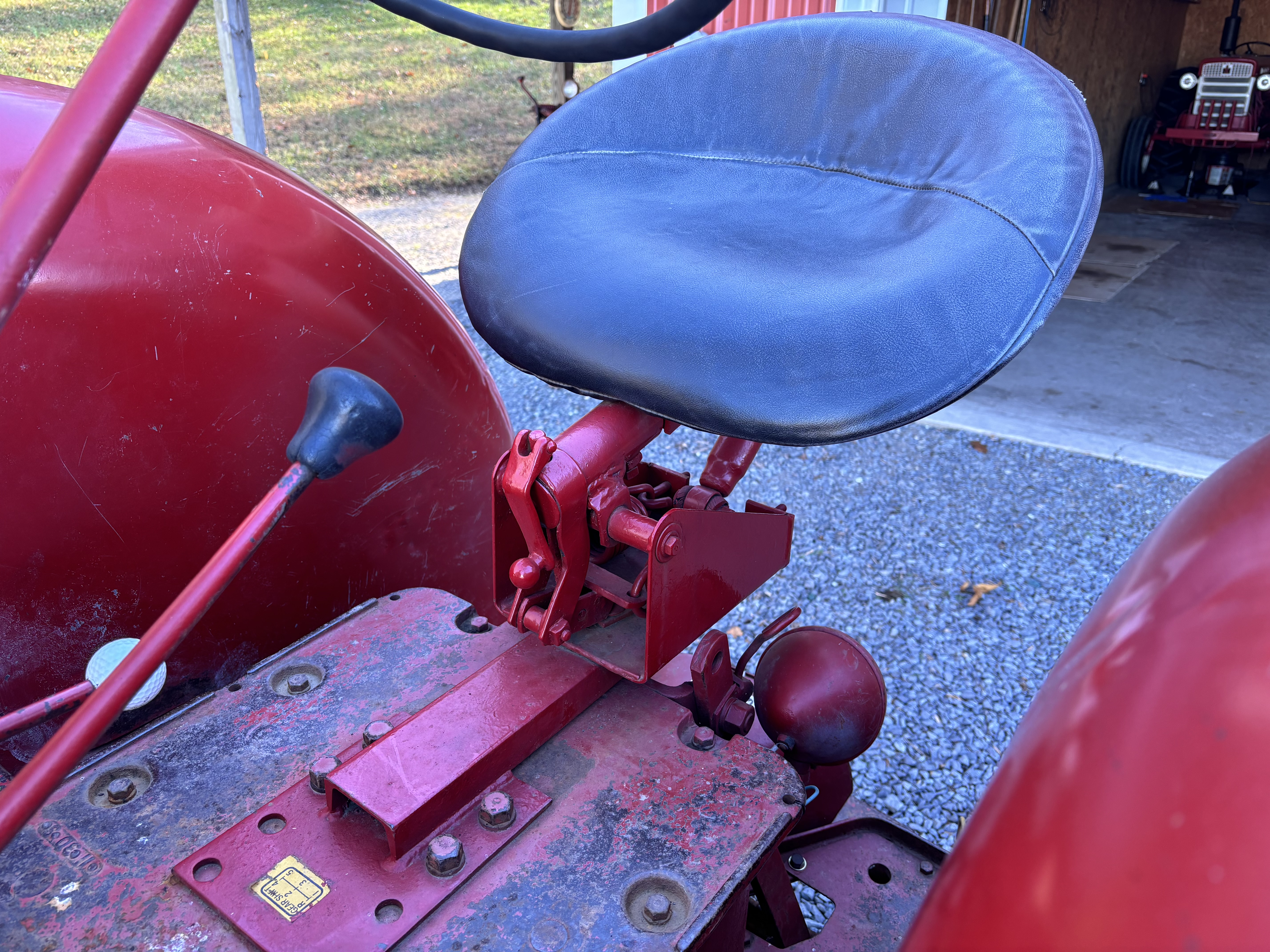

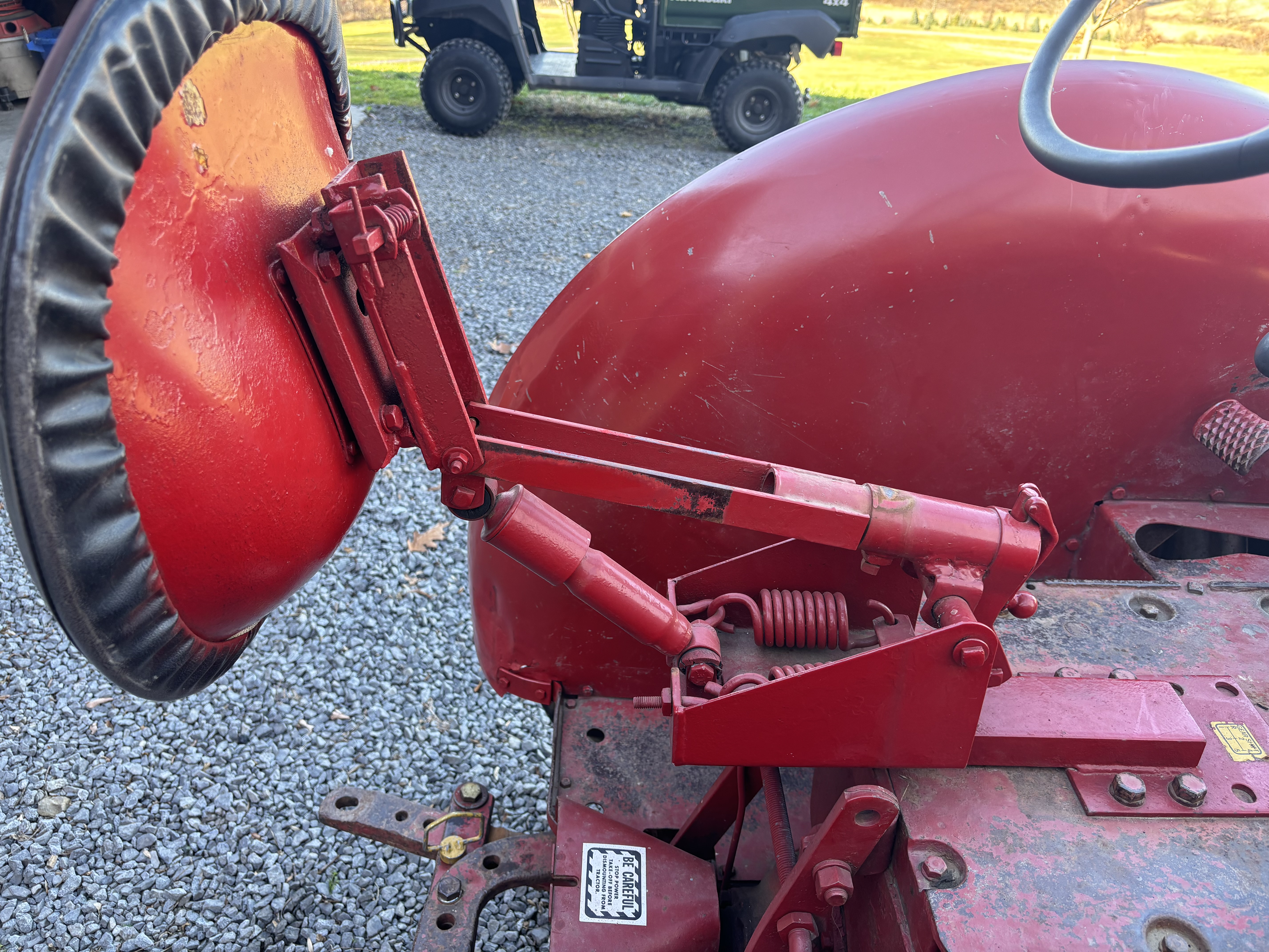

I was wondering if anyone could identify what this seat base/suspension would have originally came on or if it was some kind of option. All the seat bases I see are usually the pipe style with a vertical spring in front. This is on my W6 I recently acquired. Thanks.

that is not factory, pretty sure its the Monroe seat set up as someone has fitting the original pan seat to it. those came with a square cushion seat and backrest.
It looks like it is a Joy-Rider seat suspension. Thanks for the help! I found a picture of an old advertisement for it while doing a google search. Made by the “Fleischer & Schmid Corporation”. I need to do some repair to the pivot at the shock.
Yep. Joy Rider. I have one in my WD9.
They are nice in they are adjustable for driver weight.
